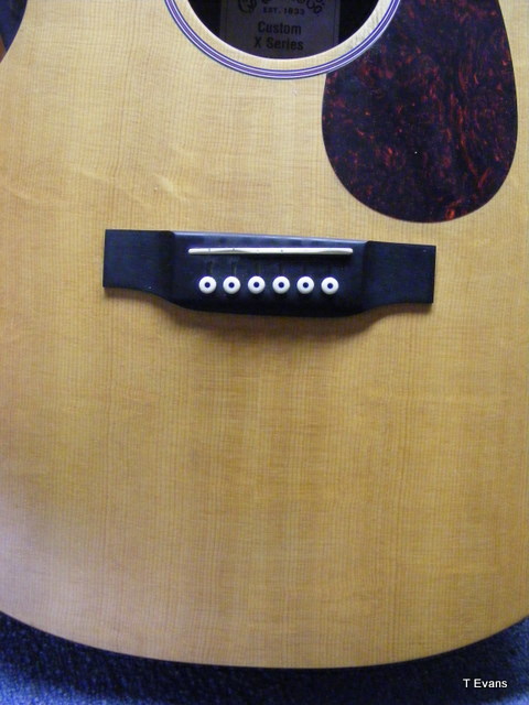

Hi Dave, in the photo I just posted you will see [or not see] an open joint I have just repaired. It went from the start of the tail-block the length of the soundboard and into the soundhole.
I had the guitar laid out for a pre-repair photo but got called away. I left the guitar on the bench but covered with a towel and did not get back to it until the next day. When I uncovered the guitar I found that the humidity in the shop had started to close up the gap, I quickly parted the closed part of the seam and rubbed glue into it. I then placed a damp sponge into the box under the open part of the gap and covered the soundhole, this dampness and the moisture of the glue, I think, closed up the rest of the seam. Before the glue set I made sure that both sides of the join was level.
I then glued small cleats inside the guitar spaced out along the joint.

Hey, rather than do the fix after it has cracked, its better to prevent it in the first place. In the Kent Everett DVD he advises you to glue 2 small diamond top off-cuts onto the unsupported area of the seam behind the tail block and one between the two tone bars. If your design is different to this you just want to add small 12mmsq patchs where ever there is a large unsupported space on the seam. These get carved right down at their edges and Kent warns that they can effect the sound so tapper them off and make then as thin as possible. A little bit of insurance. This is the spot that seems to get bashed on the edge of the coffee table the most.
Good luck with the repair.

Yes dead right Dom, the picture shown is of a Martin guitar, I do the little patches on my guitars.
