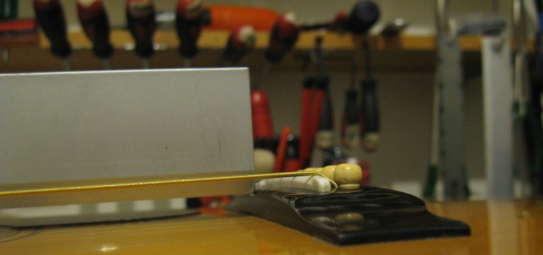

Can you take a picture of the neck with the ruler on it.

If the neck has up-bow and youre laying a straight edge along it then be careful youre actually getting an accurate picture of the neck rake.

Picture.
- here.jpg (43.97 KiB) Viewed 24631 times

Sorry to be a pain but can we get a look at that straight edge sitting along the neck.

I can take another pic but the straight edge is running in a straight line in the middle of the fretboard to the bridge

From my interpretation of the photo, your straightedge strikes the bridge about 1 mm low -- which is not so bad, given the usual ups and downs of guitars, and certainly not itself indicative of a major issue.
