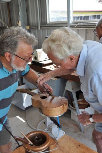

Alan checking the profile on the end of the fret board.

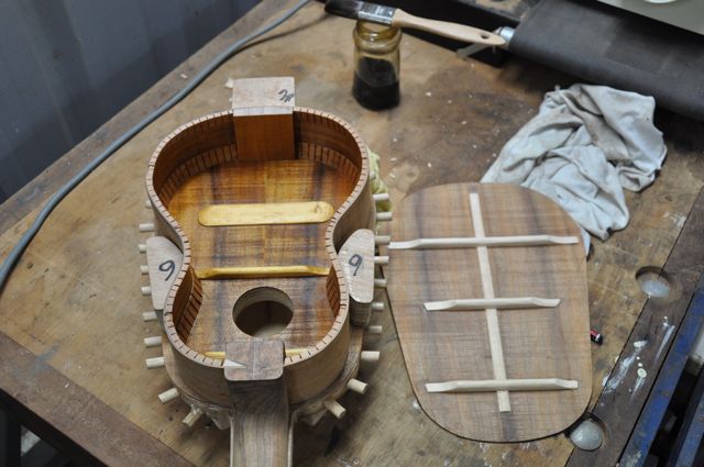

Interior shellaced

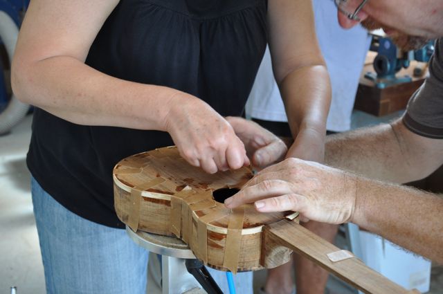

More time in the workshop today, and got some glue slathered on and attached bindings on some ukes.

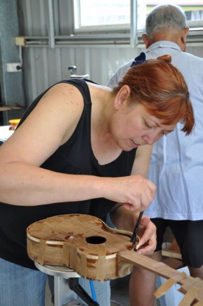

Fae getting stuck in. Using HHG to install the bindings.
I'm helping push them into place while Fae is applying the binding tape.

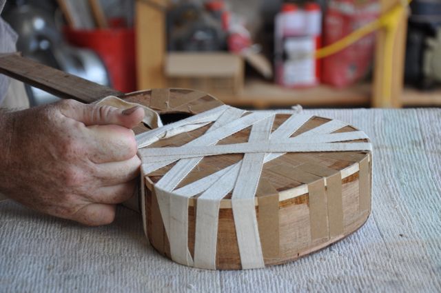

Wrapping with twill tape to synch everything up nice and tight.

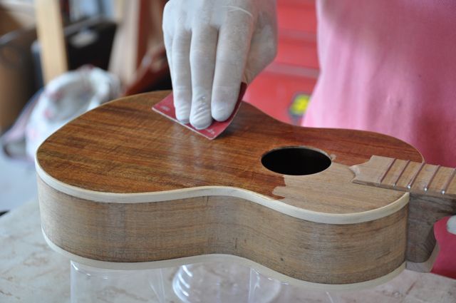

Fae's got the first session of epoxy pore filling,
She was pretty excited when the epoxy started to show off that lovely figure.
