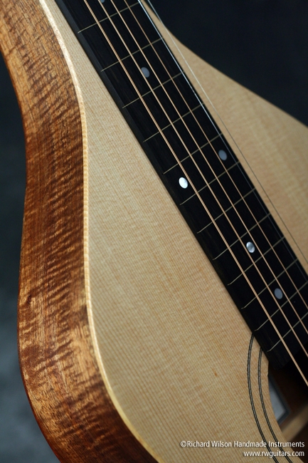

You have a lot of options with the fretboard on Weissenborns because wear and tear (or even strength to an extent) aren't critical factors like on traditional guitars. Any stable hardwood should do the job; it's common to use the same wood as the top/back/sides as on original Weissenborns, but with a bunya or spruce top I'd say a darker contrasting wood might be idea for the fretboard, and in this case it's probably best to match it with the bridge.
At the moment I'm really liking the neat, modern look of spruce/blackwood with ebony fretboard/bridge on Weissenborns:
