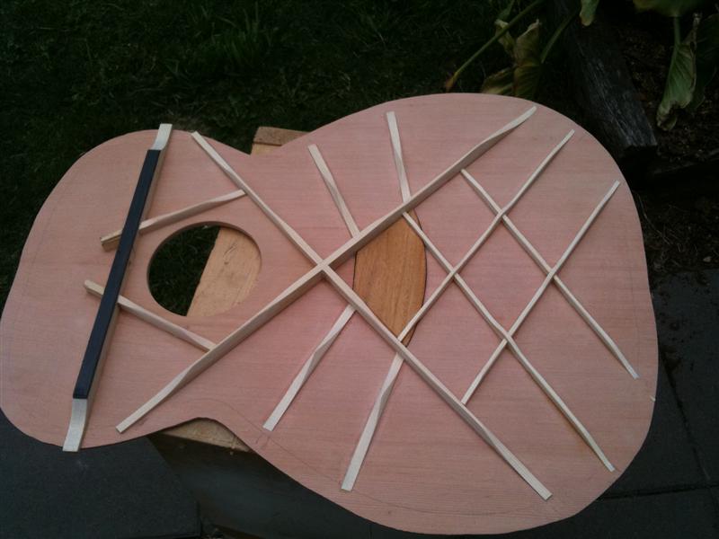

This is an OM that's going to end up gracing the office wall of Britton Brothers sawmill in Tasmania.
So bearing in mind that this is going to be as much a work of art as a musical instrument I allowed myself a bit of latitude in bracing the top and pulled together a whole lot of ideas that I have seen or thought would be useful.

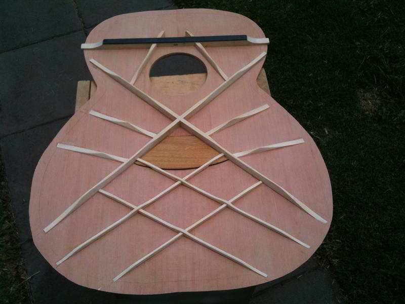

The lower bout bracing is straight from some pics of Ervin Somogyi's guitars but I felt that it'd suit the King Wiliam Pine given it's usual lack of stifness along the grain. I also like the idea of not leaving great swathes of the lower bout unsupported. This sort of bracing allows more control over the ultimate stiffness of the top, both along and across the grain compared with the Martin style diagonal tone bars that I usually use.

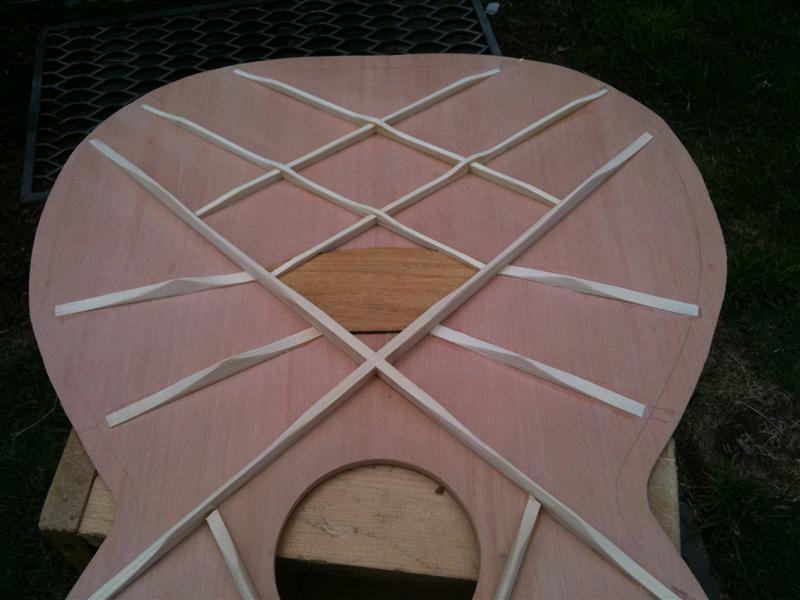

The lattice work is surprisingly strong after glueing it all together. The lattice brace diminsions are 5mm x 3mm.
Bridge plate is a laminate of Osage Orange and Brazilian Rosewood and is much wider than I usually build. This again is to compensate for the lack of stifness in the KB top and to resist too much bridge rotation.
Working with the bridge plate is aother layer of King Billy around the sound hole to stiffen it up so that it won't dip. (you can't really see it from the pics)
The upper transverse brace is capped with 2mm Carbon Fibre courtesy of Mr Hickey.
The X-brace is slightly scalloped in the Martin Tradition.
The finger braces are angled slightly more across the grain than I usually do to add some stiffness.
I don't think KB is suitable for anything bigger than an OM but I've had some success with it on parlour guitars.
The X-brace fairly standard 6mm x 12mm.
I thought I'd throw these pics up to spark a bit of discussion about bracing and why you do certain things to achieve your objectives

Very cool Bob, I am lik'in that configuration and feel the whole top looks well balanced in it's lay out.

Very nice Bob...I get an arachnid kind of feeling from the photos, perhaps you could call it spider bracing!
I haven't seen Ervins books yet but I imagine there are lots of things that many of us wouldn't have tried before and maybe some stuff we wouldn't have seen either.
The CF over the Upper brace looks like a good idea. One to file away for next build.

Cool build Bob. I'm liking the look of the Lattice, looks like it will definitely stiffen up the lower bout without stopping the resonance due to it's mass I'm guessing. Didn't realise King Billy was weak across the grain. Tim packed my auction winning Bunya between two bits of KB so will have to have a closer fondle of that to see what you talk of. Wink
Nice tidy work as always too.

Hey Bob;
Your wood looks a lot like the coastal redwood here in CA. tight grain, light, but weaker than spruce. I've only built 3 guitars out of redwood, my 2nd, 3rd, and one of the L1's I posted here a while back. If your King Billy is like I think it is, I think you're spot on. Thicker top with lots of light weight braces seems the way to go. You can always mess with the top thickness after its built if you need to loosen it up. Osage is from over here in the states, back east around the Appalachian Mts I believe. Heard good things about it for instruments and always keep an eye out for some. Bummer the guitar is to hang on the wall. Bet it'll be a good instrument.

It's a really interesting design Bob.
How does it tap tone sound now that you've got it shaped? Is it what you hoped and expected?
I imaging all those brace ends in the lower bout are going to end just shy of the linings?
What did you use to glue the CF on to the Upper Transverse Brace?

lookin' good bob.
couple of questions though. (you knew they were coming Laughing )
how does the stiffness of the latticed area relate to a traditionally braced soundboard.
also, what are your thoughts on cross grain gluing vs. with grain gluing of the soundhole patch. I would have thought that cross grain gluing would give a stronger result with greater resistance to the downward force of the fingerboard extension.

Nick - all of the King Billy I've cut hasn't been too stiff cross grain. I don't worry too much about cross grain floppiness - you can build stiffness into it.
I think a lot of the problem with KB is that most of it is cut from boards - not split from a round of the tree, so most of what we see suffers from runout.
John - it's not as brittle as redwood and doesn't quit have the same sustain.
This top was sounding quite good (ie quite good sustain) until I glued the upper transverse and the soundhole patch in. That dampened it down a bit.
I don't think tap tone gives you the full story though. I'll reserve judgement 'til the strings go on.
I am going to glue the top on first and do some more playing with it before I commit to the bracing.
Allen - it taps like the other KB guitars I've built. At present it sustains for about 2 seconds all over the lower bout. I'd just like to tweak it to get it a bit longer. I was concerned about this one because of the larger size but I think it'll be OK when the strings go on.
The CF was glued with Araldite and yes there won't be any tucking of braces south of the soundhole.
Liam - I think there's about the same mass and weight in braces on the lower bout but I feel that the lattice is stiffer and allows you to distribute that more evenly over the lower bout.
With the soundhole patch the cross grain will be stronger but in this case I don't think it matters too much as I've got the two "A" braces that I don't normally use as well as the patch, so it'll be a lot stronger than what I have been doing. Bearing that in mind I cut the patch with the same grain orientation as the top.

Beautifully engineered; the soundboard in itself could hang on a wall as a work of art. Which species did you cut the braces from?

Great design Bob and well thought out. It's got a lot going for it with the A Frame and C.F. capping on the transverse. Nice work on the lattice bracing too . What dimensions are the A Braces and transverse ?

John - the braces are Red Spruce but the lattice was cut from Engelmann.
Craig - the UTB ended up 12mm square. The A braces are 6mm x 12mm.

WOW Bob that is one beautiful job of bracing a top.
I agree too that there is a balance or symmetry that just looks like the guitar will sound killer.
Keep us posted on how she sounds - I suspect that you may not wanna give this one up.

G'day Bob,
Interesting design there and lovely crisp work.
I've got a couple of king billy tops unused as yet so will follow the outcome of this experiment with interest and kudos for doing the experiment in the first place when it can be more secure to do what we already know.
One question - the lattice work. The joins appear to my eyes to have three one way, one another - hopefully you follow what I mean. As in - each individual component of the lattice is not over/under in the joinery - with one brace being under/under, another over/over, the final two under/over. Any reason for this or just the way you happened to cut them? Would it make any difference in this design or possibly larger lattice work such as Smallmans design, to cut the joins over under at each point all the way through? Added strength or stability or distribution of stresses? Your thoughts?

Another question Bob. Did you press the lattice in, or has it had a radius put on the bottom prior to glueing it to the top?

I wondered whether anyone would notice that Jeremy Very Happy
That was just the way It happenned.
Because of it's symmetrical design I don't think it would r eally matter which way you cut the lap joints.
Allen - the only brace that I radius thes days is the X brace. I put a a small amount of radius on the upper transverse as well (opnly about 40mm on each end)

I recall reading in one of Graham MacDonald's books, or maybe an article that he did, that he found that the lattice could be lapped, or just butt jointed. He didn't notice any difference in the way it worked.
Are you talking about 40 mm scallops on the end of the upper transverse brace Bob? I was noticing in Ervin's book that at least in one image he doesn't even do that, rather uses them full height and even puts braces at the ends where they are attached to the rims.

Re: Bracing on a King Billy Top
I'd say they were closer to 30mm Allen.
The UTB beam would work better if it didn't have the scallops in the end for sure. I'm just not sure if it'd be overkill.
Very nice, Bob.
We do that carbon fiber cap on the upper transverse braces on our Compass Rose Ukes, too, and it's great for keeping the upper bout top under control.
Beautiful craftsmanship, too...
This is the lattice work as described in Graham's book - unless I did it wrong Confused
