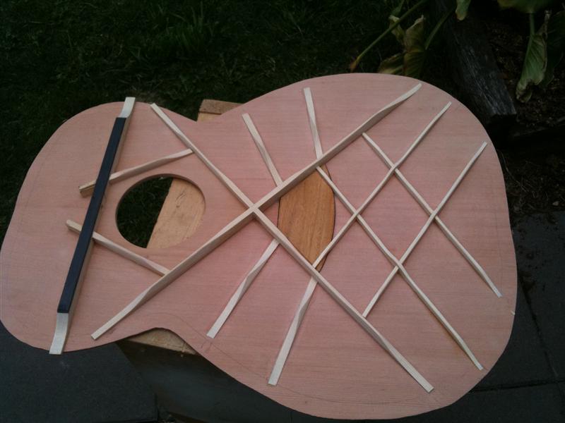

Here's what I've done on the latest Hesh.
The CF is glue with Araldite, which is a common garden variety epoxy available in Australia.
I want to stiffen up this area but I don't want to totally deaden it, thus the scallops at the ends of the UTB. Using the A frame braces and the patch around the soundhole is going to make this fairly solid in this area anyway.
