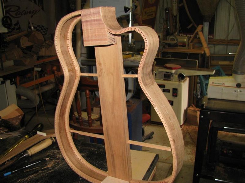

I've been threatening to build this for a while now.
An acoustic/electric for playing onstage. No soundhole, bolt on electric style neck.
Fairly hefty soundboard (3.5mm) Engelmann Spruce and two pickup systems.
K & K pure Mini Western plus an EMG UST pickup both wired to a stereo plug. i'm going to run the two signals into a Dtar Solstice pre-amp and from there to two channels in a desk or Acoustic amp.
Finished the neck today as well so I'm waiting on the pickups to arrive to install before I glue the top on.
Not going to bother with bindings or anything fancy on this. I'm more interested to see what it'll sound like (so it'll get trashed if it sounds like crap) :D

The K&K's sound very much like a microphone Nick , so they are great for acoustic work but they don't cut through a band that well.
So the UST is to give it some ability to cut through the bass player and drummer.
I think the EMG under saddle pickup has the fattest top end of any UST I've tried. Turn it up and it just keeps getting fatter. In contrast the Takamine that I currently use on stage is quite thin and brittle in the top end. If you turn it up too much it just gets harsh.
I've got a K&K Powermix system in my 12 string (Pure minis + UST & pre-amp) and it's great for that. It's just not the sound I'm after for the 6 string
Yeah I've been using up any old bits of wood to build this one. Bits of kerfed linings, Coco fingerboard with cracks that sort of thing. There's actually a big sap pocket in that Blackwood. :D

Hell of a hefty back on that one Bob. Never seen the insides on something like this. I'm guessing that helps with feedback issues when you play it loud?

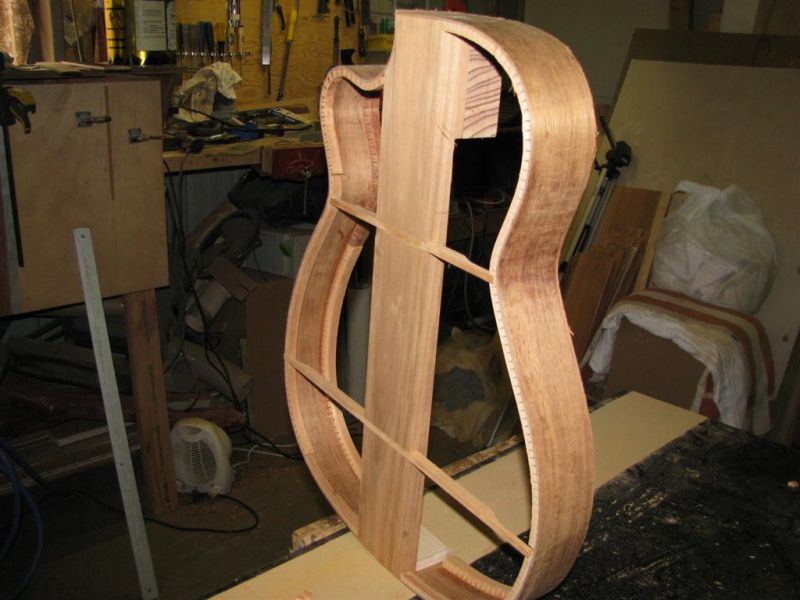

Allen - that big lump of blackwood down the centre is to take the back out of play as much as I can. The back itself is standard acoustic guitar thickness (.090")
Which leaves the top as the main influence on the sound.
This is very similar to what Rick Turner does in his Renaissance instruments and is where i got the inspiration to try something like this.
The top on this is dead flat as well - no radius.

I can't wait to see the back and check just what sort of joint is under that back graft.
