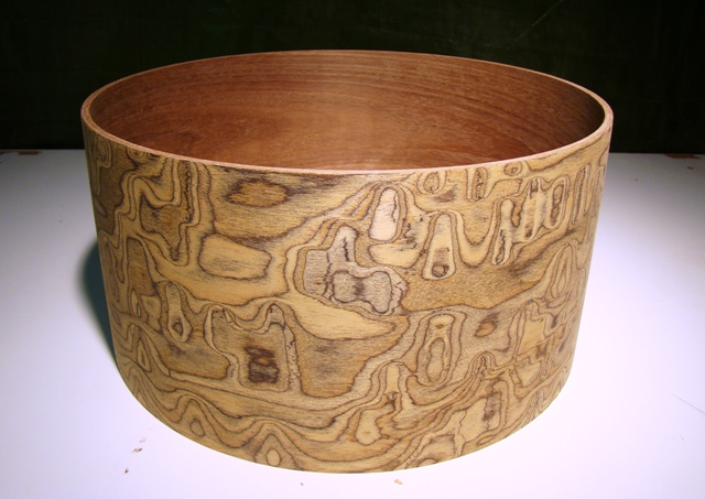

Hey Guys,
I am new to this forum. I had a login in just prior to the crash but didn't really post. I was referred here in regard to a vacuum pump and after looking around and seeing what you guys do I am quite impressed. Now I am not a guitar builder, I am a circles man. I build ply snare drums mainly with aussie hardwoods. I have attached a picture of one of my recent shells which went over to Canada. It is a spotted gum shell with a new age reconstructed veneer on the outer ply.
I have been experimenting with Nitro lacquer (Excelac from Sherwood Paints in Melbourne). I am trying to achieve the open grain satin finish which is on most Maton and Coal Clark guitars.
I have been sanding the shells to 240 grit shooting 3 coats of lacquer and sanding lightly with 400 grit in between coats and wet sanding to 800 grit after the finish has been cured though I am not getting the finish which I desire.
Currently I am not thinning the lacquer and I am not using a sealer. One of the tech support staff at Sherwood Paints said thinner was not needed and to use the excelac as it's own sealer.
So at the moment I have been searching and searching on how to get the nice natural open grain satin lacquered finish but I am not finiding and useful information. I was hoping if any of you guys with experience with this type of finish could chime in and point me in the right direction? I haven't had the most experience with lacquers so any tips from prep through to final sanding would be greatly appreciated.

Steve,, nice looking shell there , how does it sound
I've made a few sticks of furniture in the past, posted a pic on here but prob lost in the crash, any how i used to get a similar finish you are describing. Using a few coats of clear polyurethane, fine sand between, after the last coat, fine sand about 240 and then aply some teak oil using a pad of steel wool rub off excess with soft cloth. What you are left with would be described as an open grain smooth satin finish. Of course it does depend on the species of timber as to how open the grain is. Hope this is of some help.

Thanks Rod, The shells actually produce a nice tone when you give them a light thump while suspended on your finger. I have been pleased with the finished products, spotted gum has a very unique sound.rocket wrote:Steve,, nice looking shell there , how does it sound![]()

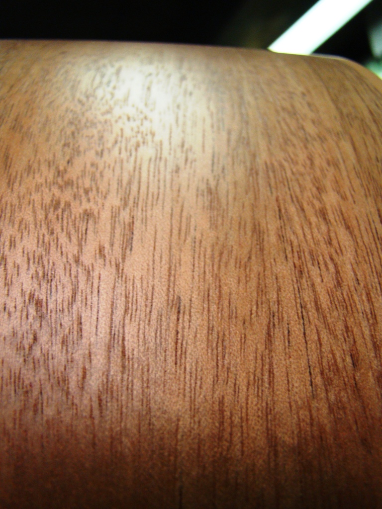

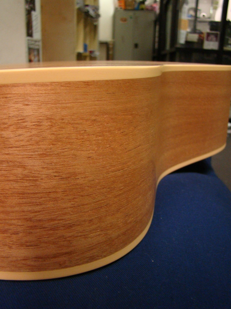

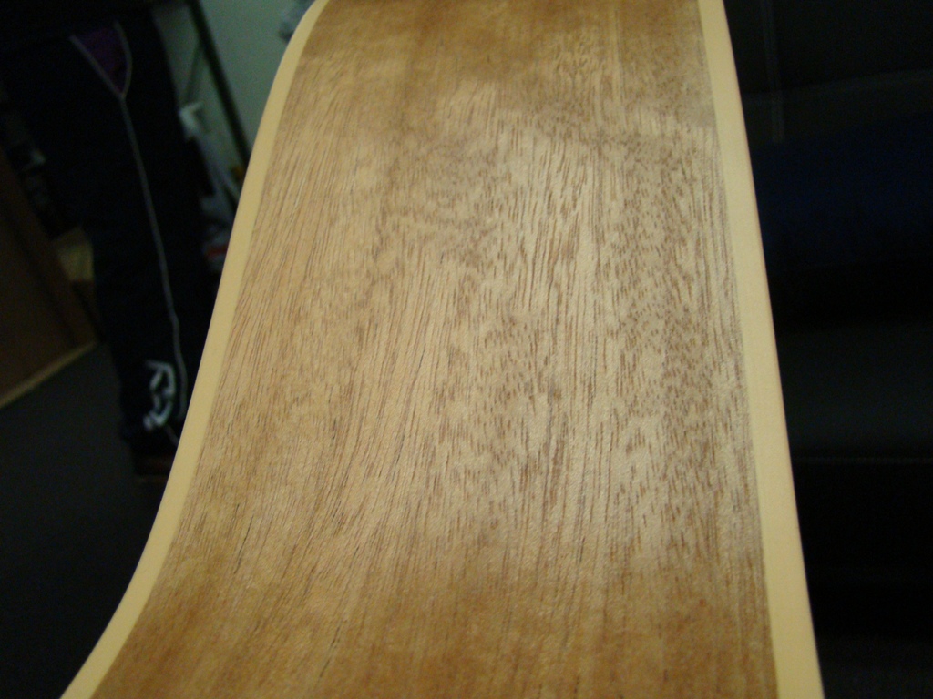

I managed to get a few pics of the ideal finish I am after. Hopefully this makes everything a little clearer.
Thanks for everyones input so far.
P.S. this finish will not be used on shell originally posted. That shell had a reconstructed veneer on it and I want to use this finish on natural veneers.
Thanks

Re: Open Grain Satin Lacqured Finish?
Getting that look is a piece of piss. Getting the flat, level gloss without the pores showing is where everyone struggles.
I only every spray gloss, but you'd be looking at cutting the lacquer very thin. Do not do anything that will fill the pores.
What you are seeing in the instruments that you describe is the quickest, easiest way to get a finish on. Those instruments are made to a price point and no time or product is wasted in achieving that finish. Keep that in mind when you are going about trying to recreate it.
In short, if there is a way to extend the finish with something cheap like thinners, then it's done. If there is some way to not have to waste time and product filling pores, then that is also on the table. What you end up with is a finish that just coats the surface without any pretence on being anything other than a bit of protection to bare wood.
