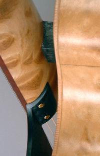

I believe Ken Parker is building his archtops with minimal contact at the neck joint also......
Here we go: Hope he doesn't mind me reproducing an image from his website. It infact looks like a block of brass or anodised aluminium between the neck and neck block
Although I must admit the MP3's do sound a little 'thin & Banjoey'

Yeah, Ken has taken minimalism to another level there. BTW, that's a veneered neck...the core is carbon fiber. And, no, you really can't compare that guitar design with anything based just on the neck joint! As I recall, the article in the New Yorker suggested that the music for Ken's new guitar hasn't been written yet. He needs this generation's Django, Eddie Lang, or Charlie Christian.

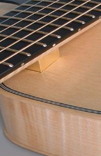

Re: Bolt-on Acoustic Guitar Neck vs Dovetailed Neck?
That "brass" block is, I believe, gold leaf over carbon fiber.
Good lord!

Perhaps it's just me but, does anyone else question the strength in that small strip left on the side of Ken Parkers archtop? Inherent weak point?
I mean I realize it appears to be a remnant of the side itself, and is laminated with solid linings, very probably with carbon fiber in the mix - but it just seems that a good knock to it would potentially damage it, or the sides it is attached to? Perhaps I am underestimating the strength of the laminate... It just seems a little avant-garde for the sake of it rather than for any particular benefit. But I am speaking without experience in either trying it personally or having seen one in person so accept I may be very much misguided.
Oh and Nick, you can see the carbon block left 'au natural' in other shots on his site.

These are guitars taken to an extreme in build. Ken is fascinated by high performance racing sailboats, and I think it shows in his designs. These are not guitars for bar fights, though! Especially at 30 K USD a pop...
