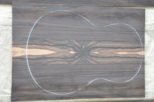

I'm posting this so that Micheal, who has commissioned this instrument can follow along with the build progress, as well as the rest of you if your interested.
I was contacted a few months back about building a tenor ukulele to the owners specifications, and after my moving house, and 2 uke courses behind me, I've finally got some time to get to this one.
After some deliberation about wood choices, Zircote was settled upon, with a Bearclaw Sitka top. Micheal wanted a wood rosette, and I had a piece of spalted Avocado on the shelf that has a very similar color palette to the Zircote, so that was installed and levelled a couple days ago.
The neck is mahogany but still has the clamps on the laminations at the moment.
Anyway, here are the components that I've prepped so far, and hopefully I'll be able to get some more happening to this by Sunday.

thats some beautiful wood there Allen,look forward to seeing it progress
looks like the mother of all spiders landed on the Ziricote back in the first photo hahaha.

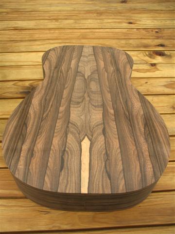

Well then, as mentioned, here it is. The back as it is at present -

I just love the look of the stuff. I am using a spruce top on this model too. Possibly a silver ash neck though I have options and therefore have not committed 100% yet. I hope to continue on it soon though it is not the highest priority as it is not a commission. I'll see how I go.
Good luck with yours Allen. I'll be watching with interest.

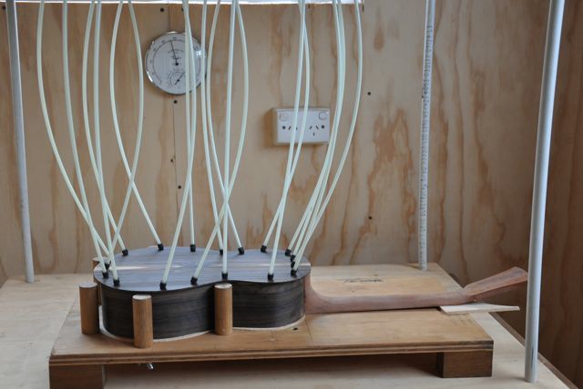

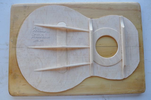

A bit more progress made this weekend along with all the other stuff going on in the shed, and around the house.
Top is all braced and pretty much ready as well as the braces are on the back, but the pictures were pretty ordinary, so won't bother posting them. Neck is well on it's way to being ready, and as it's a Spanish Heel build, it's got to be at least mostly done at the heel end before the body gets assembled, it's the next order of business.
Vacuum bagged the braces on. The upper bout is flat and the lower bout has a radius scooped out in the board. Don't ask me how much because it was all done by eye and feel. It's the same as I use for the lattice braced instruments, and If I had to guess it starts out at 15' but relaxes some after it's out of the press.

Maybe I have not been paying enough attention to ukes, but is that top bracing, with the peaked fan braces bridging/arching over the bridge plate a new soundboard bracing scheme? I can't remember seeing that before.

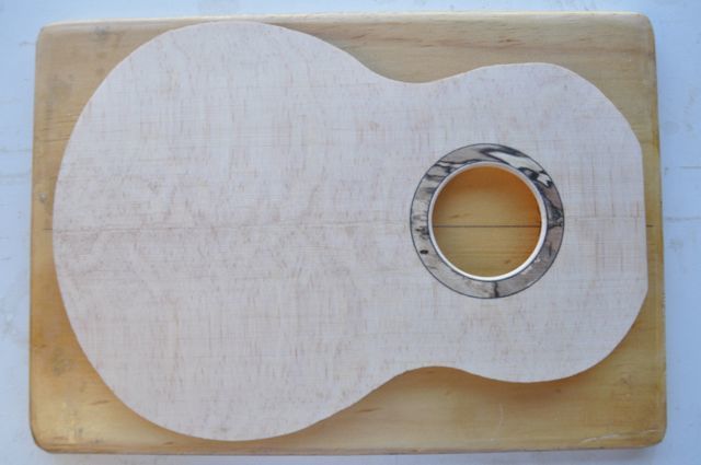

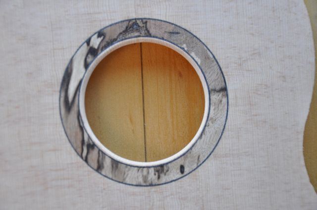

Love the avocado rosette. I think it really compliments the Ziricote. Michael is going to be a very happy camper.

You know me Dennis, not content to do the same old thing.Dennis Leahy wrote:
Allen,
Actually, I've been looking at a lot of bracing patterns for nylon strung guitars and reading some discussions about them, and have seen this done on at least some of the braces in a set of 5 or 7 on many instruments. As the top on this uke is very stiff I decided that this would be the place to try it out.
Perhaps the engineers in the crowd will be able to comment if a brace that is built like this has less stiffness than if it was shaped and glued directly to the soundboard.
_________________
Re: Michael's Zircote Tenor
Allen, that will be plenty stiff at the bridge location.
Because the top plate forms one flange of the beam the total height is still what matters rather than the height of brace over the bridgeplate (within reason)
I have never really understood why some builders want to keep the fan separate to the bridge plate, there would be some detriment to strength and stiffeness in the area from this but probably not significant
Whether it is actually too stiff is up to what you want to achieve here

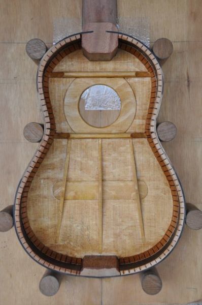

Got a bit of a chance to do some more work on this one today.It's amazing how fast they go together once you have the components made.
Got neck shaped and the sides installed and linnings glued in.

Interior shot with a few coats of Garnet shellac brushed on, then a light rub with a pad.
The same done with the back and it was glued on last night.
You can see the shim I place under the nut area of the neck to give me the proper set I want to accommodate the dome I've built in the top.
