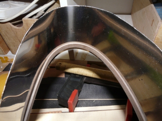

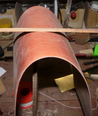

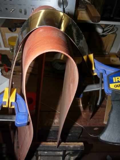

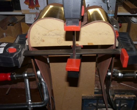

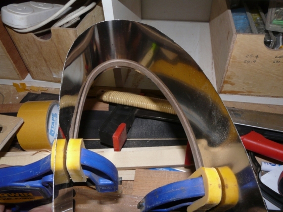

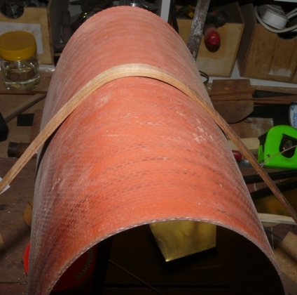

I had a go with material from the same batch that I sent Andrew and had success. I did however use a thermal blanket over a former and had 135 celcius as my target. I also use a backing steel strap when I bent the Pacific Blackwood. Tas Blackwood bent okay but could have been done with the steel strap as well. I think there would have been a failure if I had made a tighter radius
regards

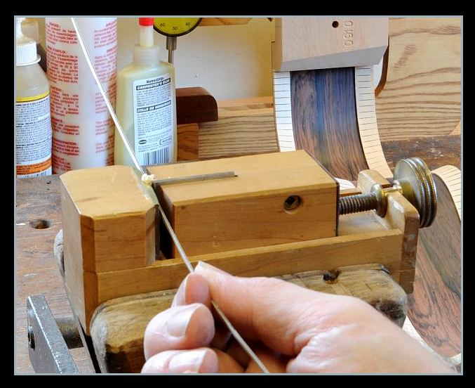

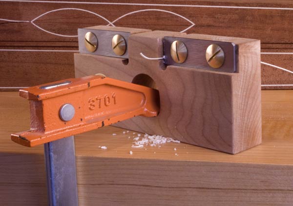

Post by Lillian » Mon Nov 08, 2010 4:15 pm

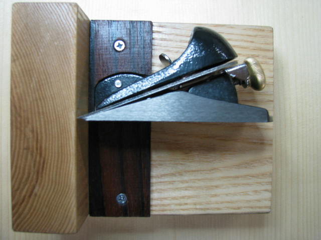

Andy, you can whip up a thicknesser that doesn't need to be plugged in.
This is Lie Nielsen's Veneer Thicknessing Gauge. Straight up simple.
Lie Nielsen Veneer Thicknessing Gauge.jpg (32.58 KiB) Viewed 16541 times
This is someone's take on it.
This is another version. If I remember correctly, it came about after Chris dropped a block plane and broke the toe.
sizer 3.jpg (36.45 KiB) Viewed 16541 times
Thanks for showing those photos Tim. It had never occurred to me to use the thermal blanket in that way. I have only used on the side mould. Presumably you have a pipe or something under that blanket to pull things over. You probably have it hooked up to a thermostat as well. I don't have one of them yet so it so it would be a bit more difficult to regulate the temp.
Frank

G'day Frank , Just keep in mind that the blanket will need an appropriate heat sink the size of the blanket to avoid the blanket developing hot spots ,,,or worse

TimS
ANZLF Approved Supplier
Posts: 210
Re: bindings for soprano
Post by TimS » Mon Nov 08, 2010 4:20 pm
Good point Craig. I thought I would be able to avoid hot spots with the controller unit which monitors the temperature through a thermocouple in the blanket.
