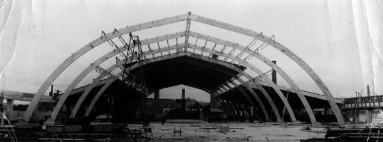

Yep DF is known as Oregon Pine here in AU as well. Shiploads of the stuff bought into Australia before Glulam tech came into play. Nearly every old warehouse/factory or any other building in AU that required a large span, weight bearing structural beam that was built pre-war and up until around 1958 when Ralph Symonds introduced box ply beams will have Oregon pine right through the roof.
Symonds' factory built 1958
Douglas Fir/Oregan Pine is relatively light, incredibly strong and was available in cross sections and lengths that no native tree with a similar strength to weight ratio could produce. I had seen some 'huge' beams of clear and better doug fir craned from the roof tops of the many buildings I worked on that were demolished in Fremantle just prior to 1987 to make way for redevelopment of that great little city in readiness to host the Americas Cup yacht race.
For a long time large span buildings with wood/oregon bearers were cheaper to insure against fire than similar buildings with steel bearers. Sounds bizarre but its true. The reason was/is that these large beams take a long time to burn through and could easily be replaced if the fire was bought under control. By contrast, steel beams quickly expand with the effects of heat and then sag under their own weight. Often as they cool, because their span is effectively shorter because of the sag, they will pull their supportive walls inward as they contract which will collapse the whole building. So don't brace your guitar with steel and set it on fire of you will be real sorry.
