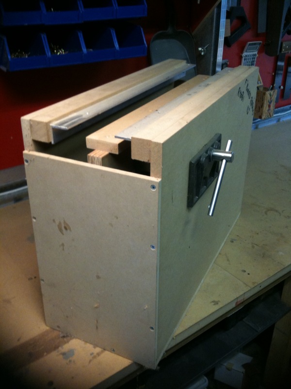

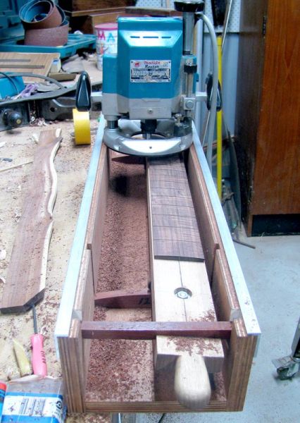

I came up with a slightly different take on the router sled.
The upright piece of ply that you can see in the middle of the box is the same length as the radius and is hinged at the bottom. A fingerboard blank is stuck on with double sided tape. The turn screw system is from a cheapy vise that i picked up for about 10 bucks. I find this a very accurate system as the blank holder works as a large compass.
Some advise if you are trying to use a plane on a fingerboard with fret slots - First use a square edged file on an angle to chamfer the top edges of the slots slightly.- Use a longer plane.
Good luck, Pete.
Good luck, Pete.

OK, lots of ideas there. Thanks. I've just finished doing a board by hand with a radius block and lots of (cheap) sandpaper and elbow grease. Got a fair result but it is the last time that I will do it that way! I will be building a sled for the next one. cheers gents.

When using the luthier cool tools jig I pre slot the board and it is tapered after the radius has been cut. I have not experienced any tear out whatsoever as the cutter used in this jig is a CMT bowl/tray cutting bit which, because of it's curvature, offers gradual increments of entry into the cut. With this in mind the word "aggressive" does not describe the process very accurately.

Good point about the cutter Kim. I had made a similar set up to yours a few years ago now, but used a flat bottom cutter. Got hellish chipout on the edges of some wood.

I laugh at it now because it's just so big and rediculous, even though it does the job well. I slot, taper and bind fb first. There are a couple of other potential ideas/approach in the OLF post as well.
One thing I found I had to watch was binding - point of entry was fairly crucial. First time I tried it, the router ripped the binding of the side!!!
I like Kim's sled approach as it offers the accuracy and has about 10% of the storage space requirement.

Kim, couple of questions for you sir, if I may.
How hard/difficult/time consuming/expensive was it to build the jig?
Was it worth the time/money/energy you put into it for you? Would you build another one if something happened to this one?
Re: Best way to radius the fingerboard?
Hi Lil,
Yeah I would take the time to build another if this one were somehow destroyed, its a pretty useful jig.
It is not overly difficult to build but like all jigs, you do need to take your time and get it right as any mistakes you make will be reflected in the output making the whole concept of repeatability pointless.
The jig has a relatively small footprint and can be hung up out of the way. This point gives some indication of the amount of ply used, and other than a few of bolts, screws, bearings, washers, springs, wood and aluminum angle there really is nothing else to it.
The jig operates by allowing a carriage, to which the FB is secured by double side tape, to ride upon matching pairs of radius cams. These cams are cut from a printed template and range from 24"down to 12" with singular cams incrementing down to 7.5".
It is maintained that the jig can accurately cut a "compound" radius. That is to say that by placing a 22" cam at one end of the carriage and a 9" cam at the other you can achieve a compound. This simply cannot work as the rigidity of the carriage board to which the fret board has been secured, demands that the bearing follow one radii or the other, it simply cannot follow both without the carriage twisting and if the material the carriage was made from were supple enough to allow that to happen, it would hardly be suitable choice as a bed to support the FB whilst it is being cut.
This point aside, the jig is really good for cutting a singular radius and that is what makes it worth while. Using it and may table saw, I can take a bit of stock and have it accurately slotted with a radius cut and finish with a tapered fretboard in no time at all. Best of all, turning out another exactly the same is no challenge at all so for a 'standard' like ebony in a 25.4 scale, you can set up and run as many off as you like, throw them in stock and hang the jig out the way.

Hey Peter, I think that is rather clever, and perhaps easy to redesign for multi-radius by simply putting moveable pivot points at each end of your upright piece, rather than a fixed hinge at the bottom.Peter T wrote:
Personally, I never radius more than 2 fingerboards in a given day, so radius sanding blocks get the job done and give me some exercise. But I'm intrigued with the possibilities to develop Peter's design further.
Thanks for the comments Tim. You are spot on with your suggestion of the movable pivots. My original sketches that I prepared had multiple pivot points with a slot system in the end of the box. I never followed through with this as I decided that I only ever use 1 radius (16") and took the short cut. I actually came up with this idea after seeing the eBay add for the plans for kims jig. Being a cheaparse I decided I didn't want to part with my hard earned and set about solveing the problem my own way. The jig was quicker to build than to hand plane and sand the fretboard on my first build. Next improvement on the wish list would have to be a vacuum system to hold the blank in place. It takes just as long to scrape the double sided tape off as it does to do the routing.
