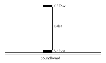

I'm venturing into this hall of experts and have a question. My luthier english is getting much better, but when it comes to physics and advanced notions, I'm left a bit flabbergasted and flummoxed!!
I understand that there are several options when it comes to using CF in bracing a top, among which carbon capped balsa braces and vertically laminated piece of CF in the centre of a brace. If I get things right the laminated option should look like this:
But i don't understand how the "capped" option is organised, could someone post a picture?
Thanks

Here's what I've done on my ukes.
