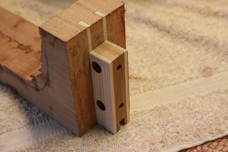

For my current build I bought a 5-piece laminated neck blank with matching neck block for a bolted mortice/tenon attachment. I got it from LMI. It is mahogany/EIR/maple and they have lugs installed in the tenon to accept the neck bolts. The problem is that those lugs can pull out, and that is what happened to this one when I tried to fit the neck. I have used one of these before in an all mahogany neck and it held OK - but I think the hardness of the maple in the centre of this neck meant that the external threads did not bite as well as they should.
I tried to glue it back in with epoxy but that failed too. It is a bad system. The top one seems to be OK and I have left it alone for now (and wicked a bit of CA down along the thread for good measure). For the failed one I have filled the hole with hardwood dowel (would have been better if I put the grain cross-ways).

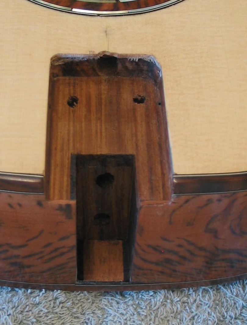

I now intend to install a barrel nut connector. In the photo below you can see the failed system at the top and the new one that I am planning to use (you can get these at Bunning's). The bottom one is an old one salvaged from some Ikea furniture. The Prestige brand one looks good because the bolt has a really broad flat head that will spread the load across the neck block, and the brass coating will look good inside the guitar.
The barrel connector will require me to drill a 10mm hole across the tenon for the barrel, and a 6mm hole into that dowel plug for the bolt. I think the tenon will be strong enough - but I am a bit nervous about it.
Any advice for me about getting this right?

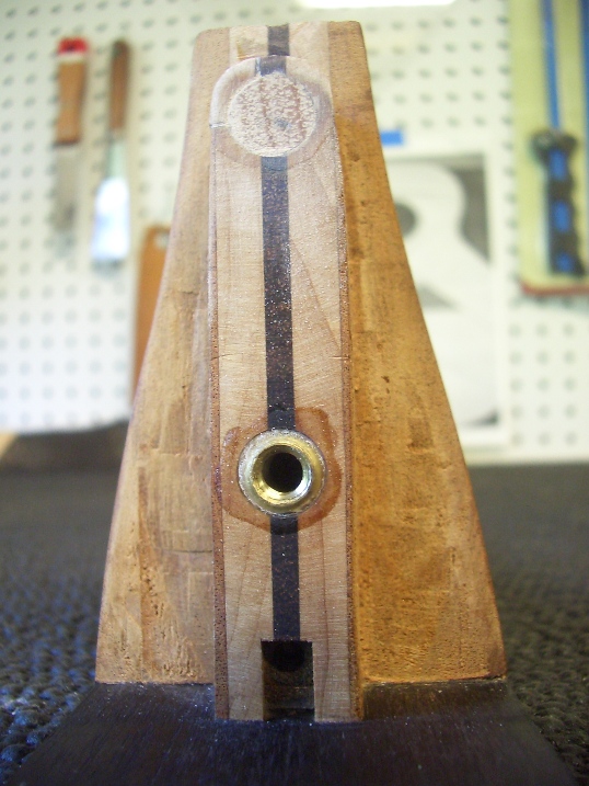

That insert has such minimal teeth, I am not surprised it failed.
I have used the inserts that go with that prestige system and the work fine, but I always instal them with slow cure epoxy, or CA, cause the idea of a fastener screwed into endgrain does not inspire me.
I am surprised the insert came out when epoxied in.
Have you made sure the bolt is not too long so that it bottoms out in the hole and forces out the insert?

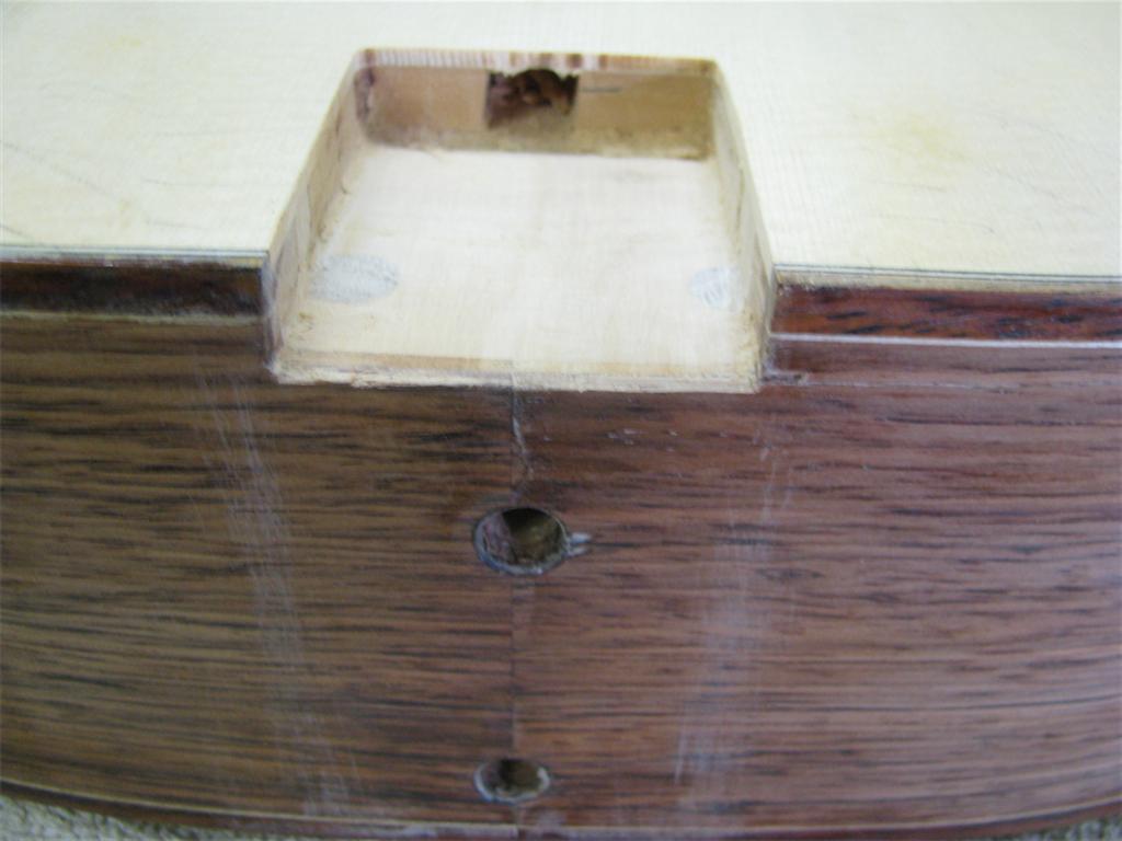

I've had a few that have failed Jeff and they are particularly susceptible to a knock to the neck or if the guitar falls over.
This is why I moved to the stainless bolt system.

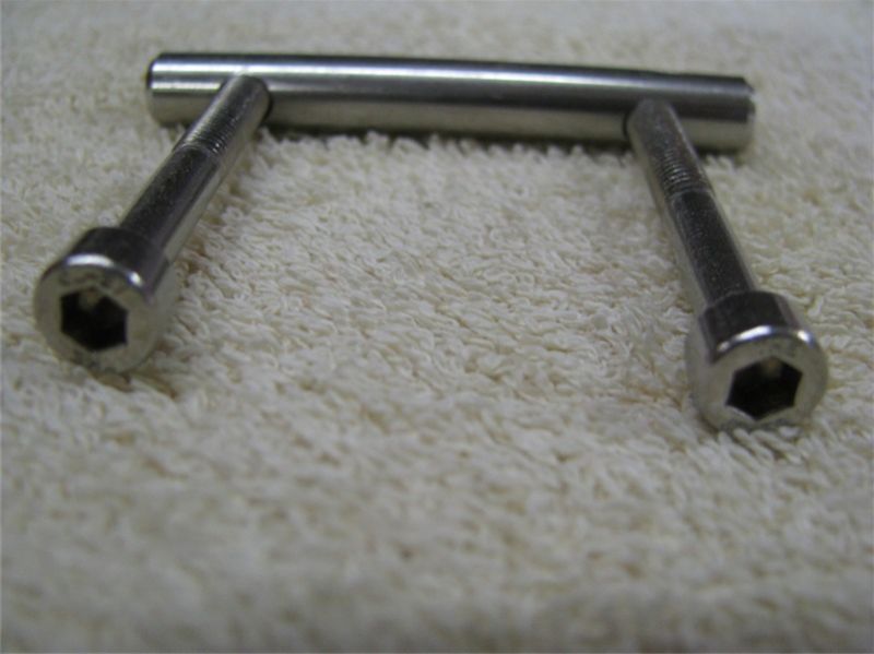

Mark I have a mate who makes the bolts for me out of stainless. Essentialy they are stainless bar which have been drilled and threaded. I buy the bolts from the local bolt specialist shop. You should be able to get your local stainless blokes to knock you some up.

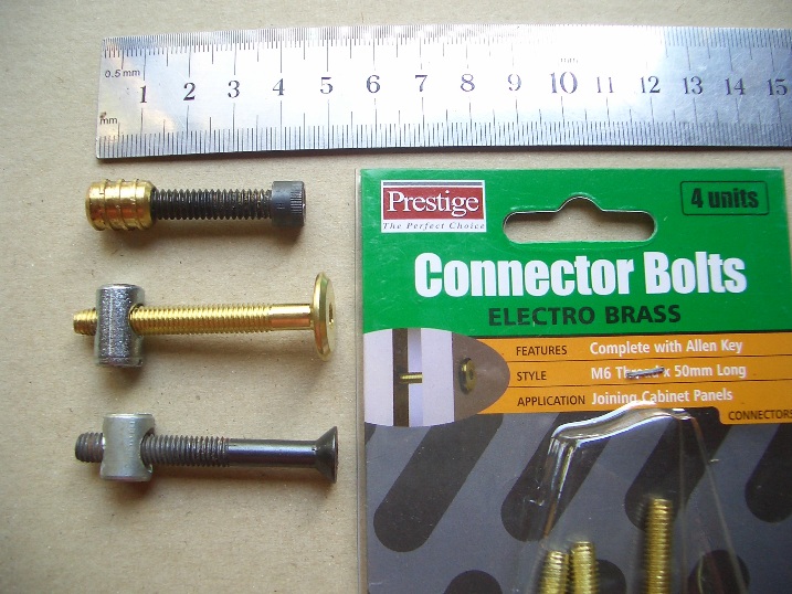

I bought some of the inserts for the prestige bolt as well. They have a much better thread than the ones that came pre-installed from LMI. You are making me think that I might go with that instead, because it will involve drilling less timber out of the tenon. Any opinions about which is better? It is a good thought that I might have stripped that insert because the bolt hit the bottom of the hole. I will double-check the length.

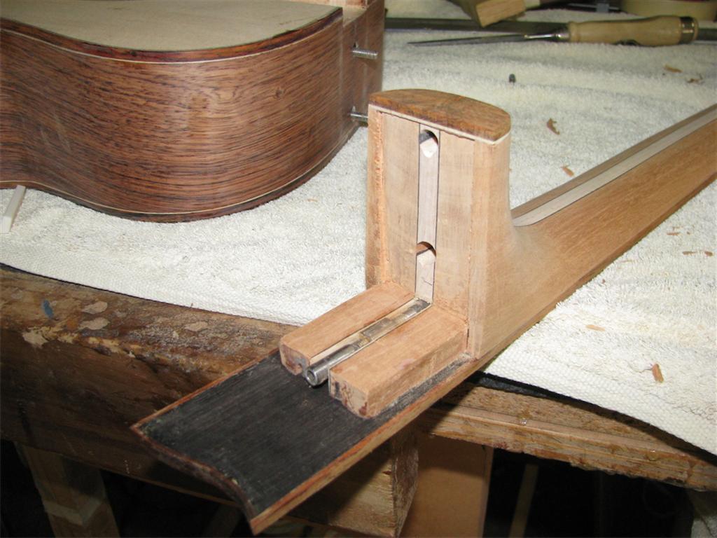

I think I will give your system a try for my next guitar. As I understand it you have a butt joint (no M&T) and the heel needs to be beefy enough to have that bar buried inside. Do you drill that from the top (hidden by the fingerboard) or the bottom (covered with the heelcap). Any other tricks to getting it right? And do you recess the fingerboard extension into the soundboard?

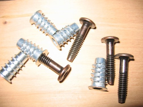

I bought some of these from Shane at High Mountain Tonewoods. I too had a failure with the same system as you used so I looked for a better neck securing system. I found it makes a difference what wood the neck blank are as to what size the pilot hole needs to be for these bolts. A trial on a piece of scrap soon sorted that as you want them slug. I used some slow set epoxy like Jeff too to make sure they are rock solid. I am am happy with this system.

You are always screwing these types of fasteners into end grain, which is why they will always be weak regardless of whether they are glued or not.
You could always dowel the heel but if you are using a mortise and tenon joint that would be next to useless as well with those types of fasteners. It would work with the "knock-down" fasteners as shown in the pic above and I have done one instrument like this.
It would work dowelling a butt joint but there's not a lot of margin for error, particularly if you want a finely shaped heel.
As it is I've changed the shape of my heel to make the stainless as string as I possibly can.
So I do a butt joint with a fingerboard extension that is routed into the guitar body.

The Prestige brand ones at Bunning's are pretty much the same as those ones you show there Alan, except he bolts are longer and will need to be cut. I am going to use those for my repair. I think Jeff is right, the barrel/bolt system will probably weaken the tenon too much.

To this point I have used the brass 'tit of bull' that is at the top of the image shown by Mark. When these have failed...and they all do..I have drilled, doweled and used the very same inserts as Alan has shown, all though I got mine from Bunnings.
Unlike the brass jobies (another word for a dog turd) these more aggressive inserts are really quite good so I would use them again, but you do need to fit them correctly. They are driven into the wood with an allen wrench and take a sizable bite on their way in. I take mine just off flush, wick the outside of the insert completely with copious thin CA to firm up the wood fibres, and nip flush immediately before leaving to dry.

I ended up doing it exactly as you describe, Kim. Those inserts are much better than the ones from LMI and they take a big bite. They do mush the end-grain up a bit and I wicked lots of CA in and it ended up feeling nice and solid. Like Jeff said - it is important to make sure that the bolt doesn't protrude through the insert and hit the bottom of the hole. If it does you will end up cranking the insert out of the neck.

Hi Kim - pray tell the external barrel taper on the Bunnings' ones - they look the bee's knees for a bridge doctor setup. Sorry but nearest Bunnings is a $60 day trip from here so am seeking info on the cheap

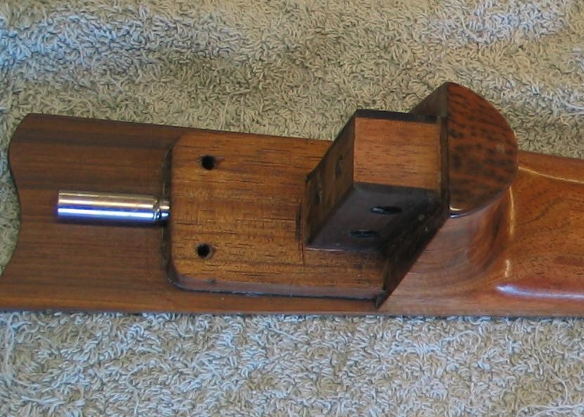

Hi All, My system is basically the same as Bob's neck attachment except instead of using stainless steel round I use 3/8in square extruded brass and tap for two 1/4 inch cuphead machine screws. I use this because I have a morticer and the 3/8 square hollow chisel. It gets inserted vertically through the heel from the bottom and the cap covers it. In conjunction with an 18mm wide tenon it is a very robust connection.
