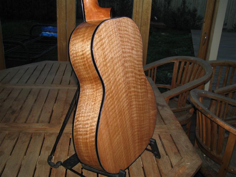

I've got some Carpathian Peter but I haven't built with it yet.
The only comments I've read about Carpathian were from Bruce Sexauer who descibed it as a "one trick pony" in that it was very loud. But it was loud whether you played the instrument softly or thrashed it. I think he found it not particularly dynamic or expressive. However they are his observations from his building techniques and whilst he is a very respected luthier your mileage may vary.
I've built with Tas Oak and loved it.
