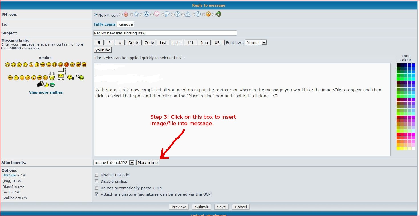

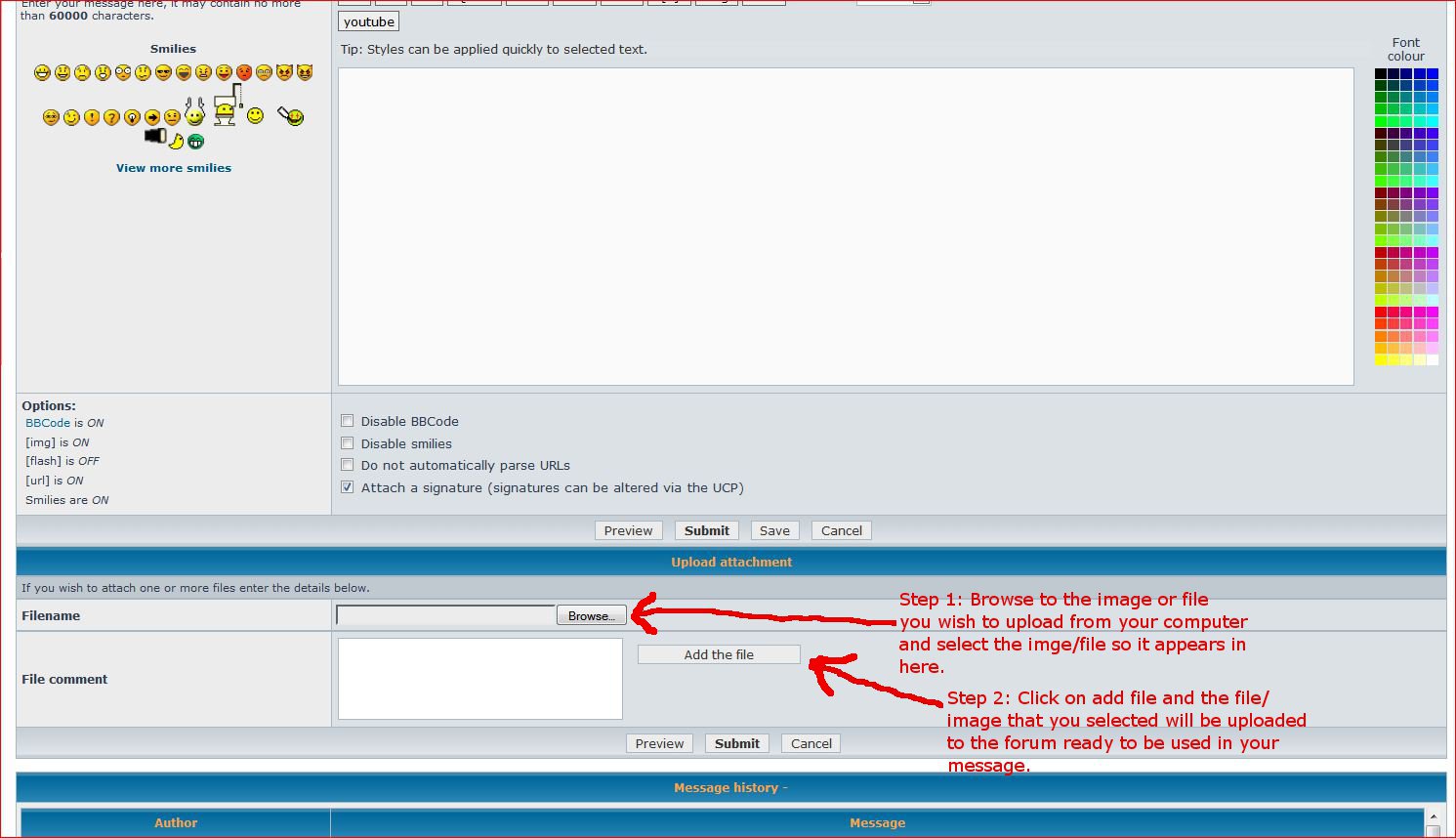

Hi Pete,
Thanks for the info.
I have just had a look at the image code you have used and that appears to be an issue. I adopted your permissions and it looks like your OK to upload images but the forum software is new since the hack so here is a quick and dirt tute. Give it a go.
