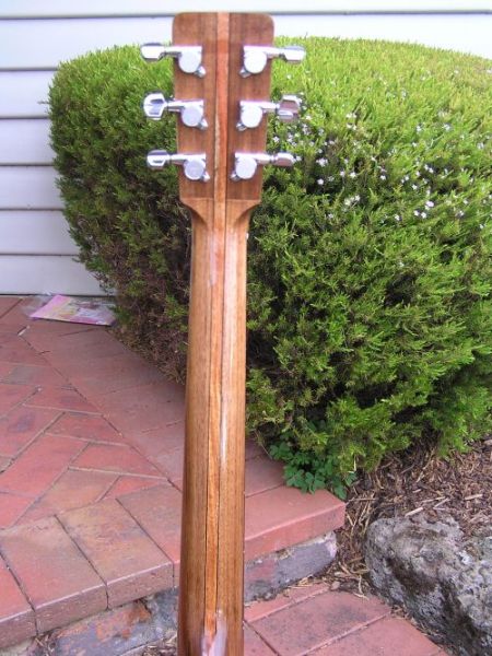

A post that I put up earlier this year, but was lost, concerned problems I have had with the finish on the back of a neck on a dread I made for my own regular use.
Here is a picture of the neck taken immediately after finishing in Sept 2009 when everything was wonderful.
The neck is a blackwood (don't know which variety) with silver wattle lamination up the centre.
The first finish was with Mirocat after filling with zpoxy. Everything was beautiful.
So here is what happened....
- in the months following, I noticed a gradually roughening of the back of finish, but only in the areas where my hands make contact. The heel and back of headstock remained perfect. The affected areas eventually developed a type of pitting or very tiny blisters. I don't have a photo any longer, but I put it up for your consideration at the time. However there wasn't any concensus on the likely cause, though a form of 'amine blushing' attributed to the zpoxy was one confident view from memory.
- so I stripped the neck finish back to bare wood, refilled pores with zpoxy, but made a point of doing a few steps to avoid the blushing from reoccuring. (eg. wipe with naptha before sanding back). Instead of reapplying lacquer, I then applied Whittle's hard oil/wax, as I was keen to try this as a finish as I like oiled necks. But a similar problem has gradually unfolded, where the surface is becoming increasingly rough in the areas where my hands make contact. Unlike the lacquered neck, it is not obvious in this case when looking at the neck i.e. no obvious pitting etc.
I would love to solve this problem. Don't know if it is something in the wood, the zpoxy or in my skin!! Any further thoughts would be greatly appreciated.
Thanks. Frank.

Kim, thanks for taking the time to put this response together - twice!
By elimination, it can't be the finish as the same thing has happened to two completely different finishes with different application procedures.It is unlikely to be the wood, as it occurs on 3 types of wood being used - the Wenge fb binding, blackwood shaft and silver wattle lam.
So I agree, that the culprit is something to do with zpoxy and my approach to applying it.
I will probably sand the whole neck back again, fill it with something else and re-oil.
Thanks again. Frank.
