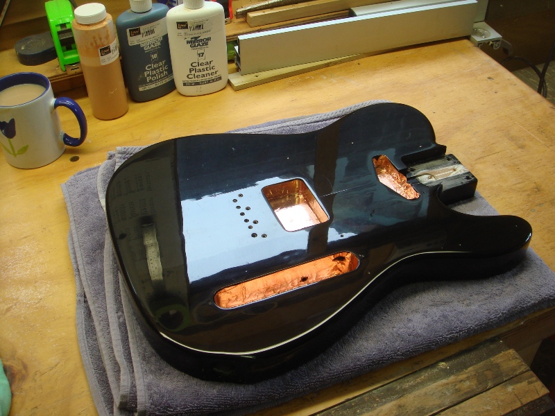

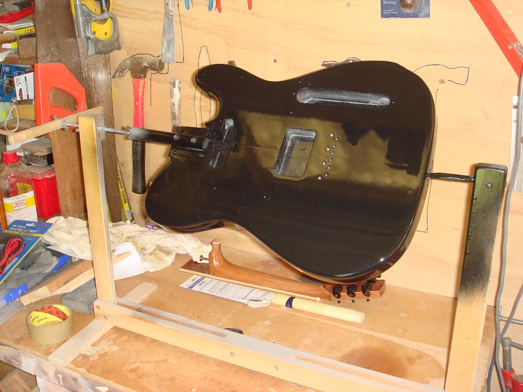

I had come across some kwila and though it would make a good solid body electric and so laminated it up to the right size, with some veneer strips, which I thought looked good and which helped to line things up well.
I had a hankering to build an all black tele with a maple neck, as I had seen a picture of one with gold hardware that looked really cool. I had some right hand gold hardware and pickups I had used on my first tele (Rimucaster) and had since found some proper lefty hardware, so I decided to pull the first one to bits and make a new, right hand tele.

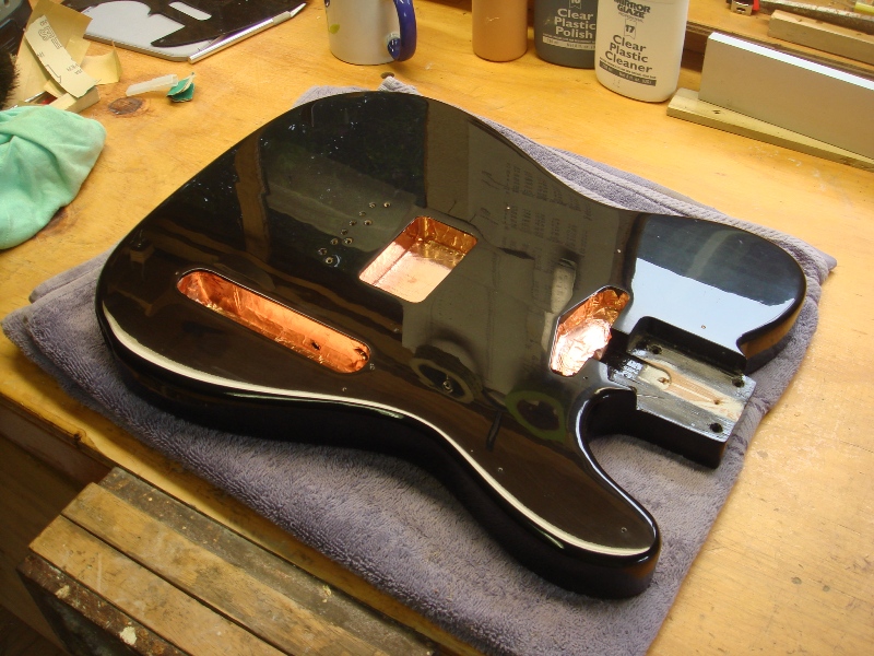

Interestingly, the veneer strips seem to show through the finish. After the first 8 coats of gloss black, I could see them, so I waited for the paint to harden, then wet and dried until I could not see them and put some more black on. Once the paint dried, I could still see them. By this time I had finished my can of black, so sanded back again to remove all traces of the veneer lines and put about 10 coats of gloss lacquer over the black.
Guess what – you can still see the lines! Not to worry, when I do the final sand back and polish, I think they will not show then. This one needs to cure for a while, so in the mean time I will fret the neck and sort out the electronics.

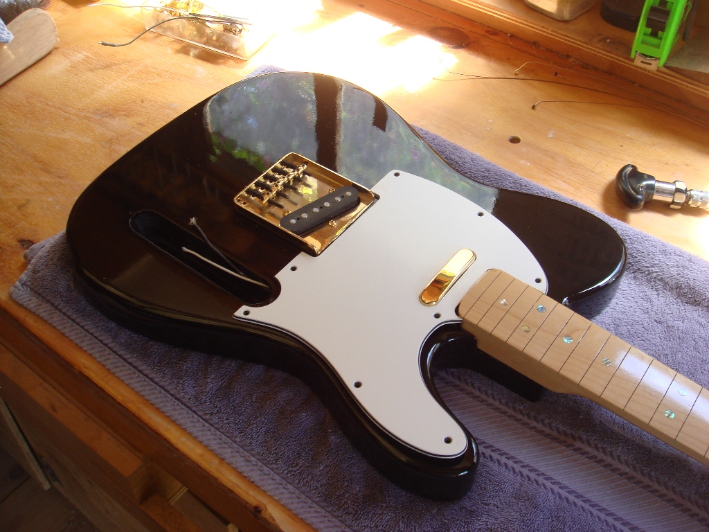

It will have a black pick guard when it’s finished, the white one is a spare I had in the shed.
Here are some pictures, thanks for looking.
Heres the body still in the rotisserie spray jig

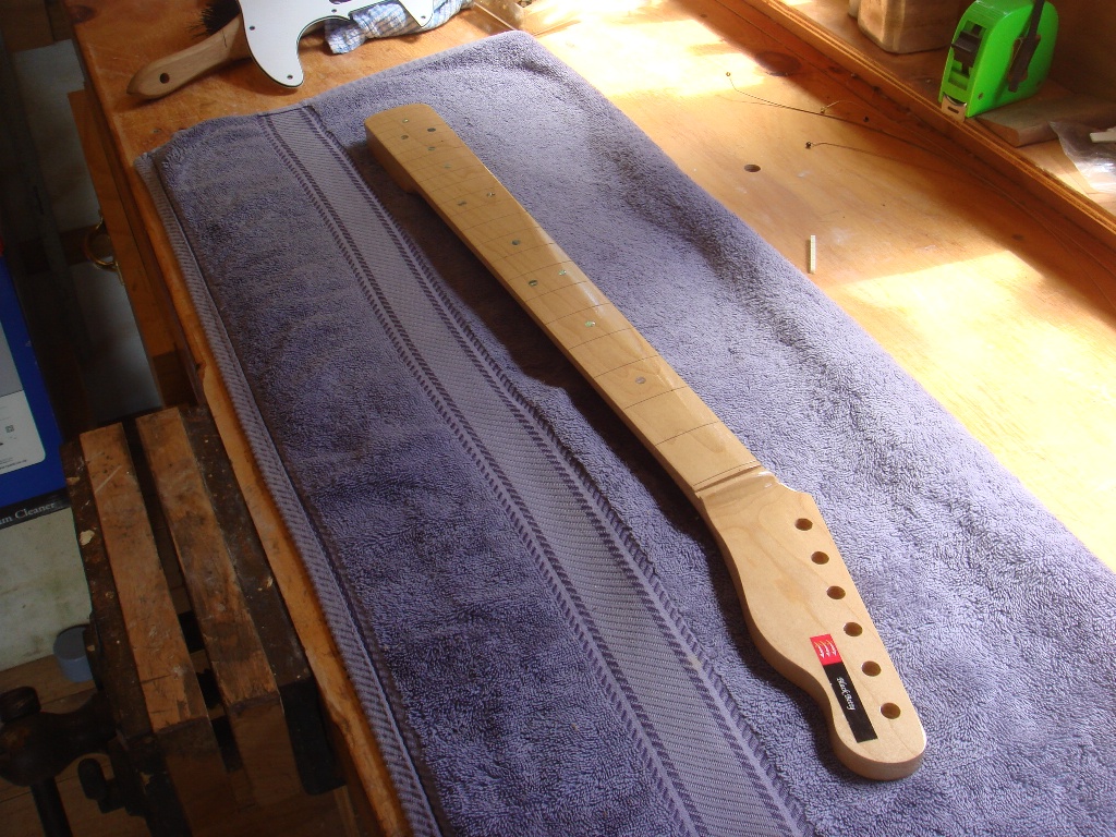

The neck - I love working with rock maple
The white one looks pretty good though!
The all black (not meant to be All-Black) concept.

Re: Black Tele Build
Those lines will dissappear Richard when you rub back the finish. You've got alot of coats on there though so make sure it is well cured before rubbing back otherwise it will continue to shrink after you've polished it & Bazzinga...your line will return
Can't go wrong with black & gold, it always looks classy in my books, nice looking neck by the way where did you get it from? I can't quite read the sticker on the headstock.
Thanks Nick.
In the past I have left the guitar 6 weeks before I start to sand back and polish the finsh. I find it hard to wait that long becasue I am busting a gut to see what it will look like. That means this wont be finished until Christmas.

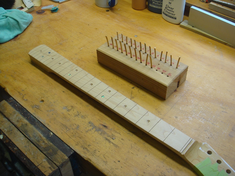

In the meantime I will be fretting the neck. I want to get some gold fret wire from LMI to match the hardware. And buying myself a decent soldering iron.
I made the neck myself using rock maple from Timspec in Auckland and its got a zero fret and an Allied truss rod in it. The label is my attempt at a decal - I gave myself 6 out of 10 for that.

For the amount of 'layers' you've applied Richard, I'd leave it the full 6 weeks just to ensure that there will be no further shrinkage & a full depth cure, but the beauty of you owning the finished product will be that you can strip the hardware off & polish some more if further shrinkage takes place

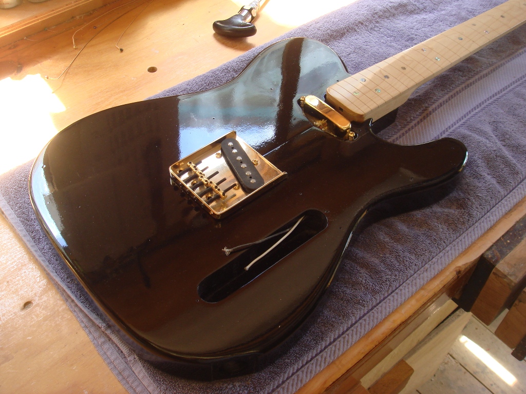

New year progress report
I polished the body the other day, put in the shielding tape I had ordered........not quite enough, so ordered some more. That might get here after the public holidays, so not much progress after that.
I fretted the neck (thanks for the gold fretwire Nick, very nice) and found I had not been careful enough sanding the fret board radius so all the frets had to come out again. In re-sanding, of course I went through the paua position marking dots and had to order some more of those too.
So the usual one steps forwards, two back

Looks great Richard, and your patience really is really going to pay off. It seems to come more easily for me the older I get, but certainly wasn't always like that. No point in getting upset by little set backs. Just find something else to do in the meantime is always the best medicine.

Should look good when you've finished her Richard & as for the slight "whoops", they're all considered 'learning tools' the first time
If you repeat it on another guitar however!
