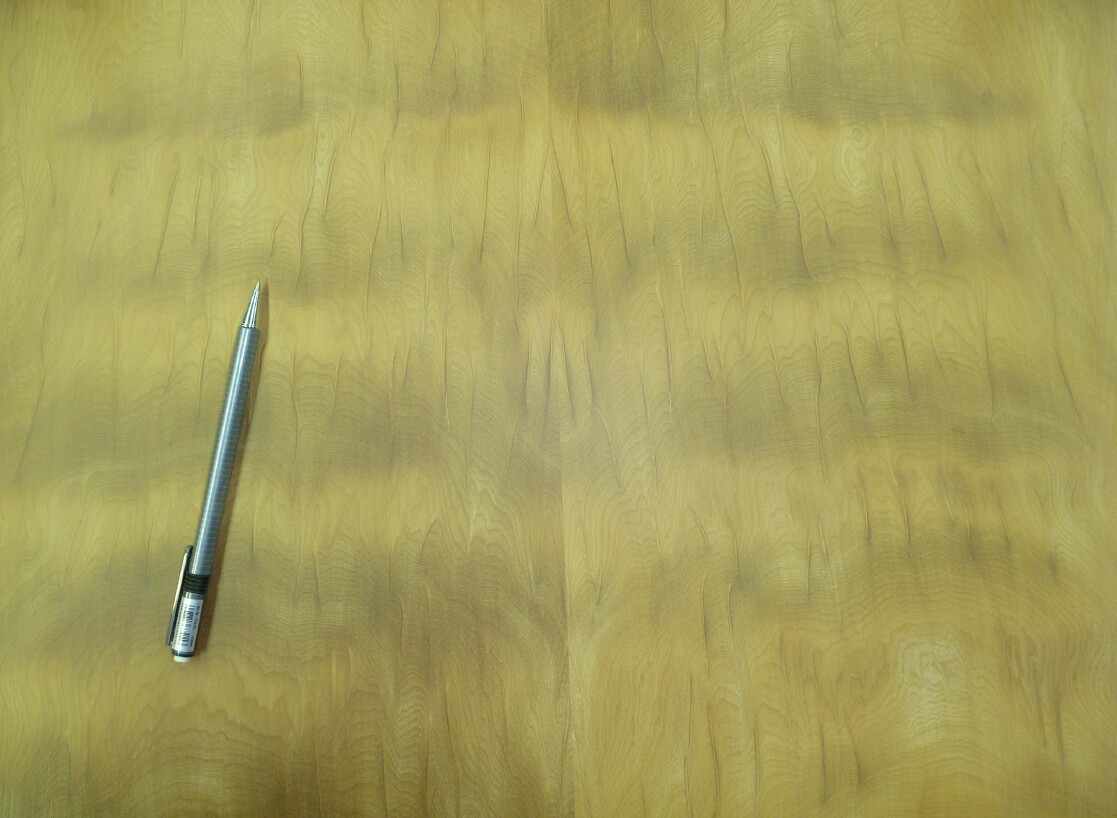

Have never convinced myself that I really like ancient kauri, but being 30 - 40,000 years old makes it very "cool" and of course very "kiwi". This guitar is something of an experiment that I promised I would do if I ever got my hands on some pretty wood (and there's enough material left for 3 more). From the pic, which is only sanded to 120, you can see the little "white bait" swimming through waves.

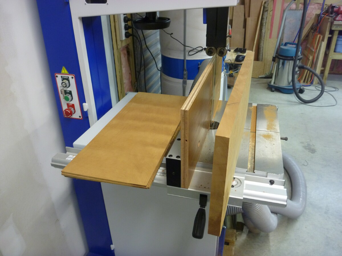

A 55 mm thick chunk was resawn into 4 back sets

"white bait" figure ancient kauri sanded to 120 grit

Haven't used the ancient Kauri before so can't comment on it specifically. Perhaps though, by your description it behaves similarly to Tiger Myrtle? Myrtle taps like cardboard but still makes excellent guitars tonally. There are other timbers that behave similarly as well, though they are not coming to mind presently... :roll:
Love the 'whitebait' figure there, very unusual. I've only ever seen this type of grain/figure on ancient kauri too. Maybe it's unique to it, but I stand to be corrected. You could always add that to the timber gallery thread...

It feels floppy because of the grain orientation, whitebait only appears when the boards end grain is running almost parallel to the face, yours looks like its somewhere inbetween which is great cause you will have a bit of flame too.
