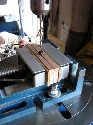

Hey Pete. Could you take a finished ebony bridge pin and put it in the chuck of a lathe then drill a little hole in the knob-end and glue in a little dot. I don't know diddly squat about wood turning though. Maybe I just showed that with the suggestion.

Think the op would be quite easily done on the drill press Liam :)
Yep that should work. Good idea, did not think of that. Probably would not be perfectly centred, but should be good enough.

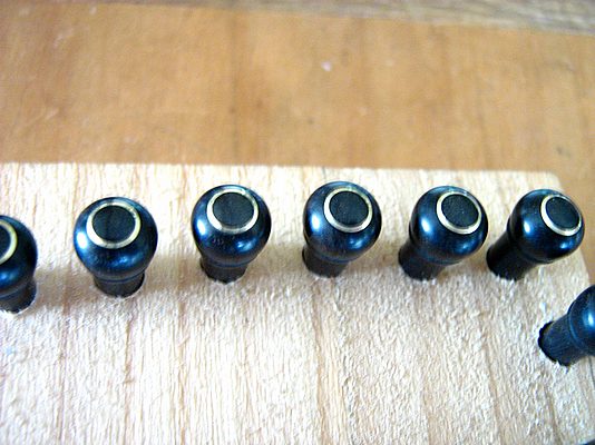

Peter , I've done them in the drillpress . I didn't inlay shell in these ones ( brass and Ebony ) but the idea remains the same.
I've drilled a hole ( smaller than the pin) in the middle of the vice wooden jaws . Align this hole to the chuck with the drill bit. That will centre your hole in the pin ,but be aware a pin with a cranky grain is liable to throw things out a little. prick a mark dead centre on the pin and it may help. Use a Brad point bit
