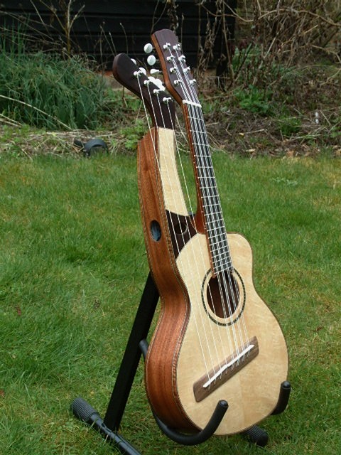

Post by Dave White » Thu Feb 24, 2011 6:18 am
There’s been a long gap here but I’ve had to start making a guitar that will be my sister-in-law’s 50th birthday present and her birthday is in early March. This guitar is at the “finishing” stage so now “Fangorn” can move on again at the same time. Next job is to work out where the bridge will be and what shape. I did this by taping some card on the top and marking where each of the six main strings needs to meet the centre of the saddle to intonate properly. Then I marked in the saddle position for the four sub bass strings keeping them at the same spacing as the six main strings. I can also use a pair of small magnets to check that all of the bridge-pin holes will be on the bridge-plate – always a nervous moment in making an instrument as “off-kilter” as this one but all was well.
This gives me a card template that I use to make the outline of the Madagascan Rosewood bridge:
Dave White
Dave White
Posts: 452
Re: Making a Baritone Harp Guitar
Post by Dave White » Sat Feb 26, 2011 4:21 am
Next the bottom of the bridge is profiled to match the top’s curvature:
The bridge is thicknessed to 9mm from the top surface, the saddle slot positions marked and then routed with a 3mm bit using this jig. Two angled templates are used for strings 1-2 and 3-6 and then the sub-bass string saddle slot routed without a template:
The back edge of the bridge is then ramped on the belt sander and the string positions and bridge-pin holes for the first six strings marked, drilled using a 4mm bit and countersunk:
The bridge is then carefully positioned on the top in the correct position, clamped with a caul on the bridge-plate and the outer bridge-pin holes drilled through the top and bridge-plate:
These two bridge-pin holes are reamed a little way for two of the ebony bridge-pins to hold the bridge in place and the angle of the four sub-bass strings determined using a ruler to mark where the bridge-pin holes need to be drilled in the bridge – due to the hollow arm tuner position the angle of the strings over the saddle and bridge are slightly different from the six main strings:
The last four bridge-pin holes are then drilled and countersunk and the bridge shaped to its final shape:

Post by Dave White » Sun Mar 06, 2011 2:02 am
Next job is to pore fill the back and sides using egg-white. Strips of 240 grit sandpaper are dipped into the egg-white and used to create a “wood slurry” that gets pushed into the pores working a small area at a time. This is left to dry over night and sanded back. The process needs to be repeated two or three times to completely fill the pores:
Then the pre-catalysed lacquer coats are sprayed:

Post by Dave White » Mon Mar 07, 2011 8:09 am
Nick - Thanks. I'm really glad that you and your family made it alive and well out of that terrible earthquake. Makes what I'm doing and documenting here quite trivial and inconsequential in comparison.
Jim - watch (or listen to this space) :mrgreen:
When the last coat of lacquer is on and sanded, the bridge is put on with the two outside pins of the main six strings, its outline carefully marked on the top with a scalpel and the finish underneath the bridge removed.
The bridge is then glued on using hot hide glue.
Tommorrow should be string up time.
