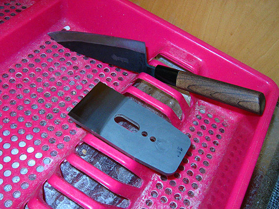

I ask because I have a japanese kitchen knive which starts rusting (within few minutes) on the lower side when laid down on the dry kitchen table (wood) and just wiped "dry". I have it to get the knive "air dried" for at least 10 minutes (will not use mineral oil on a kitchen knive). Once learned that I also stopped using oil on my plane blades and chisels and never had a problem since then (except when picking up the phone while sharpening tool blades... ).
This is my "drying set up" : Oh well, of course the Veritas blades are hard to get rusty, but the japanese knive will really provide more than the daily Fe-dose needed for a well balanced nutrition when getting rusty.
... and yes, sharpening still happens in my kitchen even if since having begun with lutherie some 10 years ago I have "banned" (the rest of) it to the former dining table...).
If your blade was well vented through the night, please let me know, and I will oil my blades again.
Hoping for a fast and not too painful recovery of the shiny side of your fine plane blade!
Did you lay the blade with it's mirror face down?matthew wrote:and wiped clean and dry (I thought) but not oiled. And left on a dry bench overnight
