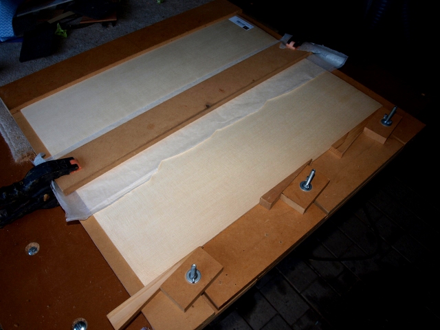

Joining plates... I use QUOINS (good scrabble word!). -Really useful for many clamping/holding jobs. These things are used by printers, they're small metal blocks about 35mm x 15mm x15mm, and with the use of a square key they expand a few mm in one direction. So you just set up your glued plates against a ledge, then a few quoins against another ledge along the other edge and expand 'em to get the pressure just right. Too easy. I also use them for holding fretboards when machining/thicknessing. Scrounge a few from a printing company.

I use a pretty simple jig a flat MDF base with strip of packing tape down the middle,one glued solid timber fence and a fully adjustable fence on the other edge that tensions the glue plates until dry.

christian wrote:I use a pretty simple jig a flat MDF base with strip of packing tape down the middle,one glued solid timber fence and a fully adjustable fence on the other edge that tensions the glue plates until dry
This jig works for me - a variation on Christian's I'm guessing. The underside of the blocks is faced with 80-grit sandpaper to minimise slippage after the wing nuts are tightened and the wedges are tapped home.
It comes in handy for other jobs too, such as gluing fingerboard bindings.
