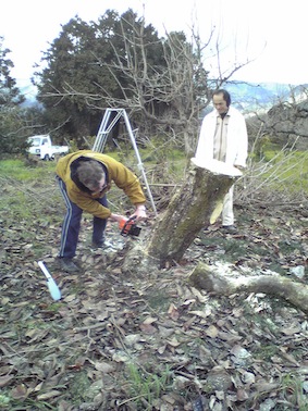

Last year, I told an architect acquaintance of mine that I was interested in trying to find a tree big enough to process into billets for guitar back and sides. As it turned out, one of his kayaking mates has a persimmon farm and was planning to cut down 2 old trees, so on a pre-arranged Sunday we drove down there. I wasn't expecting much, but I thought it might be worth having a look even though it was the middle of January, and freezing bloody cold. An open water tank by the side of the track leading up to the house was frozen over. The 2 trees were on a wind swept plateau overlooking a steep valley. Not that far off, we could see the looming profile of Koya San, a mystical mountain dotted with ancient graves, stone lanterns, and moss covered paths leading through equally ancient forests.
To my great surprise, the biggest tree was 50 cm across the widest point, and the trunks of both were long enough for side sets. The venture was looking worthwhile after all.
Me on the chainsaw. Arriving home, the 2 logs protruding from the back of the car. Trying to cut billets from logs like this with a chain saw is not a viable option. Eventually I managed to locate an operational sawmill, the only one left in this area. The bloke who runs it is is 70 years old. He operates it alone these days, part time. He did an excellent job, carefully lining up the logs and accurately cutting quarter sawn billets, each time asking me how thick I wanted the billet. Check this out - the mother of all band saws.

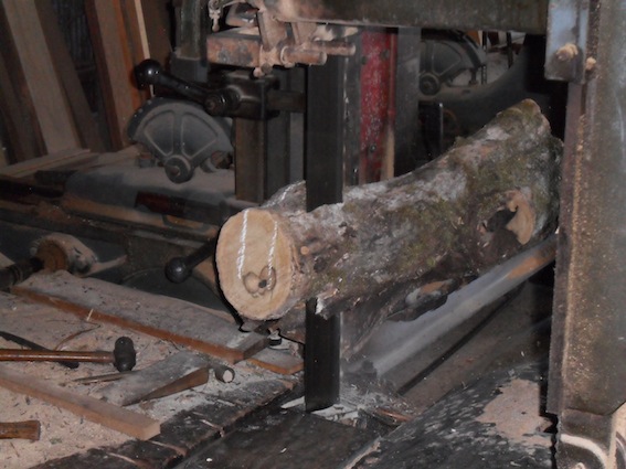

The second photo shows the smaller of the 2 logs. That 10cm blade cut through the logs like they were butter. Width of cut is 4 mm or maybe a tad less.

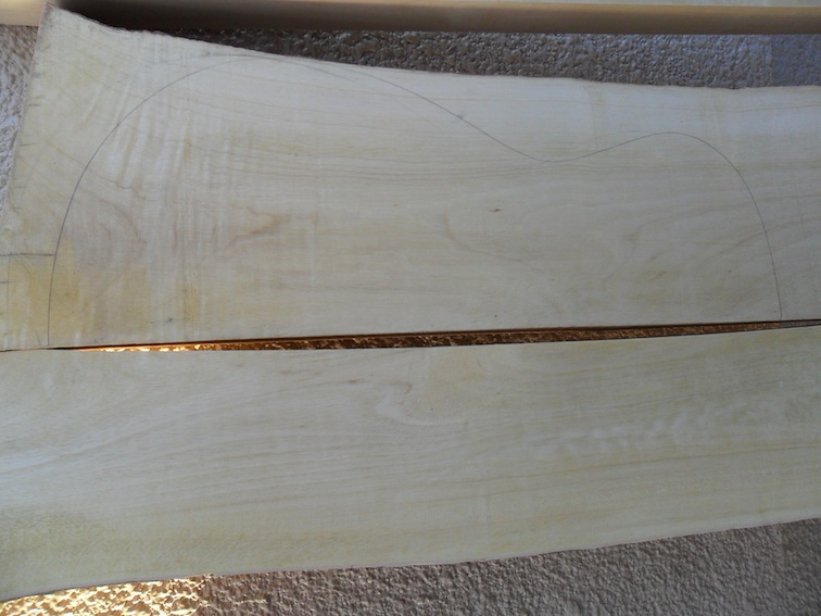

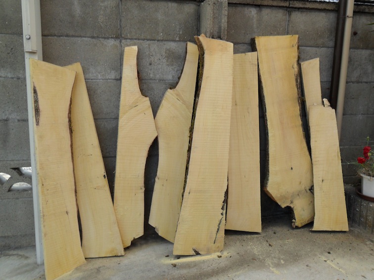

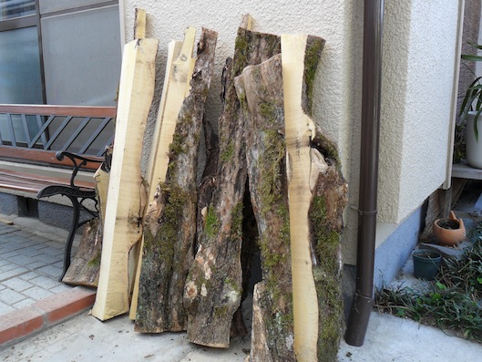

The next photo shows the resulting billets. Persimmon wood behaves like Blackwood. i.e. It has to be cut into billets ideally at least 5 cm thick, and left to dry for a couple of years. 2 or 3 of them didn't go that thick, but most are 5 to 6 cm and as close to quarter as we could get. Next photo shows the offcuts.

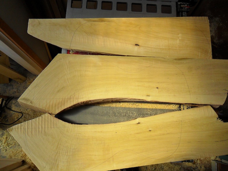

I have a small thickness planer, so I used it to clean up the faces of some of the billets.
Most back sets will be 3 part. There's not enough width in most of these for anything better, but i'm not complaining. After this I won't complain about the cost of tone wood.
I don't know how stable this wood will end up. I've been lucky so far. I've got a few pieces from a small tree that was left lying in a paddock for a year after it was cut down. Its about the same hardness as IRW and rings like a bell when tapped.

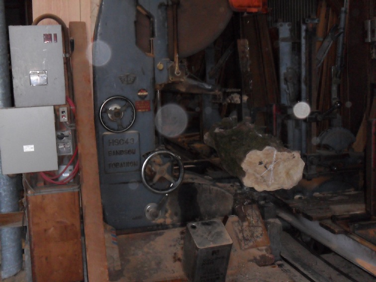

Hi Alfred.
That picture of the logs in the car is great!
Now there is dedication for you.
Any bandsaw that has TWO steering wheels gets my tick of approval too

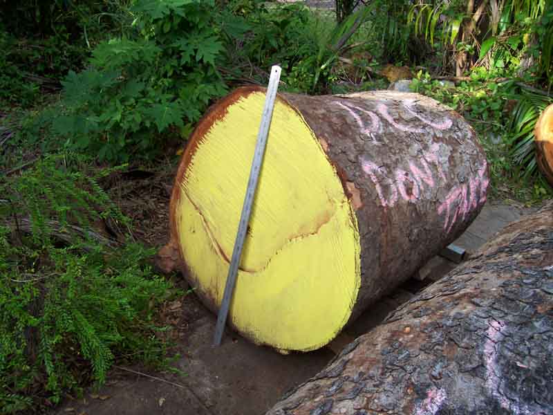

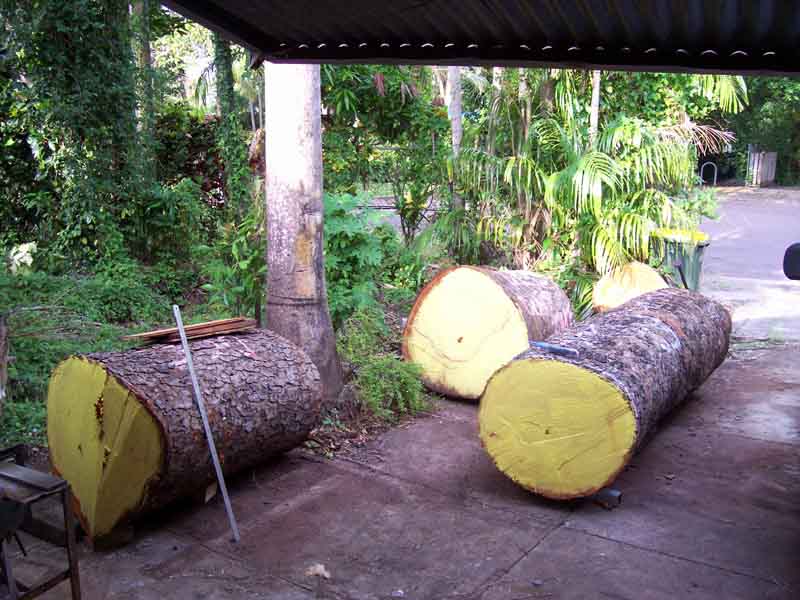

Nice score with the Ebony Alfred and while you are combining wood and natural disasters I thought I would jump in here rather than start a new thread. The recent small cyclone to pass through Darwin brought many off our park trees down and I have managed to grab a few. All African mahogany and the first three arrived on my doorstep today, well driveway anyway as we couldn't get in the house if they dumped them on the doorstep. I have four more from the parks to come (still waiting on dry access) and one large one I have not seen yet in a suburban backyard ( the owner says it is 4m to the first branch and 1m dia but I won't count my chickens till they get flattened by the falling trunk).
Pic one is all three, the one on the right is 2.9m long left is 1.2m long and centre is 1m long (was 1.2 but one of the guys on the limb chipping contract decided they needed a coffee table
oh well plenty to go around I suppose)
Pic two is the middle one with a metre rule leaning against it. The bit with the missing paint in the middle is the pith (that is paint left over from our bathroom not a designer log colour choice)
