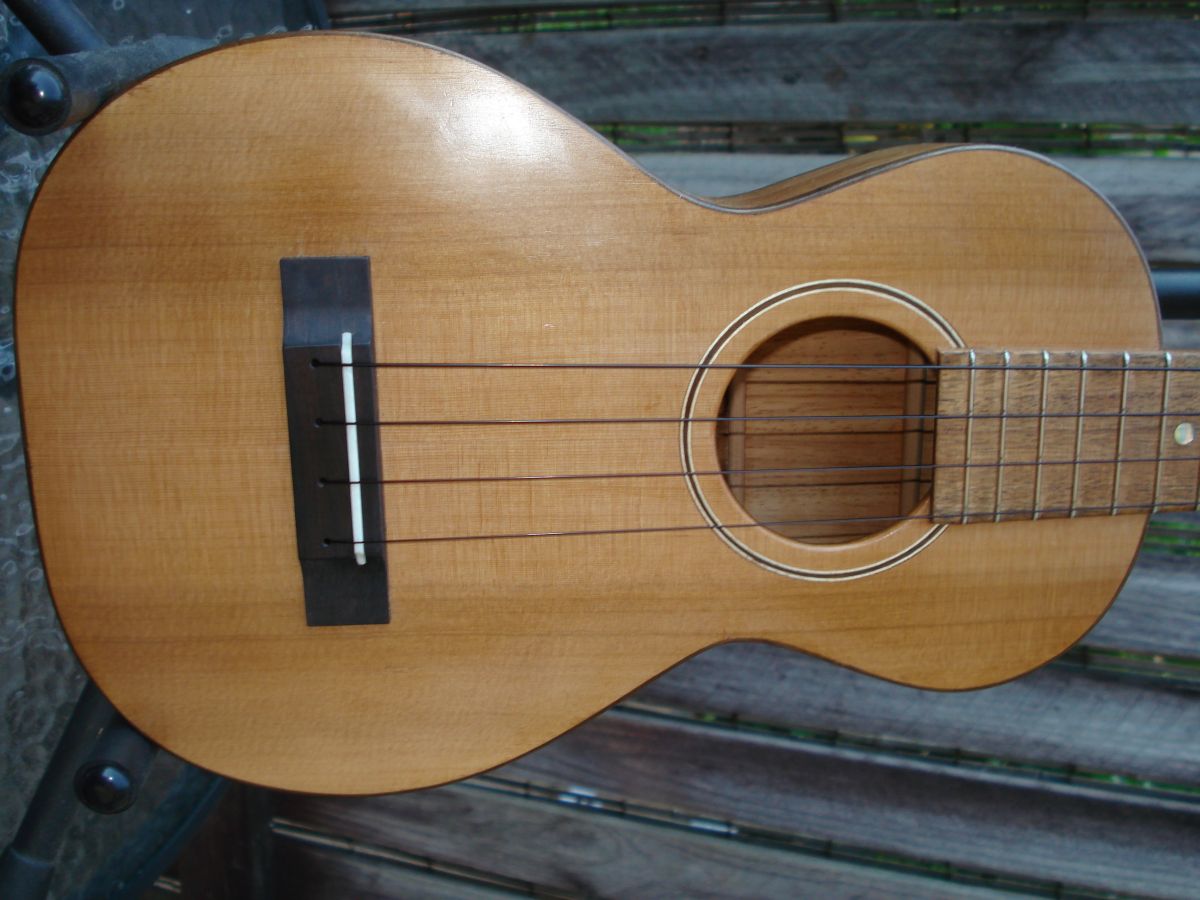

I've used minwax poly a bunch of times. I left a pool of it on some WRC soundboard to dry. Then I snapped the piece to check the penetration.I did this because so many self proclaimed experts claimed it soaks in and ruins the tone. The amount that had soaked In was almost impossible to see. This was a very important lesson not in finishing instruments but in not believing hype.
I'll post some photos when I get home. I think it's an excellent beginners finish. Time for me to step up though. :)

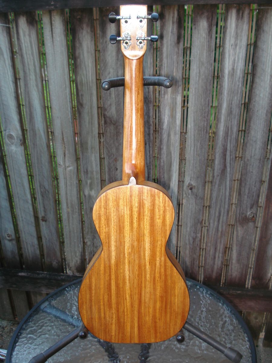

here's some pics
CA pore fill under Minwax Wipe-on Poly (Satin)

That was not nice, Liam. Now we have one myth less to believe in. :roll: :mrgreen:
Beautiful uke, BTW.

Thank you LIam. Nice looking uke, what is the timber on the back?

That's New Guinea Rosewood. Probably the most common joinery timber up here in FNQ and a great tonewood to boot. I can buy it by the shed load up here.

Is this Pterocarpus indicus, also called "Asian Padouk"?

See Liam I have had no luck with the old HHG in terms of getting a perfect centre seam for my Tops and Backs...And that join on your Uke is damn near invisible. I changed back to Titebond after some mucking around and bob is your uncle...Perfect Seam first time might just use HHG for setting the neck and bridge if i ever get the consistency right dagnammit..

Yes Markus, you've got the correct one. New Guinea Rosewood (Pterocarpus indicus)
It comes in all kinds of figure from really straight, ropey and occasionally we find a quilted board. Colors range from light straw to red with the color of Liams uke the most common. If you pore fill with epoxy it brings out a much redder tone to it.

That top would have been about my 9th centre seam joint so naturally I was an expert by then :wink: . Seriously though, I'd say that's probably a titebond joint. These days I use HHG for everything and haven't notice a difference. Bit easier with a uke than a guitar or double bass
