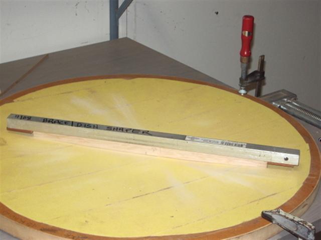

I radius as shown in the photo with the added support to make sure the pressure I'm putting down is more even along the brace's length. You might just see the wooden adjustable end "clamps" that holds the brace in position. Works for me anyway.

Must say that I really like Taffy's brace sanding support...gonna build meself one of those suckers today...THANKS TAFF!! :D

Taffy, could we get some more pictures of your brace. Its really hard for me to make out the details from here.
