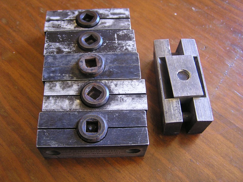

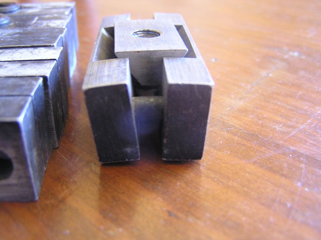

I purchased these on eBay after Jools mentioned them in his post on the Joining Question thread so I thought that I would put a couple of pics up here to be able to show everyone what they are. I have been using folding wedges to clamp my tops but these seem to be perfectly suited to the application.Quoins are from the printing industry and are (were) used to lock the rows of metal typeface tightly together in the press. They are very simple with a screw lifting a wedge up to spread the split blocks and apply the needed clamping pressure. Thanks Jools for heads up as I had never heard of them! I look forward to using them when I join my next top.

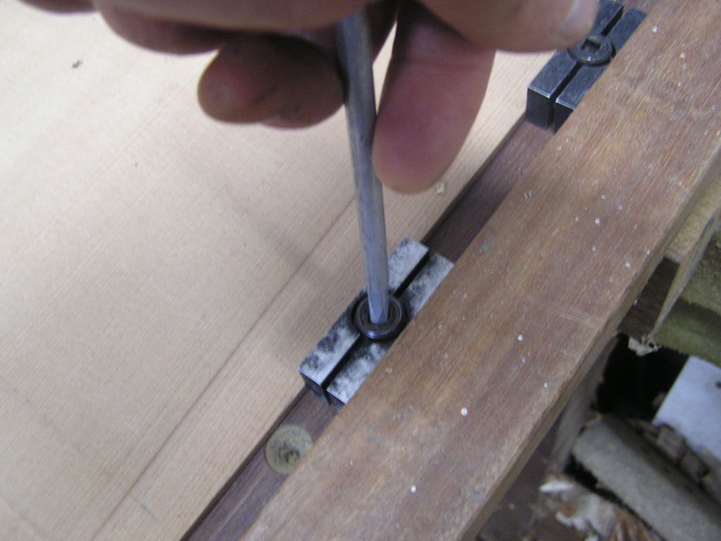

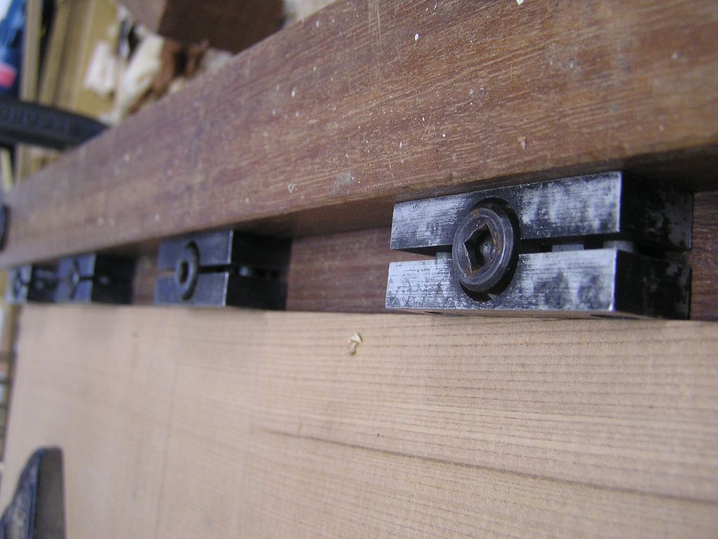

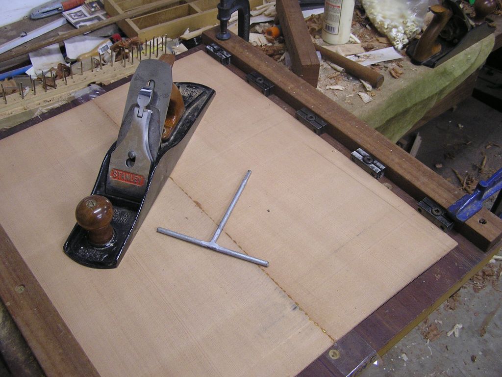

Hi All, I just joined a bunch of tops using the quoins for the first time. One great advantage is the fact that you can dial in the clamping pressure because they are screw operated. I have found some other ones on ebay.com that are a metal sliding wedge type with an internal set of teeth like cogs that you insert a cog like key into and tighten them up. I would recommend nabbing a set on eBay as they will last a lifetime. Thanks Jools for the initial heads up!

Hi Matthew, The postage was GBP 5.00 to Ozland. Yes they are very sweet to use and a great design. It is almost as if they were designed for joining tops!
Mine came without a key but I just welded a T piece out of 6mm rod and filed a square on it.

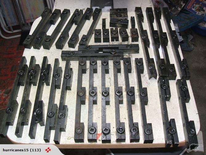

Hey Thanks again John for the intro to these Quoins.
managed to get a whole heap last night on our beloved trademe.(see pic)
I've got a number of applications lined up for them.

Wow, Christian, those are really cool! No worries about thanking me...I had a heads up from someone else so I thought that I would pass it on to everyone...when I first saw them a lightbulb went on in my head probably similar to you.
When Mike Connor saw them for the first time he went and bought some straight away too...no mucking about with him if he sees a great gizmo!
I have used them to join lots of tops and backs and I must say that they definitely make the process easier and simpler. I would like to get me some of those longer ones they look great.

Whoa, Christian you hit the mother lode of quoins there!
I must confess to having searched Trade Me when the topic originally came up but found nothing then and promptly forgot about them. Looking forward to seeing what you do with these. Top-joining assembly-line in the works perhaps?!?

Cheers Jools !!! well spotted, do we call them Jool clamps now ? hahaha
Morgs I was pretty lucky on trademe, initially the guy had them at $200, he then probably realised that no one knew what they were, and that few people would have a use for them, so I waited for a relist, a week later got them for a hundy.
Top/back gluing for sure but gluing necks up, and loads of general clamping where a bit of pressure is needed to secure wood in a jig and such, G or F clamps just get in the way sometimes.
