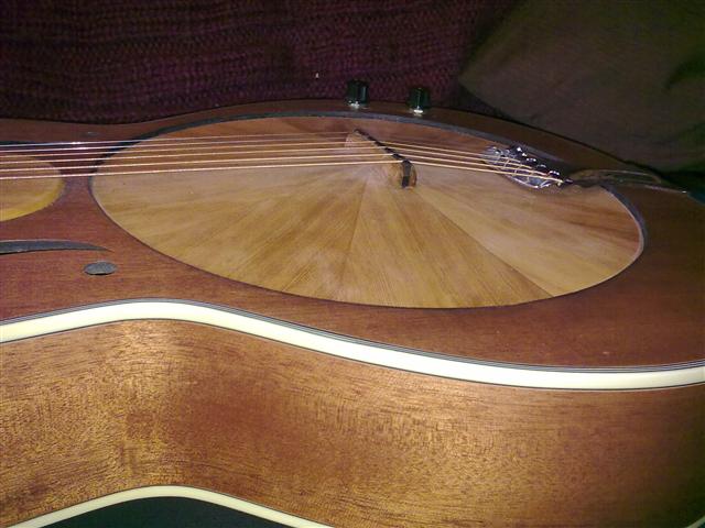

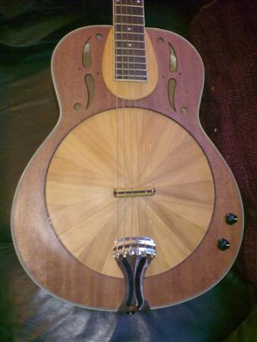

Anyway, had another mystery phone call last week & later in the day this walked into the workshop.
Apparantly someone in Melbourne puts these together using chinese made bodies.

It had a horrible buzz and the owner had given up on using it.
(Been hidden in a cupboard for a while now)

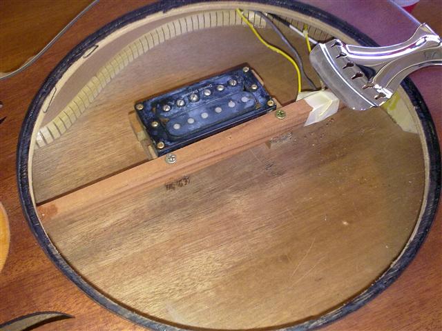

I immediately expected that it was simply the cone not seating right, but was still a bit surprised when I 'popped the top'.

The lattice bracing and the lip under the cone is topped with carbon fibre TOW.
And yep, that's a humbucker acting of a couple of pieces off hacksaw blade epoxied to the cone.

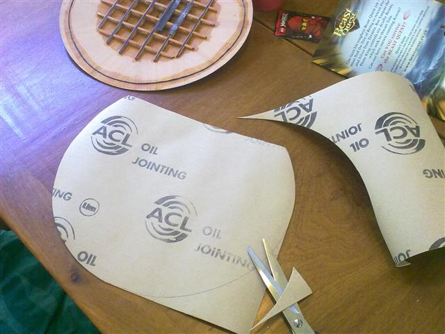

I considered levelling the base of the cone, but decided it would only warp again when the humidity changed.
On the Barron Clarke website (http://members.iimetro.com.au/~barronc/ ... 0parts.htm) he sells gaskets for resonators, so I went to Supercheap & bought some gasket material.
Cut it to fit the lip & tacked in down .

Re-assembled the guitar & now it plays great!

Clancy wrote:On the Barron Clarke website (http://members.iimetro.com.au/~barronc/ ... 0parts.htm) he sells gaskets for resonators, so I went to Supercheap & bought some gasket material.
What did you tack it down with? I'm making a resonator (of sorts) and was wondering how to deal with the rattles I expect.

Post by Clancy » Wed Jun 15, 2011 4:58 pm
Hi Chris,
I intended to use spray adhesive but both hardwares here were sold out at the time.
The owner wanted as quick a turn-around as I could manage, so that he could test it out before leaving for the festival.
So I cut slivers of double sided tape and placed them all the way around the lip making sure there were no gaps or overlaps ( & trimming off any overhang with a razor before peeling off the backing)
Suggestion: Go with the spray adhesive :roll:

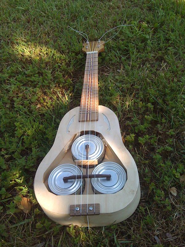

This isn't a proper reso - I got the urge to make a tin can resonator uke, and realised that if I used three cans it would be a Tri-Can. Seduced by the name I pressed on, and will probably be stringing it up in the next few days. As the cans have a sharp rim, rather than a flat surface at the base, it seems possible to me that something a little thicker and softer (like vinyl leatherette, to pick a substance at random) might be an improvement.
If it would do, I have the option of lining the soundwell with it or gluing a strip round the rim of each can (like the rubber sealing strips on car doors/boots/trunks). Any obviously better choice here?

Tried it out today - it's quiet anyway, as you'd expect with cans (these contained kidney beans) but adding a small rim of soft material doesn't seem to cut down the volume much. And it removed one of the sources of rattles! The other source is the bridge rattling on the tops; I thought string pressure would hold it in place (there are locating pins to stop it sliding around) but not so, at least with only one string on. I think I need to string it up with all four and then, if it still rattles, dig around for some teeny tiny screws.
Will start a new thread once it's done, to deter anyone else from making such a daft instrument!

Couldn't resist a quick preview now - the bridge is wrong, as I knew it would be (I changed the design but bodged up the bridge to try it out immediately). I hope I can get it to about as loud as an inexpensive laminate uke, realising that this is not exactly the point of resonators (but a Tri-Can! how could I not?)

Excellent Chris! :D Appeals to my quirky side, you should chat to Luke, a member here, he's done some pretty amazing stuff with bits of old tin :wink: Do the cans open to the rear?
