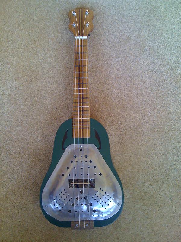

I mentioned in another thread that I was making a resonator uke, using kidney bean cans for the resonator. This is how it's turned out:
It's a fairly soft-sounding beast, but really much much better than I'd expected:

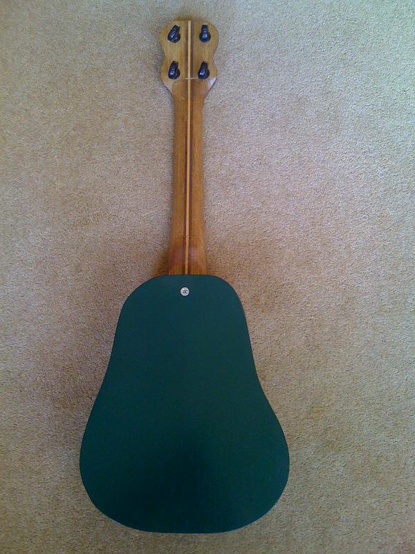

Body is 1.5mm ply, neck is some oak from a dead wardrobe, and the stripe is mahogany-faced ply from the same wardrobe.

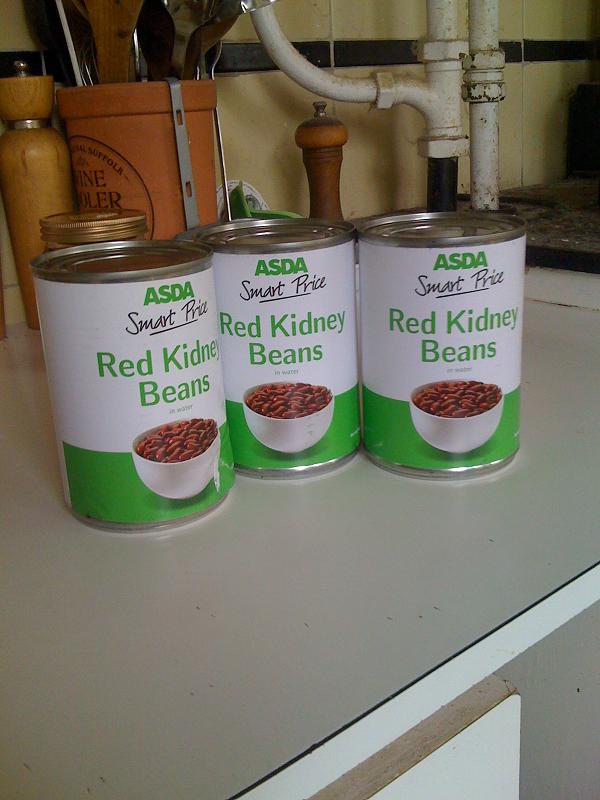

And here's the resonator.
No expense spared on raw materials:

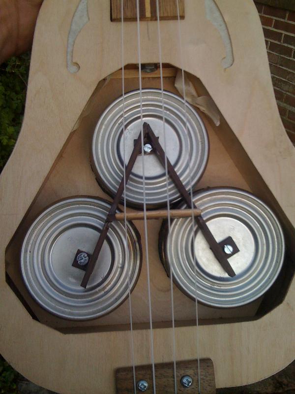

Cans cut down and connected with rosewood bridge with maple saddle:

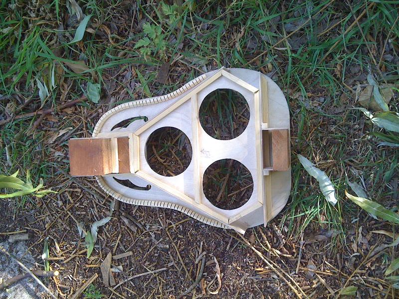

And all fits into a crude sound well (seen from below, with neck and tail blocks in place):
Essentially I started with the top, and then built it up from there inventing the shape and construction method as I went along.

That was a great idea to use three cans, and the whole uke turned out very nice. Congratulations!

The cover plate is not a cut down colander, but a piece of siding from a caravan which I salvaged years ago. Bits of aluminium sheet have proved very useful making accessories for my glider. I recalled my single year of metalwork at school and tried to recapture the hammering skills which made me an ashtray then. So I kept hitting it until it gave in, and then drilled holes in it. If I can be bothered to spend an hour or two on it with wire wool and polish I might even get most of the blemishes out!
