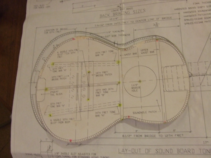

I told the guy in the copy shop that I wanted it copied to make templates and to make sure that the scale was set to 100%. He laughed and assured me that he knew what he was doing.
I glued it to cardboard and cut it out. Then I used it to cut all my jigs and cut out 5 tops and 5 backs. marked them all, and glued back braces.
Meanwhile I started on the necks so I got the plans out. While they were sat there I made a perspex template for the soundhole patches but when I sat it on my marked out back it was too big. I then made a perspex template for the tops using my cardboard one as a guide. When I sat it on the plan all was revealed!
:evil: :evil: :evil: The idiot reduced the size after all! If only I had checked after I cut it out. :evil: :evil: :evil:
After much gnashing of teeth and swearing I decided to move the bridge back to 17" from the nut and leave everything else as is. My ukes will just have 4%-5% smaller bodies than the normal Hana Lima 'Ia tenors.

It isn't as bad as it looks in the photo. About 8mm under on the length. If I do a bit of modification to my jigs, I can get it closer to 5mm short, I hope.

I would save your toes on the kicking!! The % change in the copies size is not very great and one should not expect them to be EXACTLY the same .Because of types of paper,Weight, heating of the paper in the copying process and varying humidity.
No doubt some processes may achieve exact size reproduction but not the general consumer machines

When I printed the OM plans from Grellier for mine, they were in .pdf format. This format saves the print and scale settings in real life size. This information is carried in the file format so when its printed with the "Actual Size" setting enabled the plans are printed large on A0 paper. All good.
What happens when you copy, is a lot of machines have the copy size set by default at 91% scale ( 10% smaller). I can only assume this is to allow for margins, slightly different size paper (B4) etc. This doesn't matter when its a copy of the minutes from the last meeting. It does matter if your building stuff from it.
The copy guy is obviously unqualified to work in the job- he should be aware of this difference between copying, printing, and plotting to scale. He also didn't listen to the customer.

I chipped in on a conversation over on OLF about scaling & taking measurements direct from plans. I stated over there that I was taught during my engineering apprenticeship, never to measure direct off of drawings & any offending apprentice was resoundly chastised if the foreman saw somebody with a rule hovering over a drawing! It also stated in the 'scale' section of the title block of the drawing D.N.S (do not scale). I would say in Martyn's case that it would be acceptable to use the original drawing outline (and as originally planned, the copy) to form the shape of his Uke, a millimeter here or there won't make much difference but when the copy's a mile out (in insect land 8-10mm is close to a mile :lol: )it can throw so many other things out as Martyn's found.
Anyway I guess the lesson to be learned here is "Never assume anything! Assumption is the mother of all f**kups" Just as the copy guy naturally assumed he would get it right :wink: :lol: .
