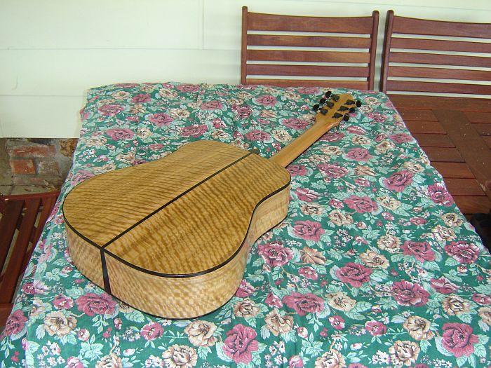

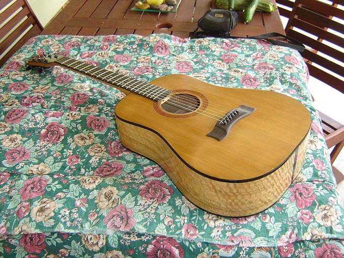

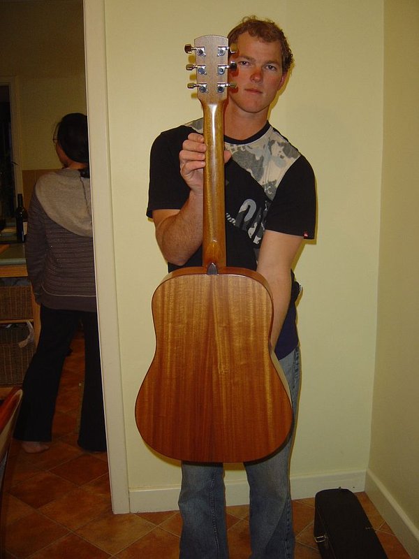

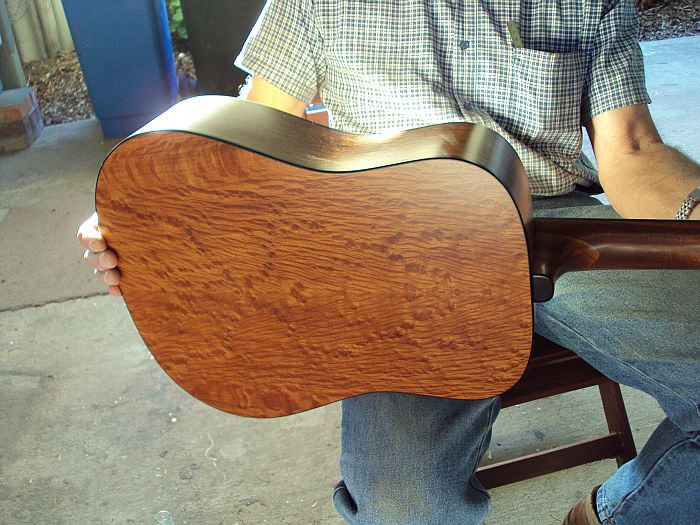

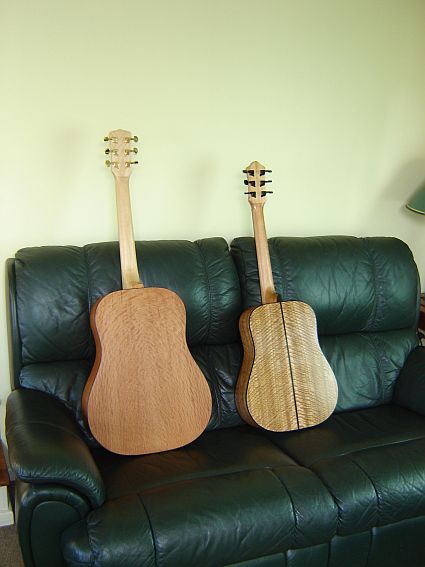

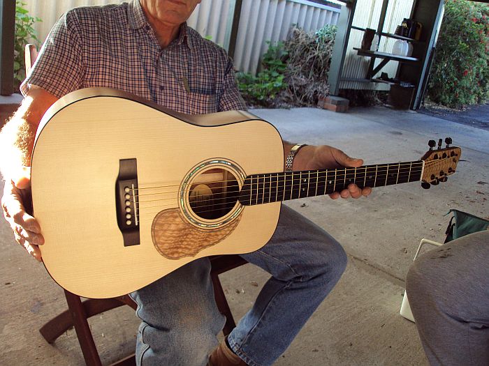

As a follow up to the Wandoo guitar I have some pics of 3/4 dreadnaughts that a group of us have made over the last few years. I guess I an the visual record keeper of our little group of makers but I only take shots as they happen and do not always get the best aspect of view of things.
Anyway ... here they are ... 3/4 sized dreadnaughts as scaled down by Maurice. Most are 610mm or 620mm scale length, feel nice to play as a smaller guitar will and seem to have more mid range than full size dreads.
I have not posted the Wandoo 3/4 or a 7/8 model that maurice did. Must say that I enjoy building this size .... a good one for starters as the bends are not too tight.
Thanks for looking
Cheers Pete
Thanks for looking
Cheers Pete

I think everyone who views this forum will be glad to see Pete is finally able to share some of the fantastic work being produced by you guys in Albany with us. Everything we have seen is a winner and I really like these 3/4's but must comment on the WA Sheoak dred...a real looker and I bet it sounds wonderful also...but what is the neck wood?

'Like the pickguard in the "Sheoak front.jpg" pic - is it also WA Sheoak or something else?
The Blue Gum also looks a little intriguing.
But more importantly, how would you rate their sound?
Looks like you all built off the same plan - and maybe with the same top wood too; if so, this group of builds should provide a great comparo of how each of the b&s tonewoods (looks like you've got Sheoak, Blue Gum and Melanuc in there) affects the sound. How would you describe the sound of each?

Thanks everyone for looking and your comments.
Kim .... the neck on the dig dreadnaught is rock maple and is NOT neck heavy as you maight expect. The back and sides came from Tim .... the best "boing" I have heard in many a timber.
Al .... I have mostly played the Wandoo with a "Lutz" top and the Cedar top Blue gum. The later is a little warmer and mellow in tone but the Wandoo is a recent construct and may develop more in time. It did sound good to me straight up. The scratch plate and head stock on the Sheoak guitar built by Steve is Blue gum.
As a general observation, althought much the same plan, all the guitars have variations in terms of timbers and neck profiles, some are Spanish heels others bolt on etc. and the bridge materials vary. As said earlier, they ALL sound great to me. In my experience full size dreads often lack mid range but the smaller size top may focus or ballance the bass, middle, treble ..... hmmmm ..... strokes chin? I believe brace shaping on individual tops is probably the issue though ......
