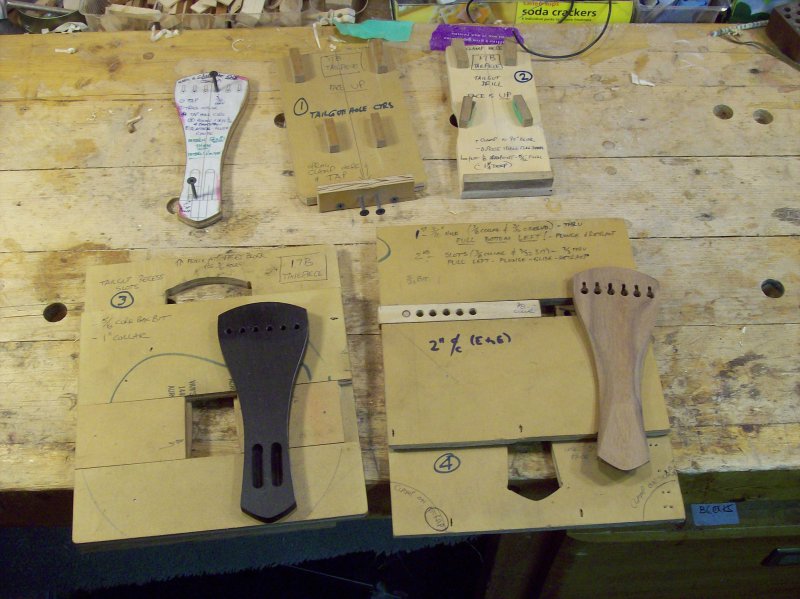

Allen, it's basically Benedetto's design right out of his book. This is an older shot showing the various jigs I use to make it, as well as a couple of prototypes. For those interested, the jigs are 1) tap the (pattern-sanded) blank for tailgut hole location 2) holds blank vertically while drilling 3) holds blank belly up for adjuster slot (collar) routing (which you can just see in the prototype) & 4) sequences for plunge routing button holes, then slots for strings. Prepare the underside, glue the pivot, radius/chamfer the top and done.

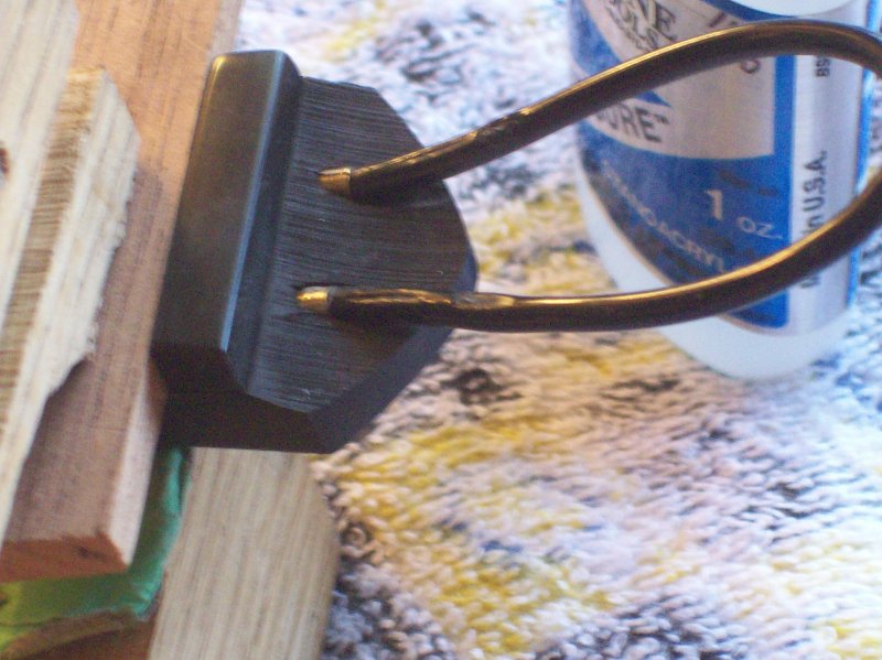

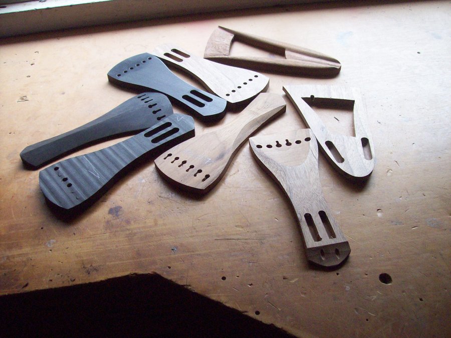

Thanks Nick. Alan, strangely I don't have much in the way of pics of completed tailpieces. Here are some prototypes & works in process that may help, as well a as pic of postioning a pivot for CA glueing. (Or you could try the "raised saddle" route as Dominic showed above). I hollow the underside a bit to promote a lighter look. Adjusters are not visible from the side. I'm also trying the "center spine" look shown on a current build (typically I just radius & chamfer), which if a violin tailpiece would be called the "English style". Check out the "pictures" & "instructions" for Stewmac's Benedetto archtop tailpiece.
