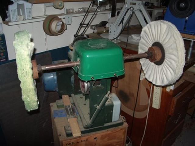

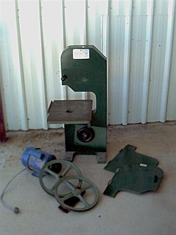

Hi Al, you have possible seen this machine, I made it some years ago out of the bottom end of a small bandsaw, the buffing wheels came from Stewmac. I've used hand held buffers but I prefere to move the instrument [its lighter] and not the machine.
