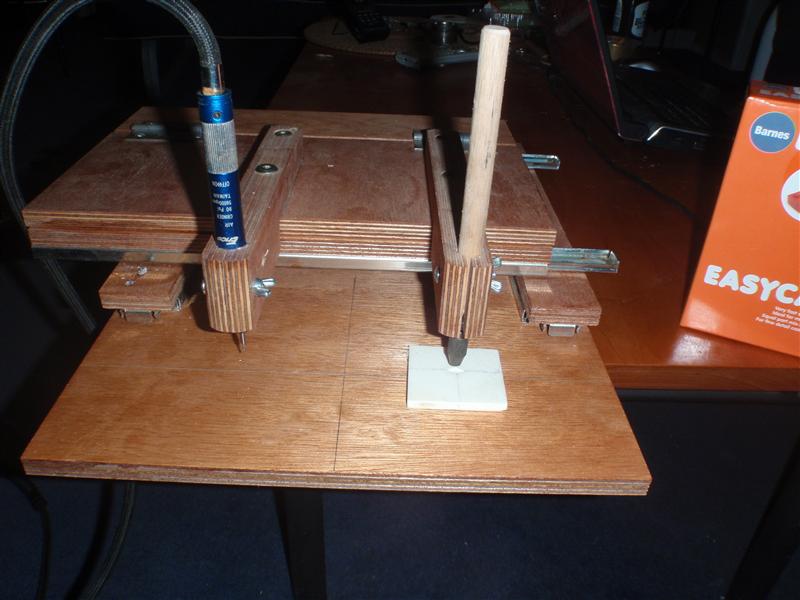

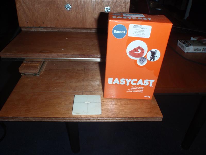

Re: PreciseBits
Here’s my version of the pantograph. I kept it simple. I don’t think it needs a lock down bolt and it does not need to be split. To adjust depth I set the stylus on top of the mould and lower the bit until it just about touches the top of the finger board. That way the shell will be slightly high, better than too low. And when I lift the stylus the bit can’t touch the finger board. I have used it on one fb and it was simple and fast. Lift up stylus and bit, line up hole with guide lines marked on body of the jig, hold the stylus over the mould and start router and lower into fb. Simple one handed job. I have a board with pins that hold my fb lined up and it’s a simple matter of sliding the board forward until it lines up and rout away. As long as you set up the mould right to start with you will get perfectly lined up inlays.
Sorry for the bad pictures, in this light it was hard to get a decent shot of the mould but it comes out very crisp. For the mould I used this easycast polyurethane resin. Sets in a couple of minutes and is more flexible than friendly plastic so you can de-mould easier. I scratched a square cross on a plastic base and then glued the diamond shell as perfectly as I could in the centre. The scratch marks showed up on the mould and give me something to help line up the mould in the jig. You can just see them in this pic.
Happy to discuss.
Happy to discuss.
Re: PreciseBits
Hi Dominic, your duplicator looks great!
Do you think this design with aproximately the same drawer slides would still be OK with a router (not a small laminate trimmer) or do you foresee some problems at first sight? (Such as vibration, security or whatever).
Re: PreciseBits
Hey Markus, like I said it pretty basic and not as pretty as others I have seen. But it is accurate and square and has no slop so that’s all that really matters. These are good quality slides, the shortest heavy duty slides I could find and it is hard to feel any play in them if at all. Some of us use similar set ups for doing bindings with a laminate trimmer. With beefier body the slides would hold a trimmer easily. Extra weight makes it run smoother. But these slides could handle much more weight than what you are asking of them.
In fact, I have put together an over arm router using a pair of these same slides based on a plan from popular mechanics. Basically like my binding jig but with a deeper throat of around 500mm. Have not set it up yet as I was finishing setting up dust extraction for my router table. This new jig will attach to the wall but be removable and share the router table with my big under table router. It fits a laminate trimmer. With a pin in the table I should find many uses for it. Including cutting F holes for my archtops and any other pattern routing. I've seen a vid on youtube of a guy using one to do a very inticate fretboard inlay.
I still need to add some stops and a leaver to lower and raise the bit.
I’ll put up some pictures when its finished if anyone is interested.
Re: PreciseBits
Thanks a lot for your detailed answer. I have only used smaller drawer slides (for my "Joint Apprentice Hobby" saw). Good to know that the bigger ones also have almost no play.
Re: PreciseBits
Markus, how big a router do you want to put in a jig and what are you thinking of making?
I used 2 slides in my over arm router but you could go to 4 if you were using a large router (or 8 if you are making a large pantograph). These are rated to carry 45kg fully extended which should be heaps. Soft start router would be helpful to avoid torquing the jig too much at start up and a correspondingly larger heavier jig body and these slides would do it easily.
Re: PreciseBits
I am thinking of making a charango body copier (could/should be used as neck duplicator as well).
Movements in vertical direction will be done by moving up the work piece / template at every pass, kind of reversed daylight mine: the mining machine moves only horizontally and the ground comes up.
My router is a Kress fm6990e. It has a detachable base (43mm collar):
It's a soft starter.
But maybe I'll design the thing to accept also an angle grinder with a lancelot chainsaw blade to get rid of much wood in less time, then switch to the router. It depends on how sturdy the copier turns out if If I decide to make an angle grinder attachment or not.
I don't worry too much about overhang, maybe I'll do the same way as I did with the saw where I used overlapping pairs of slides in order the action always happens between the supporting parts in the drawer slides. This makes a bulky machine but will be more likely idiot proof.
