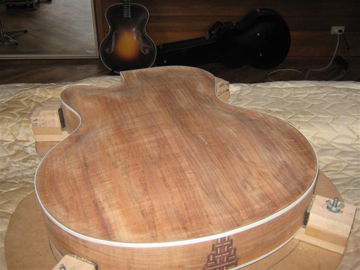

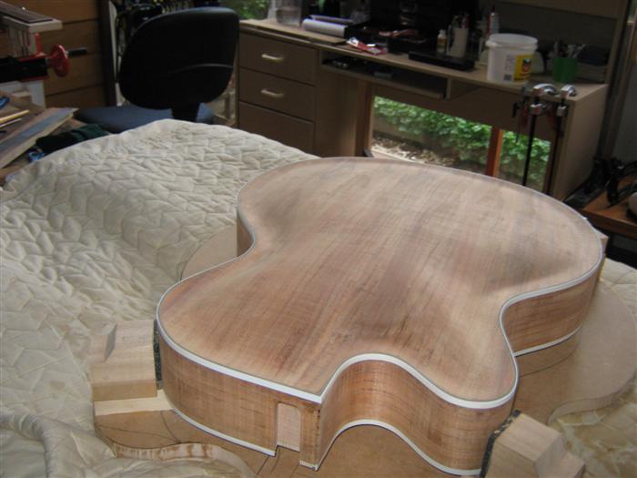

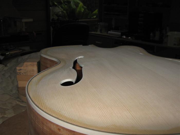

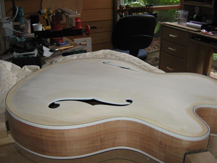

This is a build i started last year but as been put on the back burner while i concenrated on another build, which is almost complete, so this is back on the bench.
The b/s are blackwood from Tim Spittle, the top is Engleman spruce, i'm just scraping the recurve at the moment [BY HAND, NO CNC INVOLVED HERE !!!! :P :P :P ]
Cheers,,, Rod

Whats going on with the nifty end block there?

The tail inlay is to compliment an art deco style tail piece i'll be using on this archie Matt.
Craig,, This one is quite light compared to some of my earlier efforts, a bit of experience does help in this caper, i'm getting my plates much thinner, i don't mind the blackwood, i find it quite easy to work, has a nice smell too.

You are certainly getting the hang of these things now Rod, it's looking all class & I'd love to see a close up of the tail graft too! How do you find working the Englemann as opposed to Sitka?

Nice work Rod.....I do love that Blackwood. Did you find the Engleman a bit furry to work with?

Thanks for the thumbs up you lot, Martin, the Engleman is definitely different to Sitka to work with but not in a negative way, if you were to use the word "fury" i'd say that the shavings come off a little bit fury maybe. But it planes and scrapes quite well,

I found french polishing Engleman a bit of a challenge.....took some time to tame some nibs that kept poking through the shellac. I ended up doing a couple of egg white sizing sessions followed by a light sand back.
