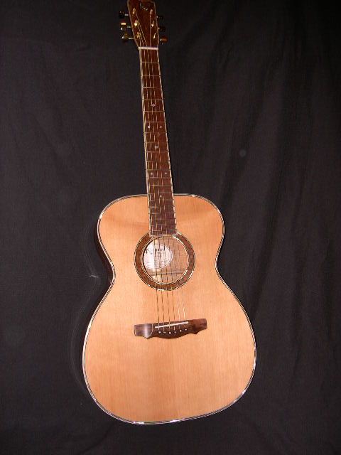

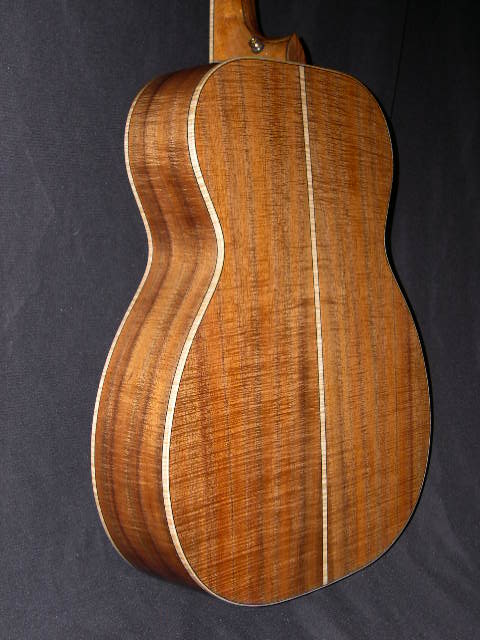

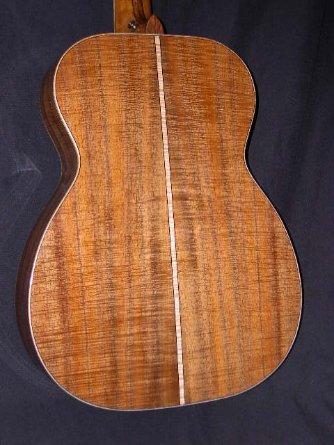

...and:
And the Mulga fretboard-- I love this stuff:
Thanks for watching along, everyone, and many thanks for the encouragement along the way.

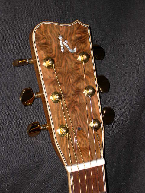

What a beauty!
It was not until now on the finished guitar pictures that I have seen the tiger face on the headstock. Actually there are several tiger faces present. No wonder tiger myrtle is called tiger myrtle...

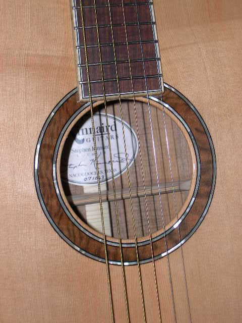

Beautiful Guitar, the browns on the front all blend and look matched in a subtle way,which matches the subtle shell. I also saw the cut away 12 fret you did recenly and put up on OLF , another incredible guitar.
Can I ask , did you use the teflon strip method and how wide is it ? the standard LMI
strips are 63" 94 " thick 1.6 mm and 2.4 mm Im guessing the thickness is the visible surface.
- Stephen Kinnaird
- Posts: 287
- Joined: Sun Oct 14, 2007 1:45 pm
- Location: Texas, USA
Re: KB Pine/Blackwood OOO
Thanks Rob for your kind comments.
Yes, there's a pic somewhere on this post that shows the teflon strip being used.
I chose the 1/16" pearl-- .0625" or so-- and got the teflon strip for that width.
In that size the stip is nearly square, so I'm always checking with my calipers to see which face is the one needed. I mark that with a pen so that I've got the correct width being established for the pearl. Make sense?
