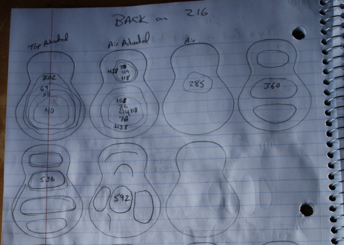

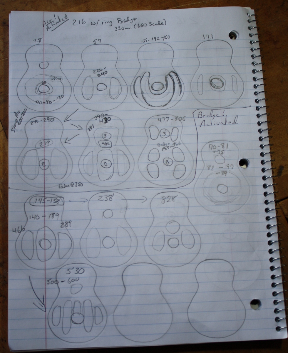

Since this thread is about generating Chladni patterns, it makes sense to show the results of such tests on this guitar. This photo is of my scribblings when I did Chladnis on this guitar with the round bridge attached. The upper part was speaker (air) activated and the lower part was activated by vibrating the bridge itself at those frequencies noted.
I believe you are correct in your assumptions as far as the monopole modes go. The back appears to have the major resonance at 362Hz (tapped in center of lower bout) When tapped in the upper bout a co-peak shows at 249Hz. The back is 3 piece American Cherry.
I guess it ends up being what you mean by "main top resonance". If you mean the T(1,1)3 then it didn't move. But it is no longer the dominant resonance. I agree that it didn't increase top stiffness. The bridge weighs 27g, so it is a bit heavy and should have dropped some resonance somewhere, but I don't see it either.
Chuck Morrison
Re: Analogue signal generator (and maybe more related questi
I figured a more complete set of data would be helpful. This is the back patterns. It's easy to see where the peak at 362Hz is coming from.
