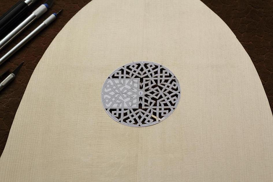

Post by Sergy » Sun Sep 04, 2011 7:12 pm
Thanks for comment addition! :)

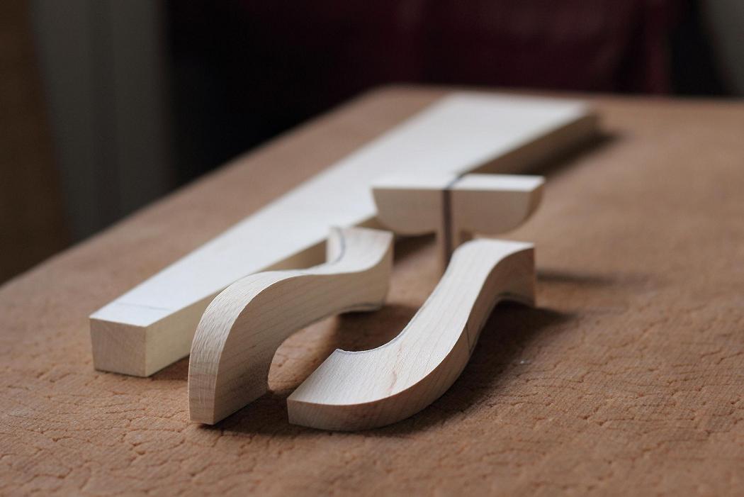

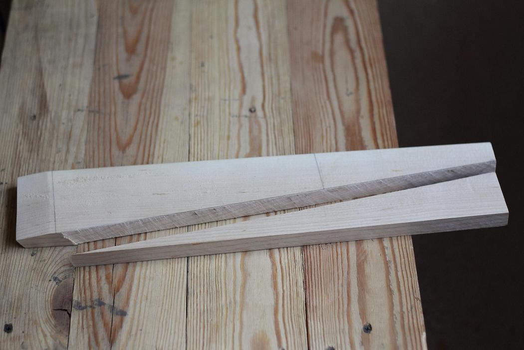

The following stage of processing -
Image Image
Re: Building archlute.
Post by kiwigeo » Sun Sep 04, 2011 7:49 pm
The curvey bits!! :D

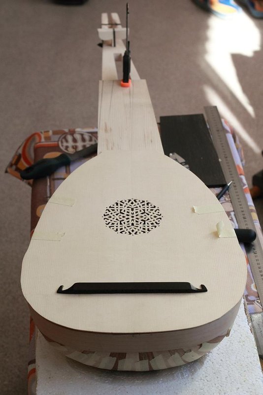

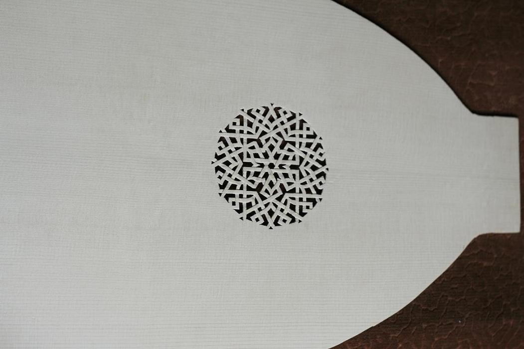

Post by Sergy » Wed Sep 14, 2011 7:51 pm
I continue -
variant of a rosette from the Renaissance epoch:
Post by Kim » Wed Sep 14, 2011 8:00 pm
Coming along beautifully Sergy,
The rose looks very crisp and clean, but then so does everything you have shown us.
Thanks again for sharing. 8)

Post by Sergy » Wed Sep 14, 2011 8:02 pm

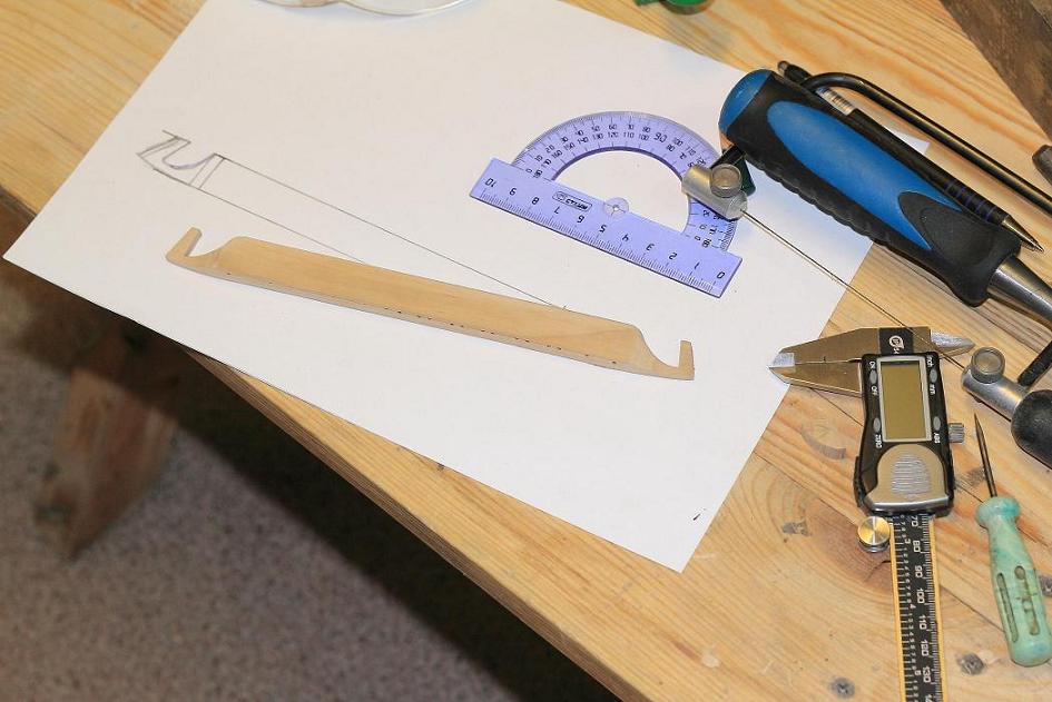

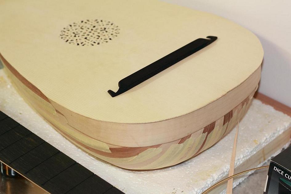

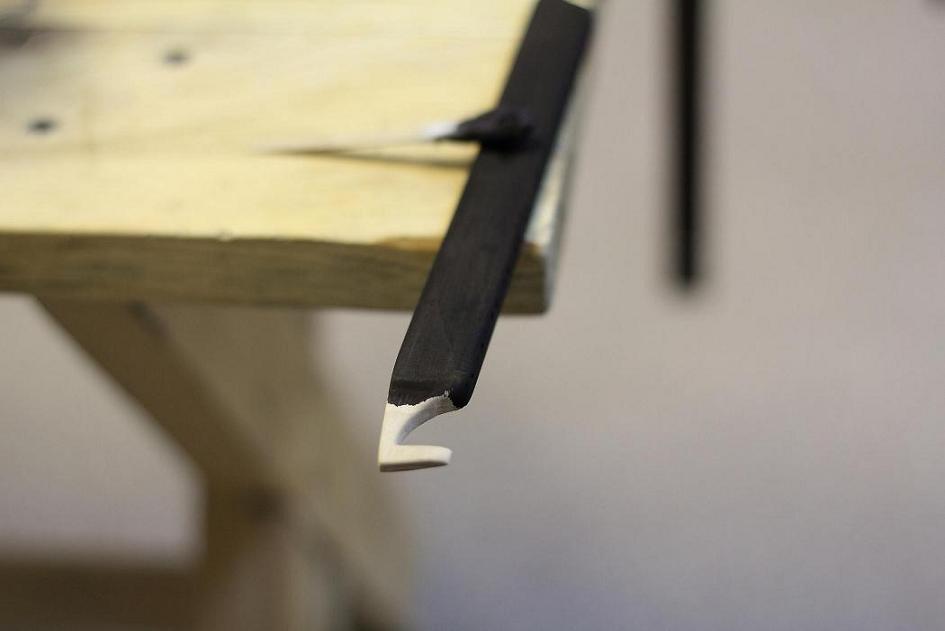

It is a little about the bridge -
(not glued)

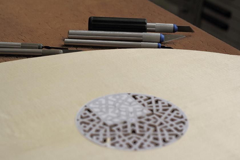

Post by kiwigeo » Wed Sep 14, 2011 8:03 pm

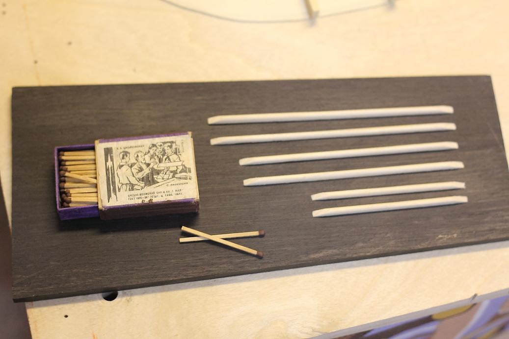

Sergey could you put up a close up photo of the tools you used to cut the rose. Thanks..Martin
Sergy
Posts: 73
Joined: Sun Oct 17, 2010 3:26 am
Location: Aktobe, kz

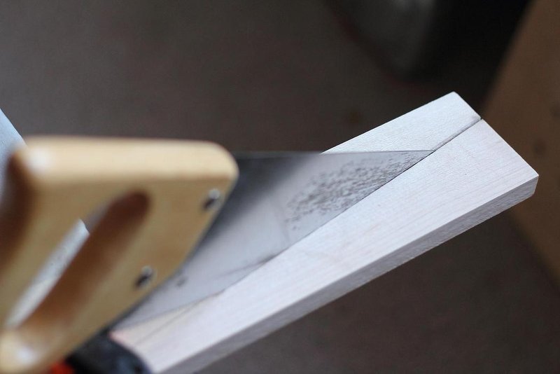

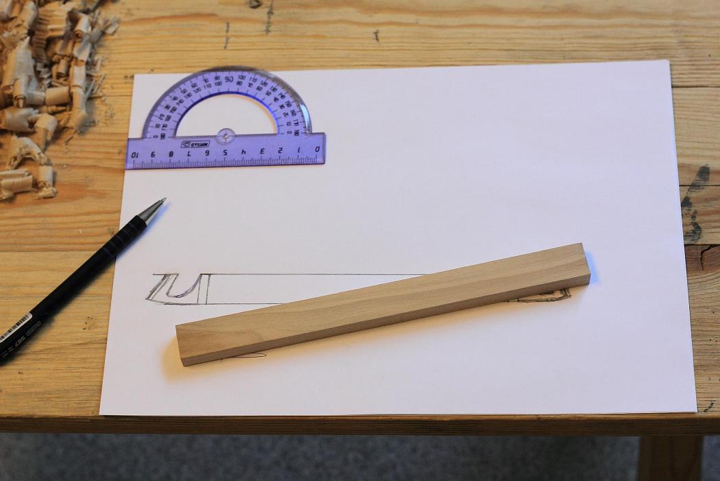

Post by Sergy » Wed Sep 14, 2011 8:49 pm
I used simple hand tools, but before very sharply sharpened.
Here, some -

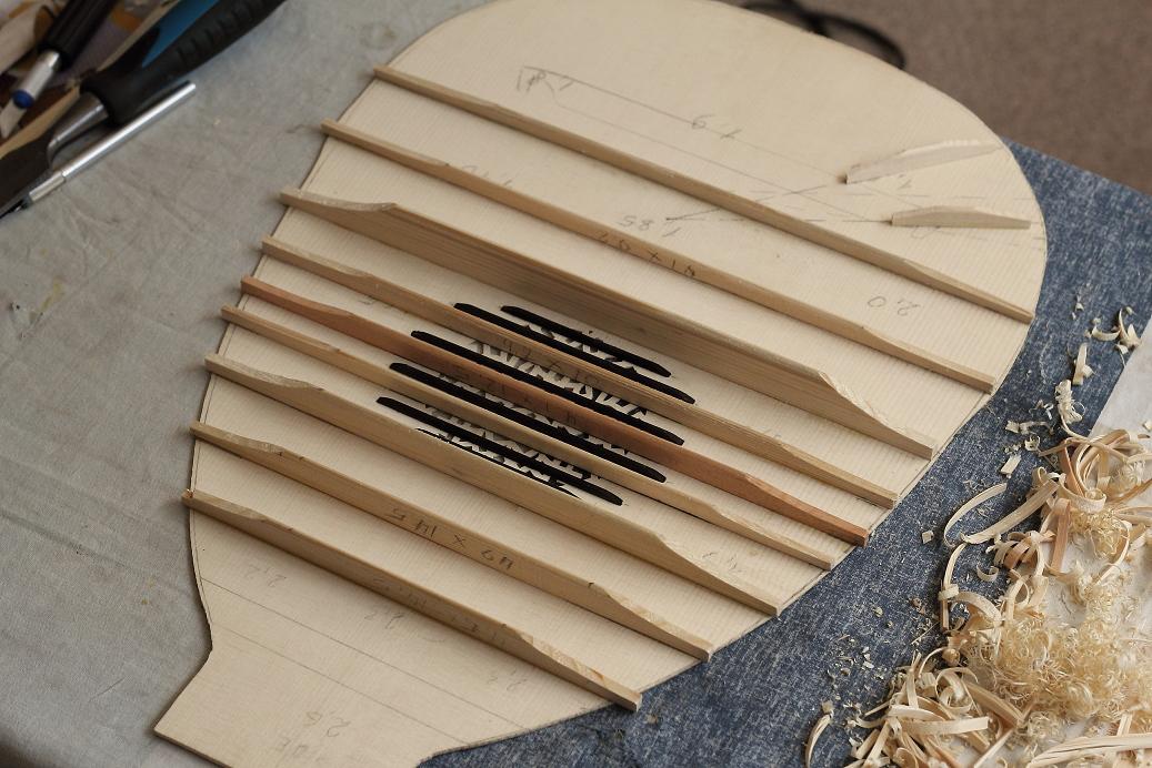

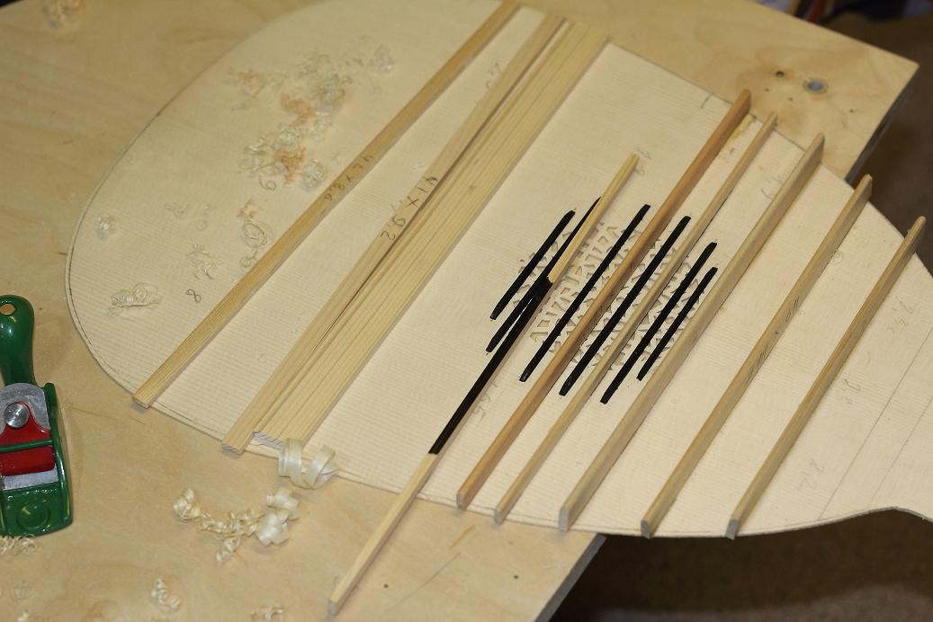

Post by Sergy » Sat Oct 01, 2011 11:11 pm
Very small brace for the rosette
J - bar I have glued later.

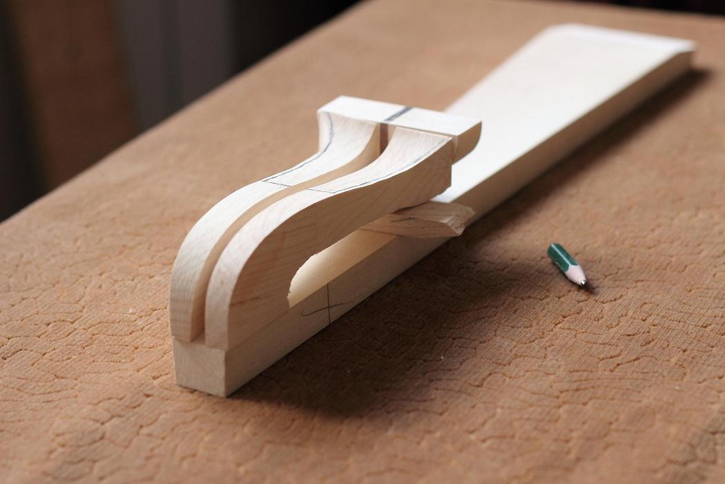

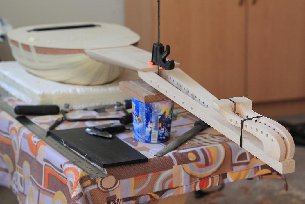

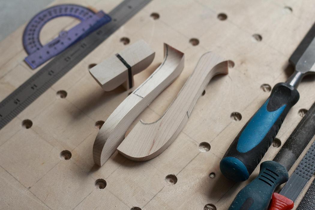

Post by Sergy » Tue Oct 11, 2011 5:18 am
The bass neck is ready for gluing -
Three thin coat of shellac -
Strings has ordered.
Today I process a fretboard.
Post by Nick » Tue Oct 11, 2011 6:10 am
:shock: :shock: Not often you see a headstock longer than the fingerboard :wink: . Nice work Sergy, body looks nice with that coat of shellac on it.

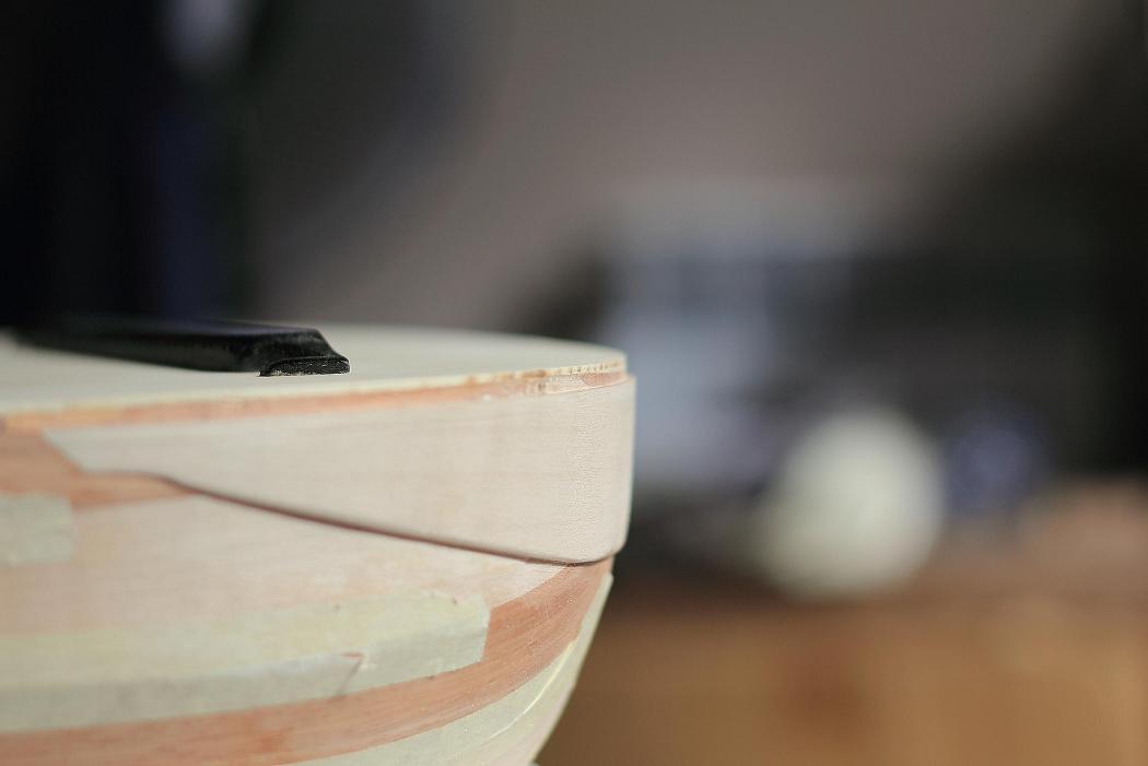

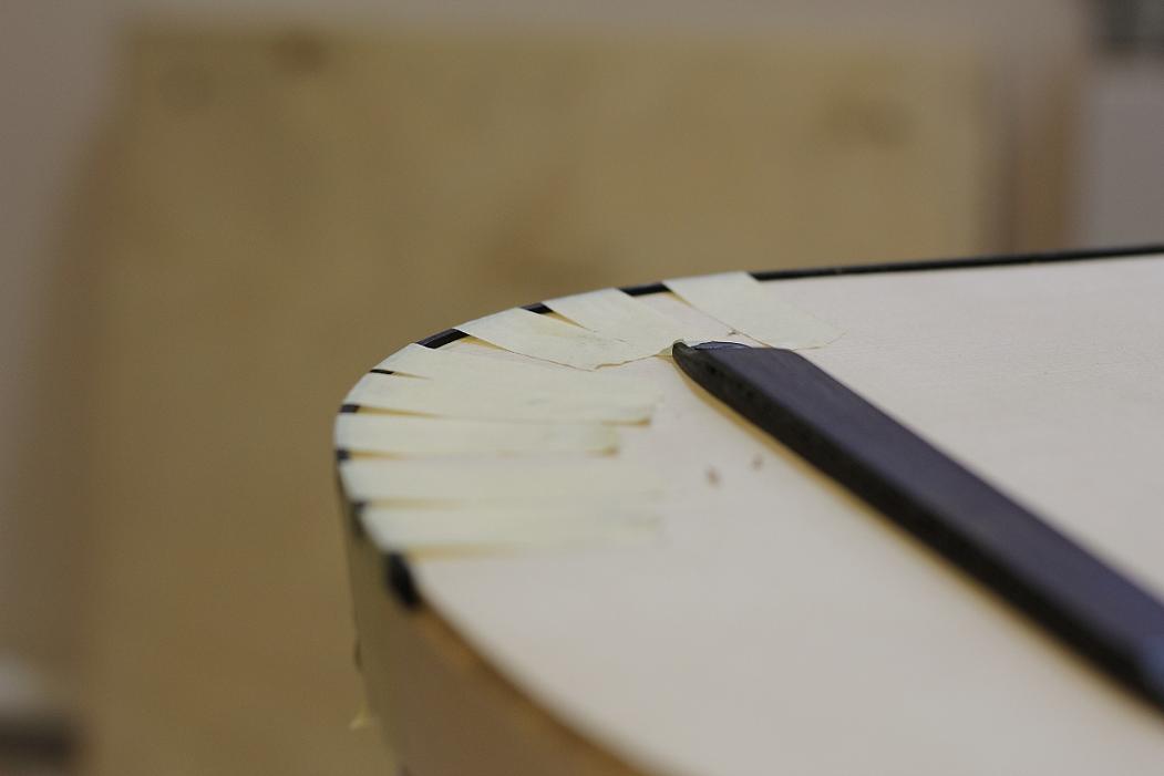

Looking good Sergy.
Do you have any photos of the half binding going in? Did you make up your own cutter to cut the channel?
Sergy
Posts: 73
Post by Sergy » Wed Oct 12, 2011 2:15 am
Nick, Allen, Martin - thanks for kind comments.
I didn't apply to this lute power tools, it all I did only by the hand tools.
But.... for the binding channel I used Dremel... :oops:
(we will consider it as an exception to the rules) :)
Has found two photos -
