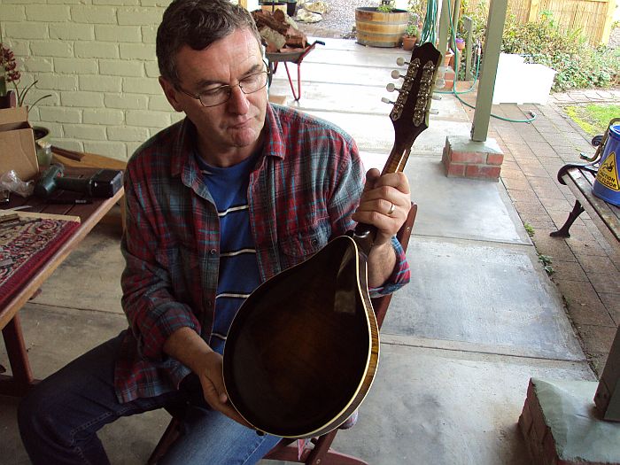

A Mandolin made by one of the guys in Albany
This is French polished with stain on black wood .... it's the only picture I have so not sure if it helps you. It looks better in reality and the grain / figure seems to take the stain quite well. It was a very good first effort .... I thought.
