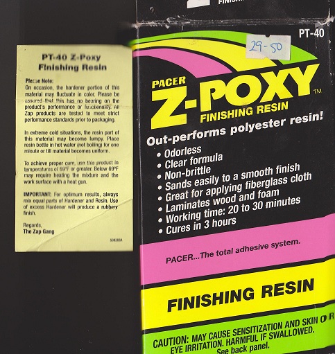

Does anyone know for sure that Zpoxy doesn't bloom down the track? I've never used it, so don't have a packet/instructions to read. It may be on the pack or you may need to contact the manufacturer. So many people seem to be using it and I'd hate to see a whole generation of white guitars in a few years.

I first started using Z-poxy after reading about it in Graham McDonald's Bouzouki Book (sorry graham, not trying to put you in the 'hot spot'
The book was first published 2004, so I assume he had been using it for a while before that.
He would have made a fair few instruments in that time and, by experience, might be able to comment better than anyone else I know on any time delay defects in the product.
For what it's worth, here's the box. (The leaflet might explain the 'strange red colour')

Zpoxy has been used for at least 5 years that I am aware of and there are a few reports now starting to appear of 'belated' adhesion issues. Not too sure about this being related to the "bloom" or whitening that you mention Trevor as the instances appear to be more consistent with the affect of "amine blush" and I am led to believe blush and bloom are two different things..
My understanding of chemistry is quite limited and I can only glean what I can from the work of others, but as I understand zpoxy hardener is formulated from 'crude amines'. This is why the product dries so hard and is very easy to scrape and sand. Unfortunately this also means that zpoxy is more prone than more refined products to forming amine salts or ammonium carbonate on the surface of the curing epoxy which can then go on to develop into cyclic urea among other compounds. These contaminates in themselves or combined can cause all kinds of issues from adhesion problems for lacquers and can actually 'reverse' the polymerisation process responsible for hardening oil based finishes such as varnishes and oils etc. so they become soft and tacky after a while.
This 'blush' of amines can present itself in a number of ways that are dependant upon the ambiance or more accurately, temperature + moisture + ppm of C02 at the time of mixing, application and curing. So depending upon that combination, ammonium carbonate can form as crystals, as easy to see white 'waxy' deposits, or as a water thin oily substance that can be very difficult to detect unless you really look closely.
Now because its essentially a salt, if detected ammonium carbonate can be removed from the surface of cured epoxy with plain water and a scouring pad. You do 'not' want to try sanding it off as this will only server to work the substance into the surface causing more issues. If you wish to be more thorough that a plain water wash you can apparently add vinegar or citric acid to the water which will allegedly ionise free amines into salts thereby increasing their solubility...Be that as it may, I have weighted evidence that washing will 'not' completely resolve the blush problem. I think when given the right combination of temp+H2o+Co2, ammonium carbonates forms 'within' the curing epoxy and not just upon the surface. So whilst you can wash away the surface contaminants, you can't do anything about those which has formed 'in' the curing epoxy.
The issue here is that the ammonium carbonates which become suspended in the cured epoxy will still eventually make their way to the surface over time because epoxy never fully cures. When they do, they will probably cause issues with any finish sitting on top of the epoxy and that can present itself as a blueish or milky look to lacquer that will then develop into air pockets, blistering and peeling as the finish looses adhesion, or as mention, a tacky feel to any polymerised oil based finish.
So how do you avoid the problem? Well you could reduce the risk by using specially formulated 'low blush' formulations of epoxy but the problem with them is that they are not well suited to the task. The amines are more refined with additives such as 'nonyl phenol' which can reduce blushing significantly. But, the MOE of the epoxy is altered and it becomes softer and far more resistant to abrasion. Now this would be great if you are using the product on a boat deck but its the last thing you need when you need to sand the shit off again.
The only real sure fire answer is to avoid epoxy under a finish. The next best thing is to understand what is going on to cause the blush so you can prevent it occurring in the first place. Therefore the number one thing to minimise during mixing, application and curing of epoxy is exposure to Co2 and considering that you will be breathing out shitloads of the stuff all over the project as you work, it just makes good sense have a fan running between you and the epoxy as you work, and if you can, do it all outside to keep the ppm of Co2 to an absolute minimum..the big bonus here is that you will minimise the exposure of your skin to the toxic epoxy fumes and believe me, even if there were no such thing as amine blush, running a fan is worth doing just for that benefit alone. You may have never had a sensitivity issue with epoxy in your life, but take it from me, that can change at any time your immune system decides it should when it sends in the "T" cells to rip your body apart to dispose of the invader...if that battle happens to take place in your lungs, your fucked.
