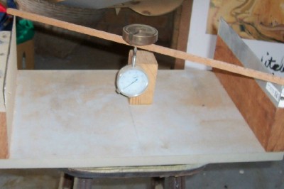

For those who want to know what all these opposing theories mean in practice, I did a quick test this morning of an Xbrace on my deflection testing setup
Brace crossection 8.5 wide 9.9 deep silky oak
Initial seating load 73.8g
Added test load 295g
-First I tested a single brace diagonally across the jig
Deflection on adding the test load was 1.21mm
- I then added a crossbrace just butted and glued to the sides and capped on the underside with a 0.75mm thick strip using superglue gel.
Deflection 0.62mm
-I then chiseled off the cap so the crossbrace was only glued to the sides of the original through brace
Deflection 0.74 mm
Multiple readings were taken to get consistent results in each case
Make of these what you will
Deflection 0.62mm
Deflection 0.74 mm
Re: Stiffness of X bracing
Pictures of the setup
- 100_0345.JPG (62.45 KiB) Viewed 22675 times
- 100_0342.JPG (59.12 KiB) Viewed 22675 times

Thanks Jeff,
Awsome Practical display and test of the theory, makes all the diffence .
Again thanks for the Demo.
Jeff, thanks for doing the test. If you still have your set up I think to test this theory you need to do it like I have in the pic. The horizontal lines are your rests. To test the deflection of the junction set the rests as in the first panel. Then move then to the position in the second panel and exactly the same distance apart and compare the two.
Another way to do it would be to test your single brace, then test two single braces side by side sharing the load, then test the constructed X brace. If the X introduces no weakness it will deflect the same as two braces.
As we agreed, the stiffness at A is not necessarily half that of B or C. But the way you have tested is based on the assumption that the junction is only as stiff as one brace. However, I think turning two braces at an angle and having the junction supported by the two braces backing it up slightly does add structural integrity and means this assumption may not hold. But if you do it using either of the techniques I suggested you don't need to make that assumption and you should get less ambiguous results. And use a larger weight so you push the braces harder and any measurement or set up errors become a smaller per cent of the total.
What I assumed Dom was that if a single diagonal brace deflected X amount then two would deflect X/2 under the same load, which is a valid assumption within the elastic range.
So the single brace deflected 1.21mm you would expect two braces to deflect only 0.605mm
The capped X went to 0.62
With the cap removed it went to 0.74
I havent got adjustable rests and I did cut it apart afterwards to retest the single brace setup, but my X brace test was equivalent to your first diagram and the single brace equivalent to the left half of your second drawing disregarding material outside the span.
Yeah I could have used slightly heavier weights but the weights off my beam balance were all I had at hand
Also I was concerned that in the single brace test, if I loaded it too heavily it would twist giving a higher result
It's not obvious from the pictures but there is a smaller initial weight under the larger one shown, The procedure was to put on the small weight, take that as a zero reading and then add the larger weight on top.
Jeff
Jeff

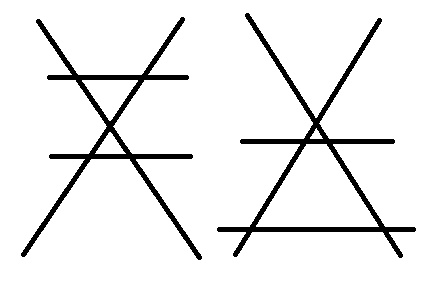

Phil Pearson
The trouble is Phil that there are a number of different terms and ways of looking at "Stiffness"
There is the modulus of elasticity E which is a measure of material properties
Then if you apply it to a beam crossection it is EI or flexural rigidity
You can also consider stiffness of a beam in total and the length then becomes relevant as well as crossectional properties but deflection will also be related to load distribution and other factors such as support conditions.
So the semantics does become confusing
