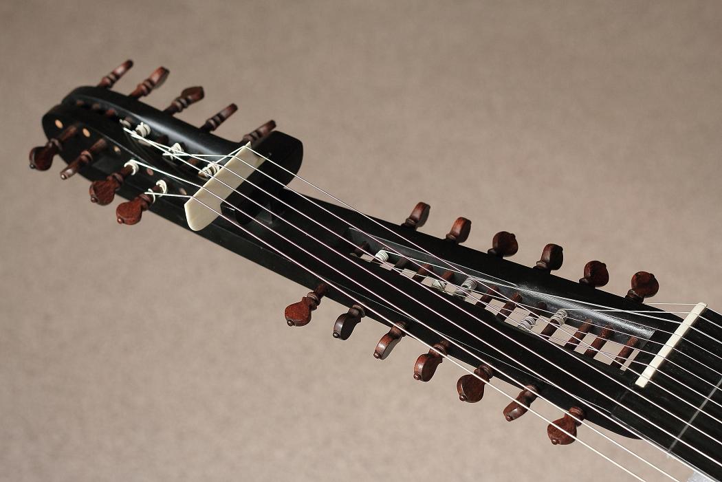

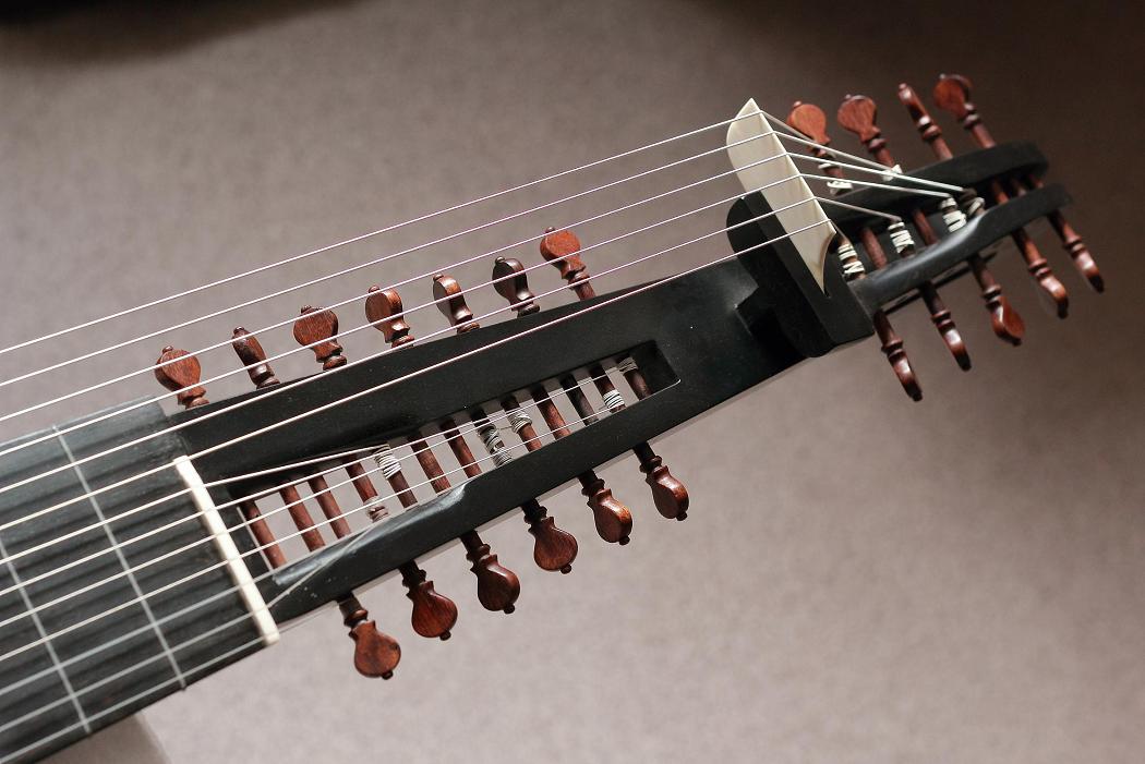

You make the pegs yourself? And what have you used for the black? Is it stain or a paint?
Dominic

Allen wrote:You make the pegs yourself? And what have you used for the black? Is it stain or a paint?
I bought pegs...For one, this project only.
For necks - dye, then a NC lacquer (not glossy)

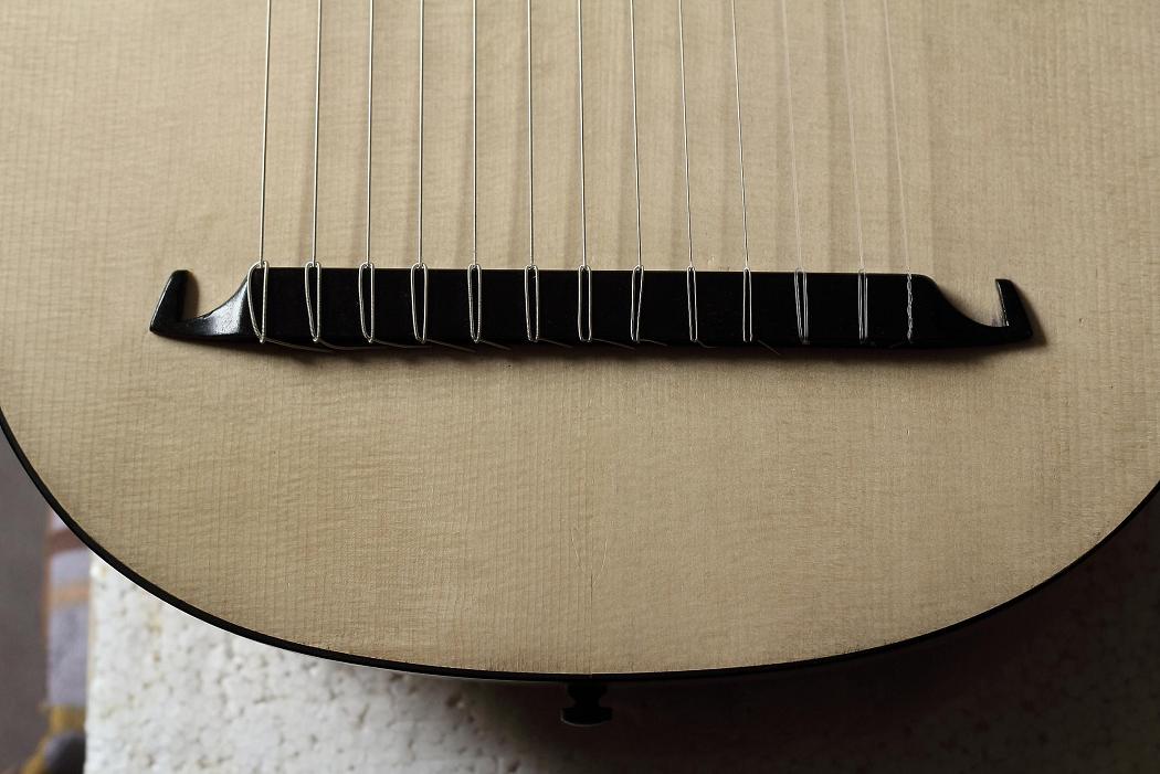

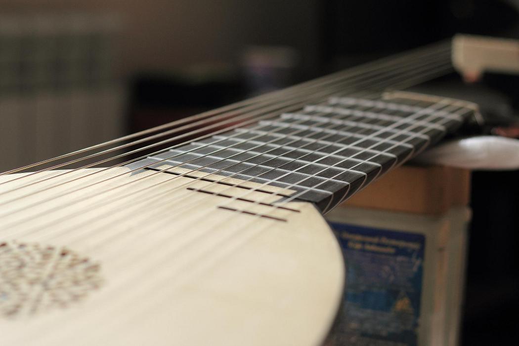

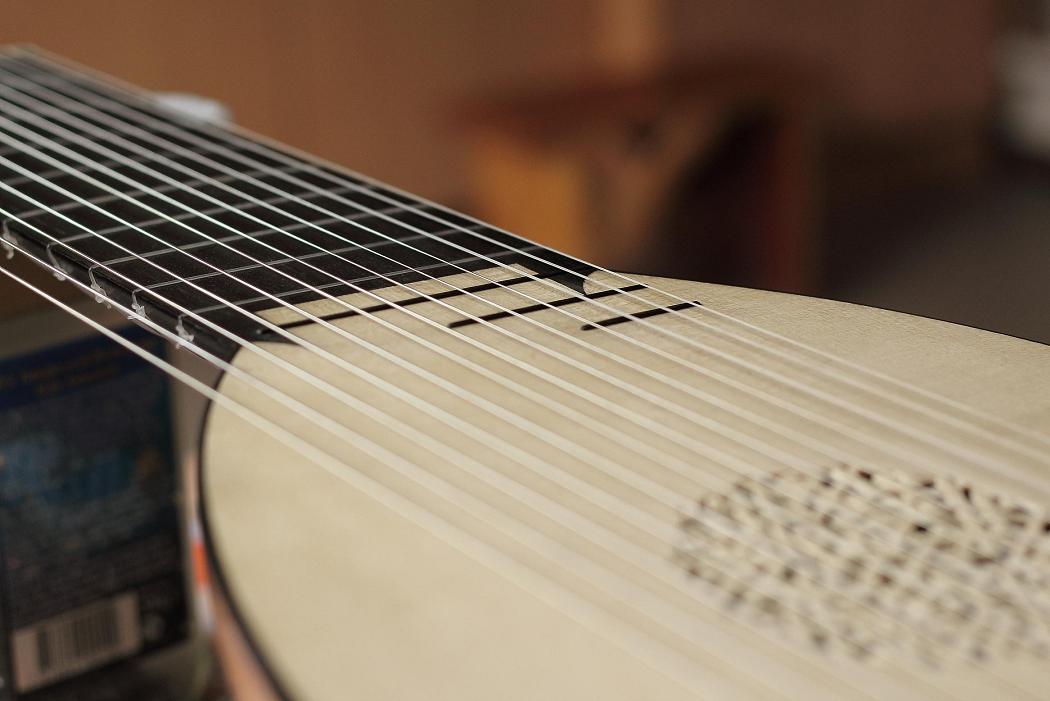

I had almost completed.
It remains to add the octave strings.
Sound great , archlute sings! (I thought it would be worse)
Now in my house Renaissance.. :D
Thanks all to whom this theme was interesting! Maybe it's someone inspired. :wink:
