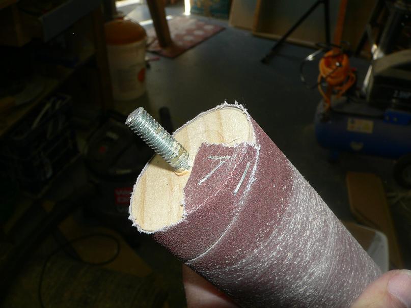

That's what I've done on my little drill press sander:
Spiralled on the cloth backed abrasive, (cut from a suitable sized belt sander). Ends taper to a point with the spiral. Secured with a staple right in the tip of the point, straight into the wooden drum. Tightly wound and same in the other end point. Staples then punched down below the level of the abrasive.
Working so far.

Like this:Alastair wrote:That's what I've done on my little drill press sander:

Paul, I would think it would depend how tight you spiral it on under tension. Also at that length, temperature and stretch might become an issue.pavliku wrote:Thanks for the pic Alastair - do you think that arrangement will work on a larger scale? (480mm, 110mm diameter)

With the first loading, I also sprayed the drum and cloth back with an aerosol contact adhesive......... not saturated, just tacky. I did not have any movement on my small drum, and it peeled off without drama when I removed it. Second time around, with a stiffer belt, I did not bother, and to date no sign of movement.
That said, yours is a lot bigger....
Alastair

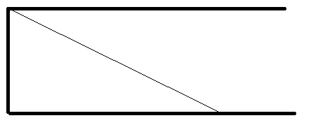

I also put paper on in spiral fashion. Just in case you are not sure how to cut it, wrap a bit of string around the drum to get the circumference, then lay it on the sandpaper in following fashion to get the cut angle/line.
