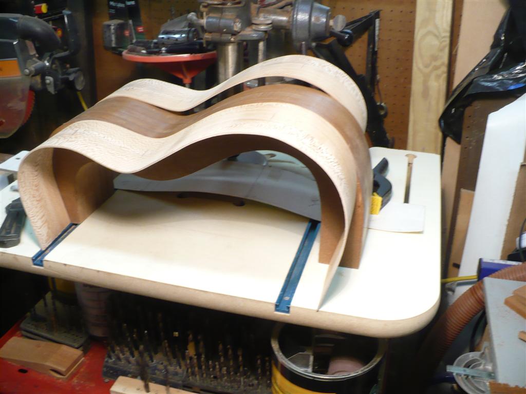

I was bending Northern Silky Oak sides for the current build. I had thinned them down to 2mm before starting.
Soaked the sides in a hot bath for about 30 min before bending, and probably did not have the pipe as hot as it should have been. The sides bent slowly, but with no tendency to fold or crack. However, they seemed to suffer strongly from spring back, and after I had repeatedly tried to push the bend further, only to have it go back after a few minutes, I gave up, intending to have another bash later, after they had dried out.
Lo and behold, when I came into my sun-warmed shed next morning, they had NOT sprung back; they had in fact increased the bend as they dried, even to the extent I’ll have to do a bit of straightening to get back to the template.
Any ideas?

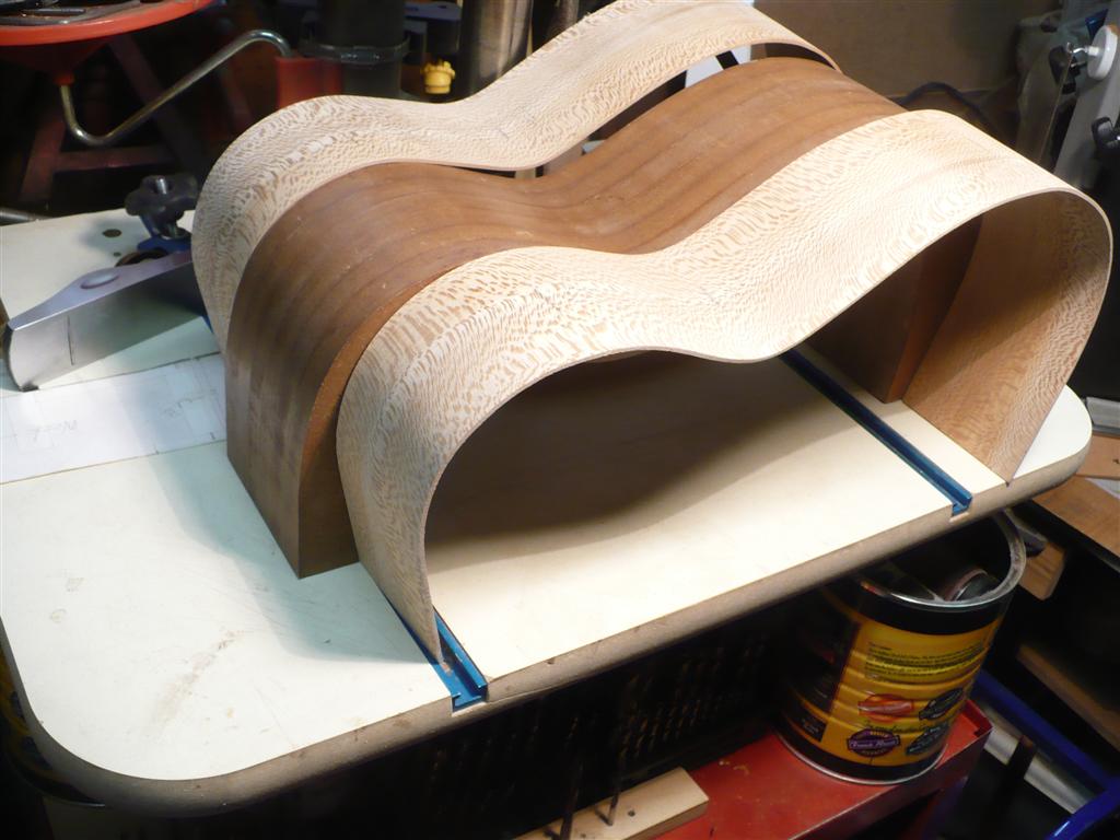

Here are the sides after drying:
Off the pipe, the ends of the lower bout were at 45deg to the centreline

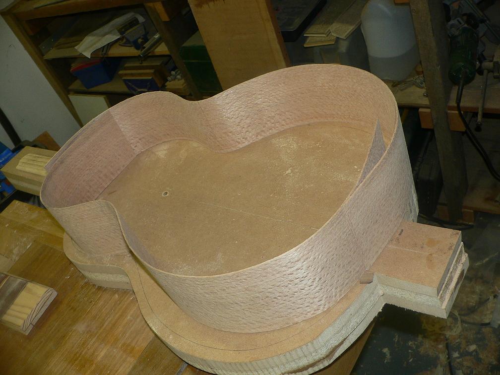

Re: Side bending question
Looks like lower bout on side nearest to camera has a sharp bend in it.....or maybe thats just the camera angle. You could try reworking it on the bender. The sides will often not quite cross the centre line at 90 degrees but dont forget you'll have a tail block in there to anchor the butt end of the sides to and then youll have supports on outside of the sides...Im assuming youre building spanish method here.
In summary I wouldnt worry about the butt ends of the sides but id probably work on the sharp bend in the side nearest camera....bearing in mind that Im completely anal when it comes to things like this.
Hi Martin,
A combination of both;
There IS a sharper bend there, but it's nowhere near as obvious as it appears to be in the pic. I'll have no problem just relaxing it out when I get to refining the sides to the outline before glueing.

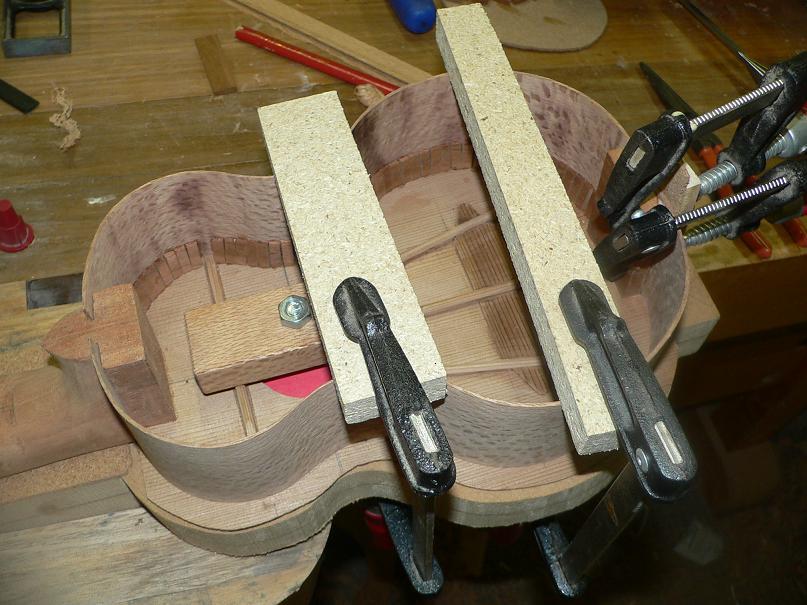

Building Spanish method, but without an outside mould. I'll get the sides close, and then clamp down like this:
but with more bars for the guitar, and tweak the sides to the template line. Using tentellones, so no glueing rush.
