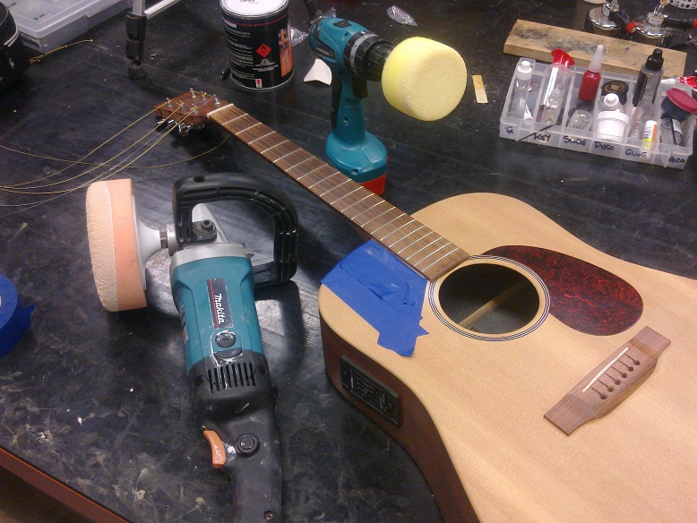

Just finished a neck reset, and had the two types of buffers and pads we are discussing here, so I popped of a photo
Both do an okay job
Both do an okay job

Just to add a couple of points re the pads mentioned and shown above. They are colour coded and available in soft, medium and hard and i wouldn't think you should need a hard pad if the finish on the guitar guitar is anything like the one in the photo above, I would aim for a soft one.
Personally I would apply/spread the polish/compound with a cloth or 'muneca' style of rag rather than using the machine to spread it so the surface is more evenly covered, always in a circular motion and always lengthways where possible (same rule for sanding and spraying so swirls arent crossed etc).
Keep the machine moving at all times (and take care near edges where varnishes and painted finishes can be at their thinnest) also lenghthways and with the grain (things can get hot underfoot) and wear safety glasses.
Make sure any compound (used for cutting) or polish (with no cutting ability) is machine compatible and probably no more than fine or ultra fine would be the choice of most people here on this forum due to the quality of the work pre buff/polish stage.

In case of some misunderstanding, I am certainly not advocating using 'too much' polish Allen. Certainly no more than we see you using in this image.
My last point was meant to be taken in context with the previous post above it and remains that during application, 'I' find leaving enough product to form a decreasing lip at the leading edge of the foam buff provides me with a visual aid that helps maintain an even pressure on the leading edge of the foam, and therefore, an even distribution of polish across the work surface.
