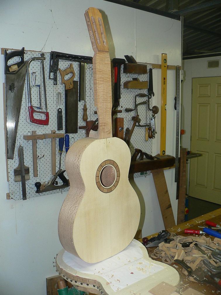

Starting to look like something now, but a long way to go.

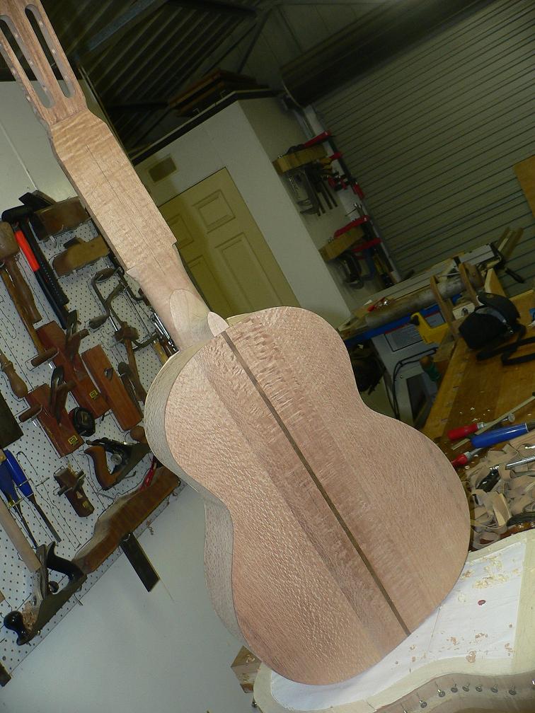

However, I now have another concern. When I inlaid the imbuia backstripe, the back took on a reverse bow along the line of the inlay. In my inexperience, I assumed this was normal, and would come out once braced and the box closed. However, this has not been completely correct. It is fine at the braces, and for most of the back, the hollow is minor, and will scrape/sand out. Between the tailblock and the lower bout brace, however, there is a dimple of 1/2 to 1 mm, which I don't think will be correctable. My intended (and preferred) gloss FP finish will make this glaringly obvious, so I'm considering changeing to either a matt shellac, or else sprayed satin cat lacquer instead.
I was wondering what the thoughts would be on this?

I had one classical lose the doming in it's back. I ended up replacing the whole back and using a cross brace for the lower bout to provide better support for the back than conventional transverse braces. What thickness is your back? if the back is a bit on the thin side then chances of collapse are higher.Alastair wrote:
The dimple you talk about...it's not a result of the top of the butt block being flat is it? With a flat topped butt block the back profile has to change abruptly from flat over the block to arched over the rest of the back. Just a thought.
Re: Stability of Spanish Heel
I'm trying to invasion what you are talking about, and pardon me if I got this wrong. You inlaid a strip into the back (not butting up the book match to a centre strip).
If this is the case then I've seen it happen where the back strip ends up pulling the joint together just a tiny bit and you end up with what you are describing. I've found that by using some purling on either side of the hardwood inlay helps alleviate this. My thinking is that the purling (soft wood or fibre) has some give in it so when everything dries the purling gives just enough.
That's my thoughts on it. As far as a fix....don't know. Go satin me thinks.

Thanks guys,
Martin, no not from the tailblock. I was careful to angle it to match the arch along the length of the back. Also, the "dimple" is (slightly) visible all along the back centre, except where the braces run, just that it's only a bee's dick except in the bit near the tailblblock.
Allen, I think you've got it dead right. I just thought that it would correct when braced and attached. Hindsight is wonderful innit? I'll try scraping and sanding, and see how much I can achieve. If not........satin, but will be a pity.

Allen wrote:I've seen it happen where the back strip ends up pulling the joint together just a tiny bit and you end up with what you are describing. I've found that by using some purling on either side of the hardwood inlay helps alleviate this. My thinking is that the purling (soft wood or fibre) has some give in it so when everything dries the purling gives just enough.
Hi Allen,
Been mulling this over last night. Makes sense to me. Had the following idea:
Inlay is less than 1mm thick, (so less than half the back thickness), and is in the middle of a 3-piece back, (so no glue join underneath).
I'm considering cutting carefully along the margin of the inlay, with a craft knife and straightedge, down to the inlay level, to free up the "pull". I believe this will dramatically reduce the extent of the problem, (hopefully to the point where the discontinuity can be scraped/sanded out.
Fill the cuts/grooves with black epoxy, and sand back after?

To clarify...you routed a channel in middle of three piece back and then inlayed the back strip?Alastair wrote:
Exactly correct Martin,
I didn't like the idea of 2x backstrips, and felt that I needed the contrast to define symmetry, and tie in with the bindings.

The one time I had this happen to me I fixed it by setting up a fence very carefully so that I could use my laminate trimmer and a fine bit that matched some purlfling I had. Measured at least 1/2 dozen times and then committed to the cut....on each side of the inlay. Pushed the purlfling in and flooded with thin CA. It worked but there was an awful lot of sweating going on.
I don't recommend this. Just putting it up there as an option if you're dead keen.
I generally take a totally anal back to the start approach to such problems. I'd carefully rout out the inlay (tricky close to the neck) and glue in a new strip....with purfs either side as suggested by Allen. I'd use epoxy glue rather than AR to minimise risk of inlay swelling. Ive done this on a free plate back but havent done it on a back fitted to a guitar.
Thanks for the advice, Martin and Allen,
What I have done, is as above. I scribed along the junction on both sides of the inlay, down about 1mm. Initially no significant change, but after I wet the centre down, (it got worse)!, and then let it dry, it has come right back to a dome, all except right at the tailblock, which has come back to flat.
I then wicked CA into the scribed cuts, and after scraping and sanding back, it has come good. Busy doing the binding now.
thanks again, an unexpected Xmas present to offset last weeks stress.
