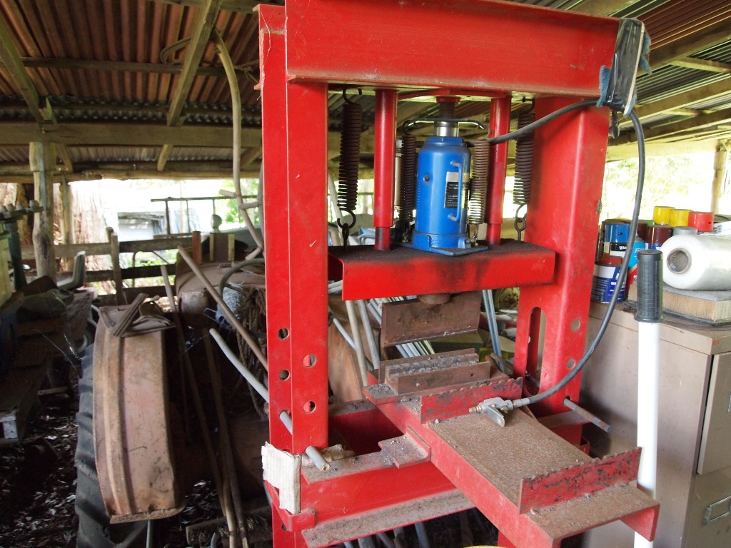

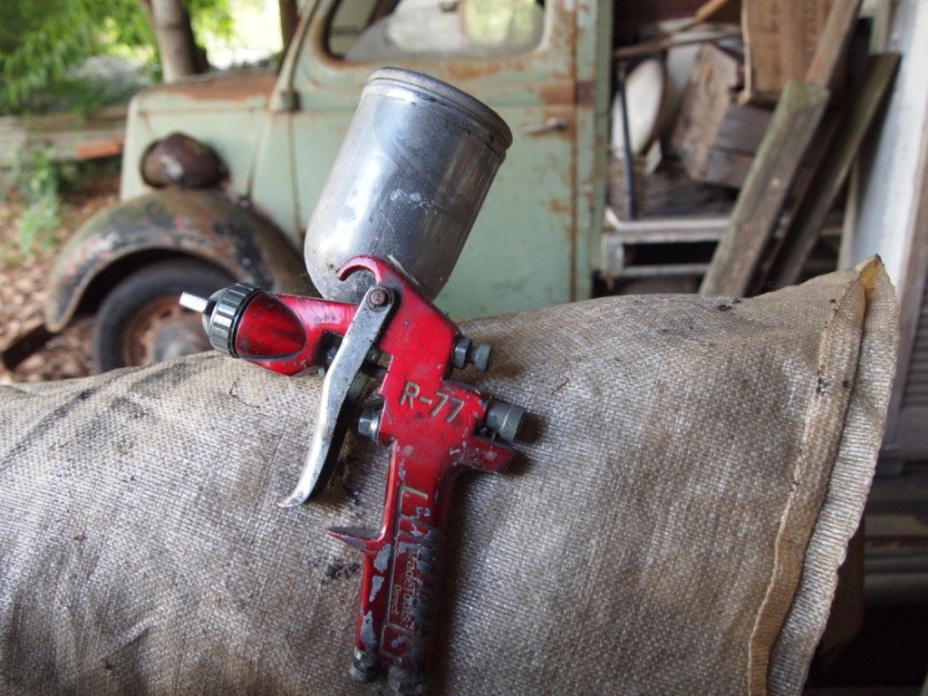

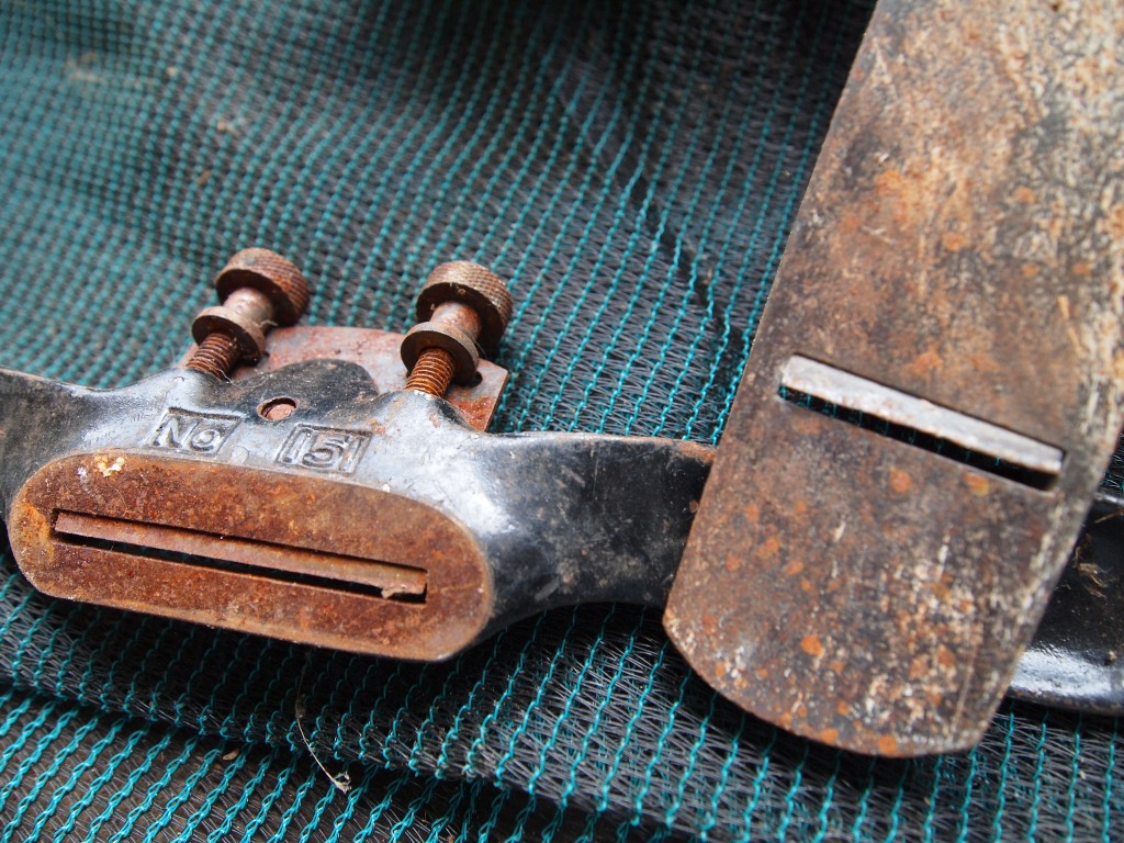

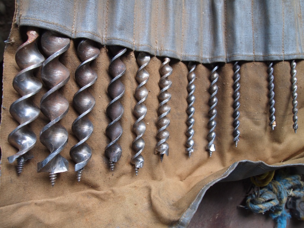

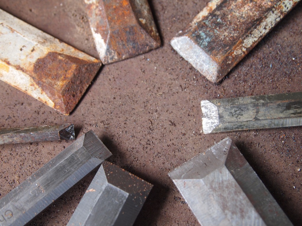

Some more pics.

Cool lookin' Fret Press! :shock:

will probably cut the neck in half

jeffhigh wrote:will probably cut the neck in half
Yeah, it probably would. It is a metal bender powered by a compressor so it would probably crush the neck in an instant.
Thought it may be usefull for clamping or something.
