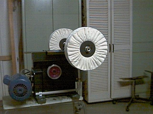

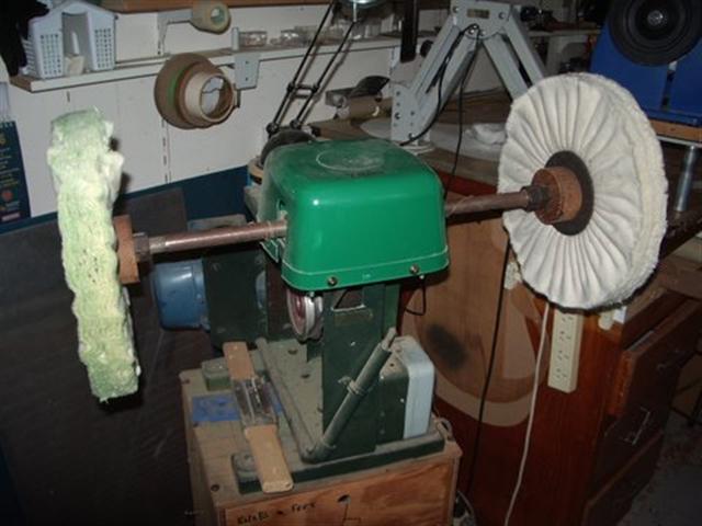

Hi Leigh, I built mine maybe 10-12 years ago and used 6" grinding discs as shown.
IMGP4694 (Small).JPG (46.26 KiB) Viewed 7748 times
Jam031 (Small).jpg (43.56 KiB) Viewed 7748 times

Taffy Evans wrote:Hi Leigh, I built mine maybe 10-12 years ago and used 6" grinding discs as shown.
Thanks Taff - that gives me an option. I had a local engineering firm quote me to make 2 pair - $800.

I would go with Taffy's option...the disk are rated far above the rpm a buff would ever need to go.

Yes that was my thoughts Kim. I also use double the thickness mops and they [the discs] also do the job, and have done all this time, the dished side of the disc fits into the flange/boss of the mop like a bum in a bucket.
