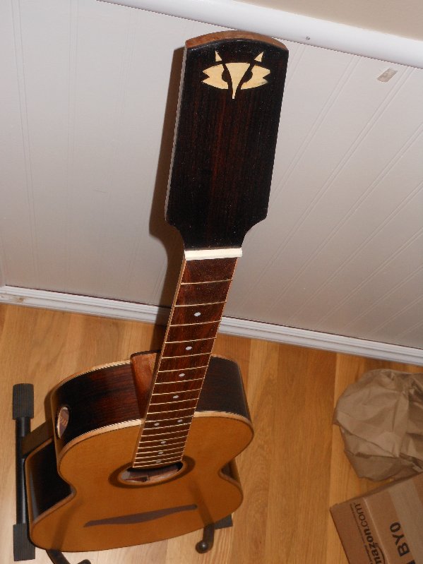

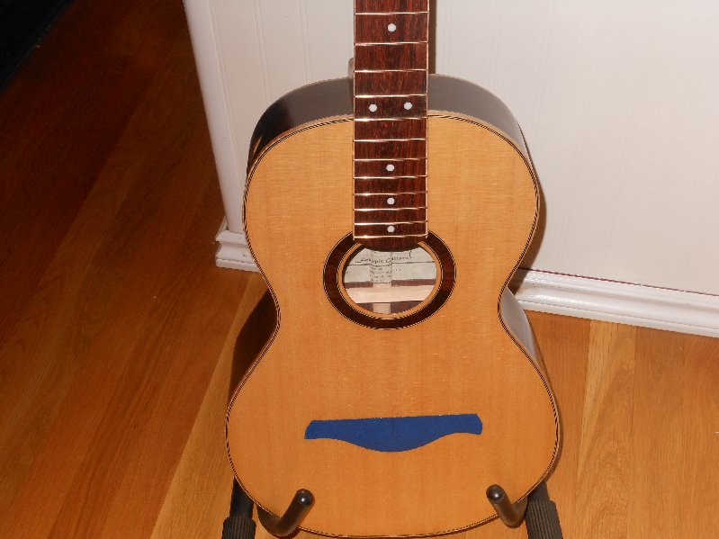

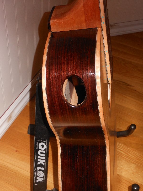

Hi Folks,
I am making a parlor guitar for my grandson, and it is getting down to the final few steps. I decided to try using tru-oil to finish this one, and so far it is working out much better than my previous two efforts. Both of them were unsuccessful french polish jobs.
I have 25 coats on the guitar, and I was planning to buff it out after letting it harden for a couple weeks. But it is so darn *shiney* now, I am wondering if buffing is necessary. If I just level it, then spread a wash coat (50% naptha) and leave it at that, would that be good enough?
Here are some photos, so you know what it looks like now:
Thanks!
--Paul

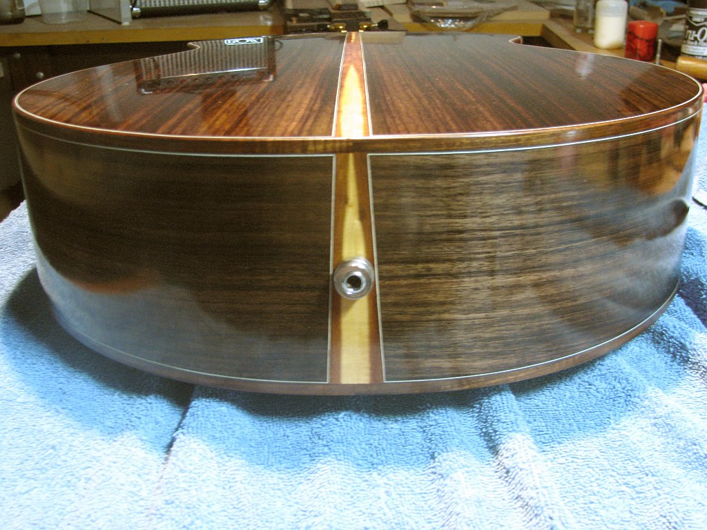

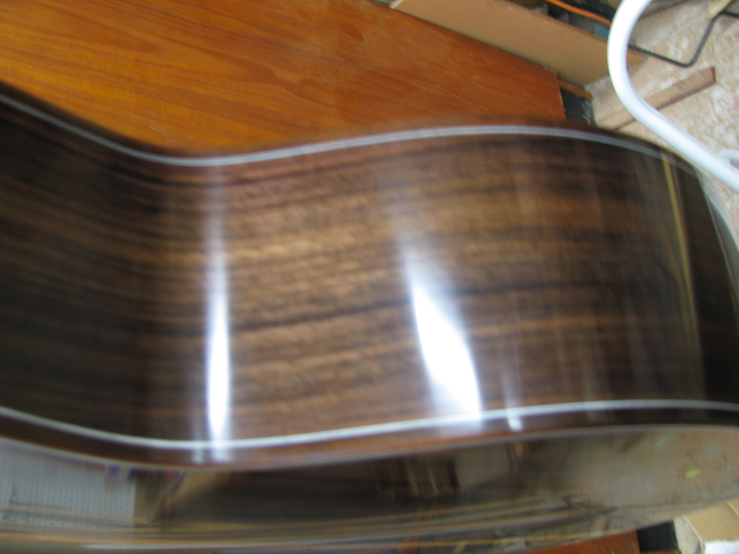

I achieved good results with Truoil by using a burnishing method. i.e. Carefully prep the surface of the wood out to 2000 grit before anything is applied (the wood itself will have a sheen by then). Then apply a 'thin' coat of Truoil over a selected work area e.g. back or one of the sides etc, and use a paper towel to take off 'all' the excess Truoil that you can. Now start working the tacky surface fast and hard with a clean cloth to burnish off all of the product that you can..you want to build up friction heat when doing this. Change to a clean bit of cloth when the tackiness reduces and go again until there is little resistance. Leave that panel and move to the next as long as you are not placing a freshly worked panel face down on the bench. Let that set up for a few hours (if your doing it right, your arm will need at least that long to recover
) and then repeat until you achieve the gloss level your after.
No need to buff, just apply silicone free wax and buff that and then maintain the surface with periodic applications of wax.
Excuse the image quality, 'old' camera, bad light, an no tripod but you get 'some' idea of the gloss level..from memory the first image was taken during process as a demo after the first 2 or 3 coats.
The only problem I have encountered with a Truoil finish was the direct result of epoxy amine blush cause by poor a understanding of that phenomenon. The blush only occurred on those areas which had large pores and retained the most epoxy...the effect of the blush was to reverse the polymerisation process in those areas which made them go dull and tacky after just a few weeks. Later, those same areas formed into peaks which hardened off, or crystallised to leave a dull rough brittle surface...my advice remains that unless you fully understand what epoxy amine blush is and how to avoid it, to never use epoxy as a pore filler if you intend to use Truoil, or any other product that hardens through a process of polymerisation of driers, such as Tung Oil, or any traditional oil based varnish.
(EDIT) Just looking at the OLF and someone posted the following thread..The TO slurry method seems a really good option to pore fill for this finish...

Re: Tru-Oil finish advice
Thanks guys!
Kim -- absolutely beautiful work. I should have asked this question at the outset. Because I used zpoxy. Way too late to avoid the amine blush. Live and learn.
What I think I'll do is mix Rob and Waddy's advice. Put a wash coat on, sand it out with micromesh, then put a beezwax coat on.
I'll post some pics in the gallery when it's done.

Don't panic yet Paul, epoxy amine blush is triggered by the proper combination of temperature + moisture in the air + ppm of Co2 in the atmosphere during mixing, application, and curing. If you applied the epoxy in a well ventilated area when humidity was not too high (in the morning with a rising temp is better than :pm ) then you may be OK...but you really cannot know if there will be a problem or not for the next few months. To give you some idea, the guitar in the above images looked fine for about 6 weeks and then 'gradually', dull patches began to appear. Nothing major, just a little dull and they would not polish out. Then over time they spread, some merging in to each other and they became more pronounced until they felt like sandpaper..Paul Eisenbrey wrote:Thanks guys!
--Paul
Take a look at the link edited into my last post...check out what user "Quarter" has to say about TO...he's getting spectacular results.
http://www.thegearpage.net/board/showth ... p?t=711780

We don't see enough of your work Kim.
Really, nice looking Kim.
I think it's the first build of your I have seen.

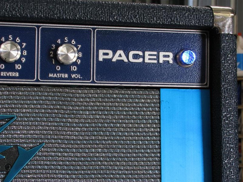

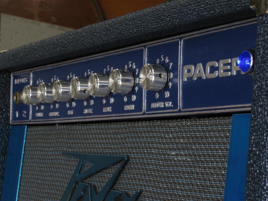

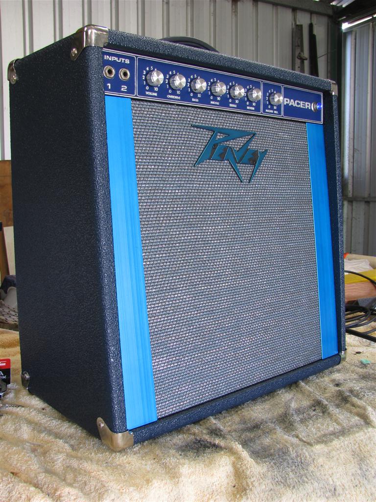

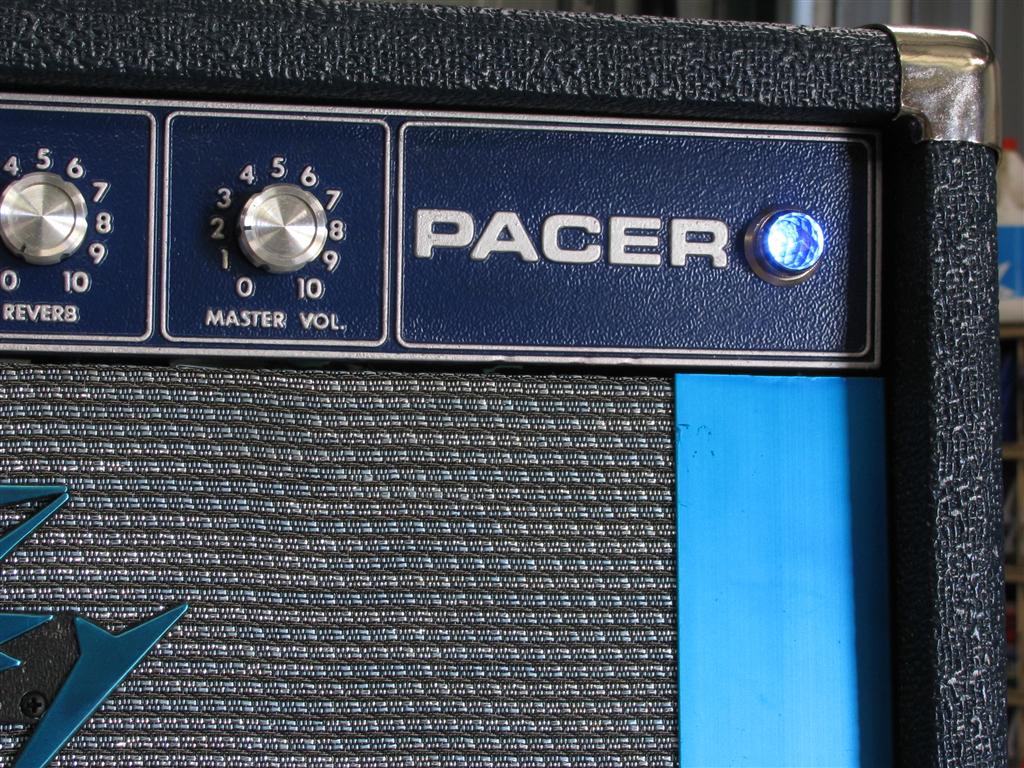

No one has for a while Bill...I've been hijacked!!!P Bill wrote:We don't see enough of your work Kim.

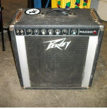

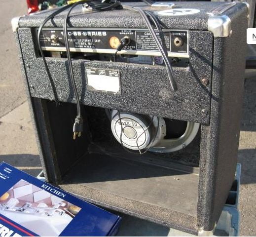

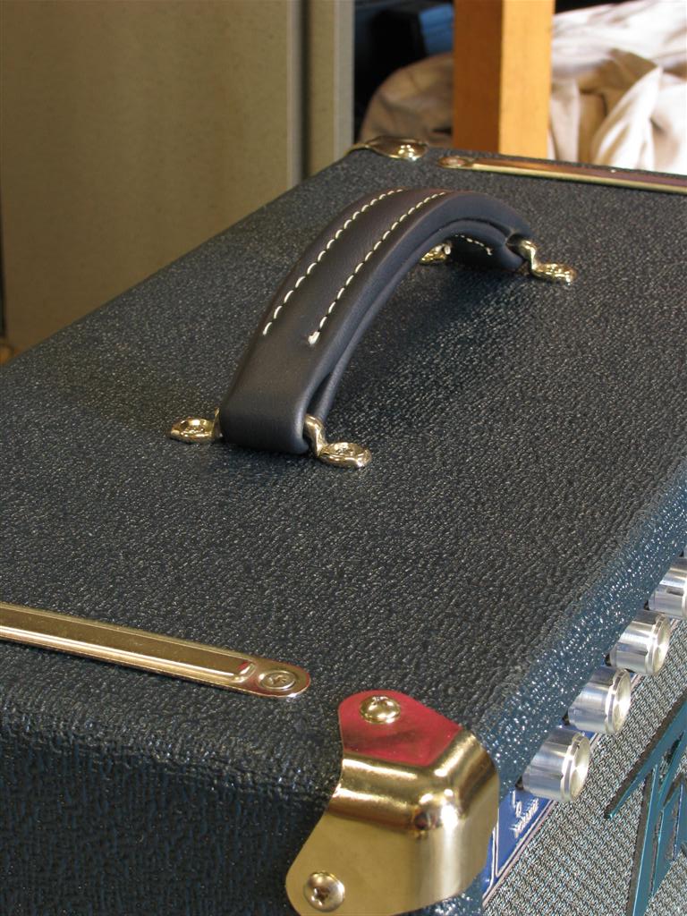

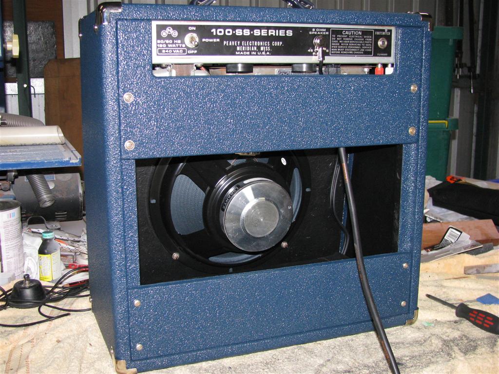

'Honey do' can be an awful demanding thing in an old weatherboard home and with two teenage girls both of whom sing and play better than I these days, I've been relegated 'guitar tech to the stars' and that can keep a bloke pretty time free..... but the pay is really good for the sole
I also get side tracked
I did not take any before shots but here's a few of the same amp in similar condition I scrounged from the net..
Mine was probably in a bit worse nic than the one above with the speaker cloth more torn and the cabinet hardware properly rusted...so the girls had a point I suppose. So I ventured off to learn more about electronics and fixed all the "issues daddy", and then worked out a way to 'properly' dye tolex so the colour would go 'into' the material and not scratch off like paint does or some of the 'so called' dyes will when bumped into door ways and things as one is incline to do when lugging around an amp. Getting that sorted allowed me to fix both the "its so bloody ugly daddy" and the "can't you make it a blue one daddy??" complaints at the same time.
I probably should do a thread on the whole process rather than hijack this one but this is what I came up with...the image of the back best shows the colour change...painting the fascia was a complete bastard too, ended up doing it by hand
Sounds great now too because I replaced all the electrolytic caps, stripped, cleaned and refurbished the pots, fitted a new reverb tank, full 17" down the bottom of the cab instead of the pissy 8" under the chassis as per original. Biggest single improvement in sound though came when I replaced the original Peavey/Eminence PA voiced speaker with a 50watt aussie made Lorantz greenback clone....sounds very valveish now and with the volume up, and master down, it distorts nicely without bursting ear drums...Speaking of drums, it also has the output to cut through pretty much anything..not surprising because from what I understand these old USA made Peavey SS's shared the same preamp circuitry from 45 to 400watts..I was fortunate enough to have John Madison drop in during a trip up from Albany last week, he can probably vouch for the output.
Best of all, whenever the girls plug in these days I get.."oooowww its soooo cooool daddy" and "thank you daddy xxx"...like I said, the pays pretty great...the neighbours are not so impressed though..
Thank you Daddy!!

Question for Kim - Can you tell me how you did your rubbed oil finish on the top? Did you mask the bridge area or finish it and scrape it back to wood for gluing the bridge or.... ??
Shane
Shane
Shane, from memory I tapped off the bridge area with a couple of layers of blue masking tape, I use the stuff that is about 50mm wide so a single piece will cover the entire foot print. I then lightly sealed the top with shellac (super blonde waxless) going a bit heavier at the bridge area over the tape so it would firm up the bond at its edge. Once the shellac is well dry..longer is better, I sanded back the whole top well going a little lighter as I neared the tape, it still gets sanded but less so. By the time the top is ready for the TO to be applied there is very little shellac left anywhere but in the grain of the tape.Shane Woonton wrote:Hi there,
Shane
Contrary to what is often assumed 'and' the blurb you will read from Birchwood Casey, I have found that Truoil will 'not' actually penetrate into spruce very far at all...To accurately measure its penetration into those test pieces of spruce I had used prior to putting the finish on that top shown above, I would have need a device graduated in 'um'..the only thing I have that's anything like that is an old dial indicator which is graduated in ants dicks, and they are 'way' too big.
